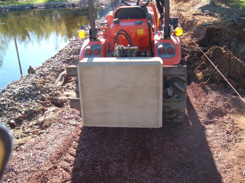

/ Too much ballast? #9
I couldn't load your picture for some reason, but here is what I came up with for rear weight. It's only about 400lbs but it is easily picked up or dropped off. Concrete is about 150lbs per cubic foot. I just cast a piece of channel in the form when i poured it with enough gap to mimic the lip on a fork. For what its worth it may or may not help in your quest.
Steve

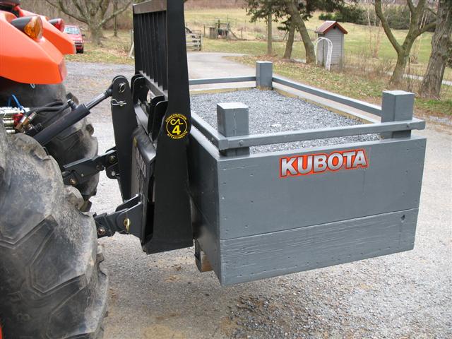

M7040,
It looks like you are using a fork lift arm. Does the load move?

/ Too much ballast? #19
racer, yes the box is on pallet forks mounted to the three point and can be lifted with the three point as well as tilted with the top tilt cylinder. Box is very simple lumber box filled with crushed rocks. Also have now added chain rachet attachment to make sure the box does not slide off
