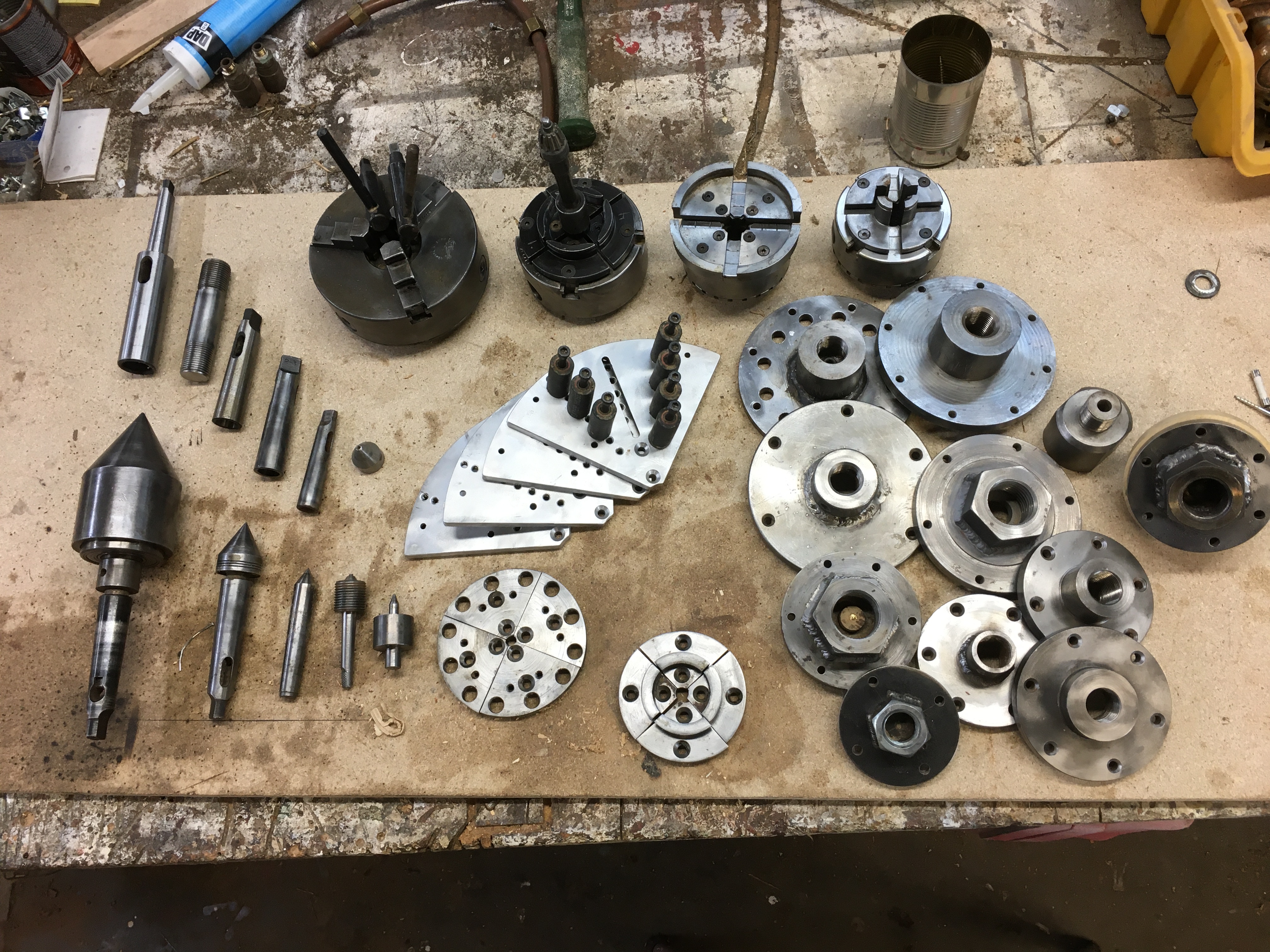

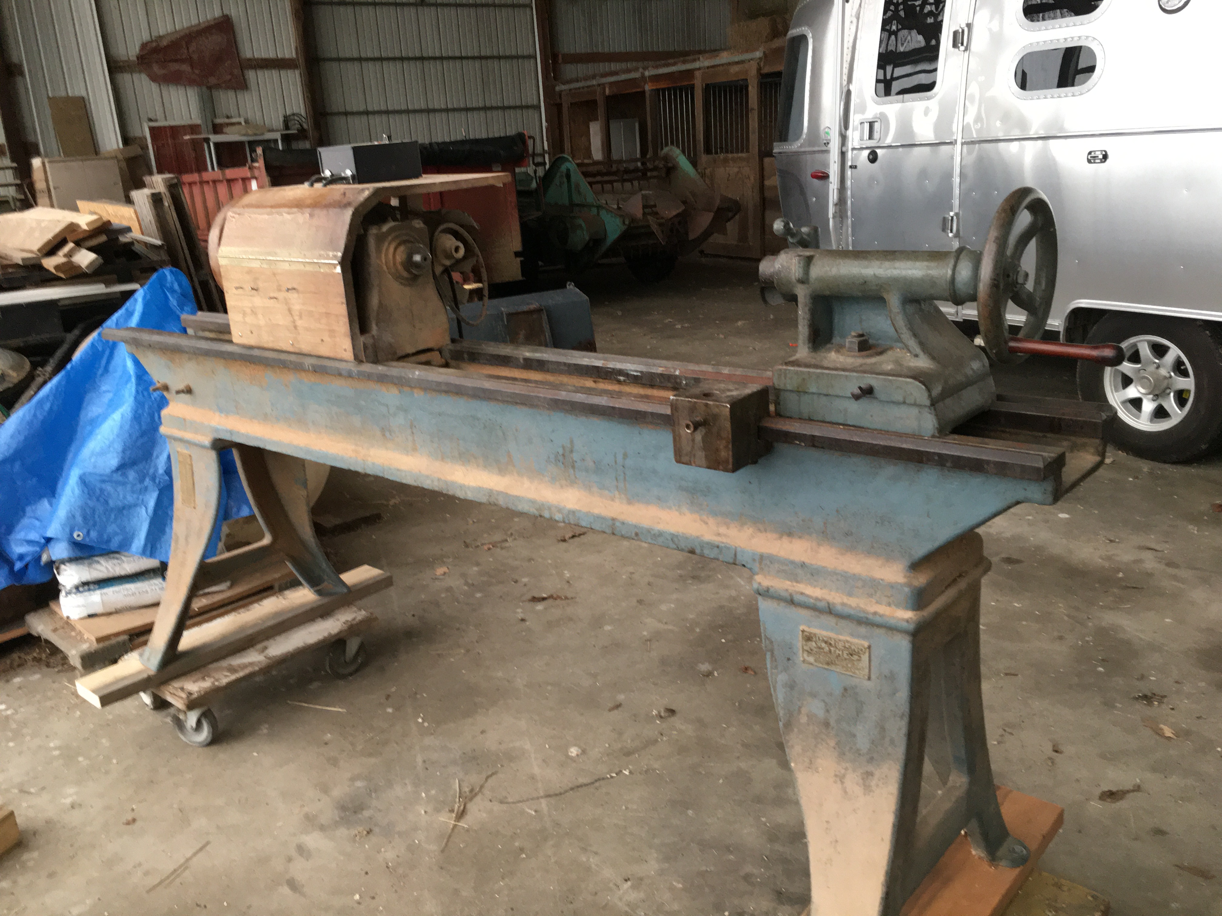

Here is a picture of a recent neighborhood barn find. Eight foot long bed, variable speed DC motor with controller and a box full of accessories. I haven稚 turned wood since high school almost 60 years ago so looking forward to new shop adventures. This machine is branded South Bend but I cannot find any evidence that it was used as a metal working lathe.
Can稚 wait to get it into the shop and restore it. Both the head stock and tail stock spindles are true with no run out and align perfectly.

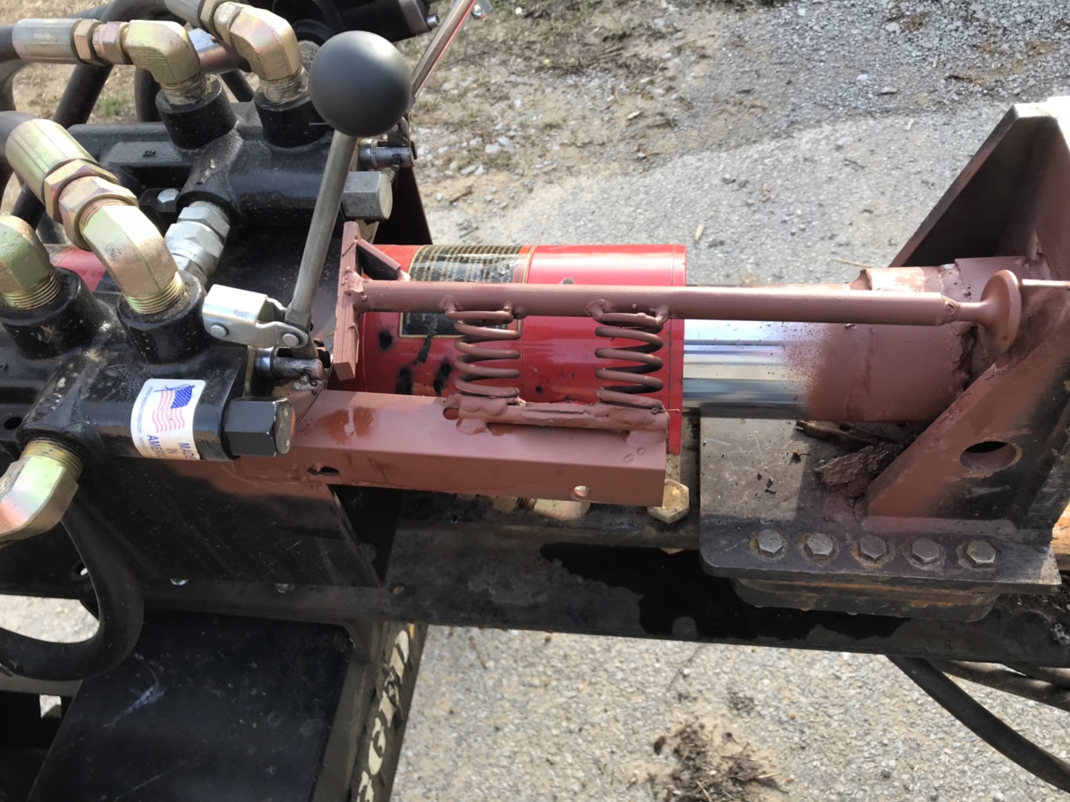

My wood splitter has a 30” stroke and I don’t split 30” wood so I had bolts in the beam flange to stop it short to save time. After a couple years of doing that it broke the end off the cylinder. So after I fixed that I rigged up this contraception to knock the valve back to neutral. IMG_8081.JPG

Thats a cleverly simple way to do that with the spring rather than a slide.

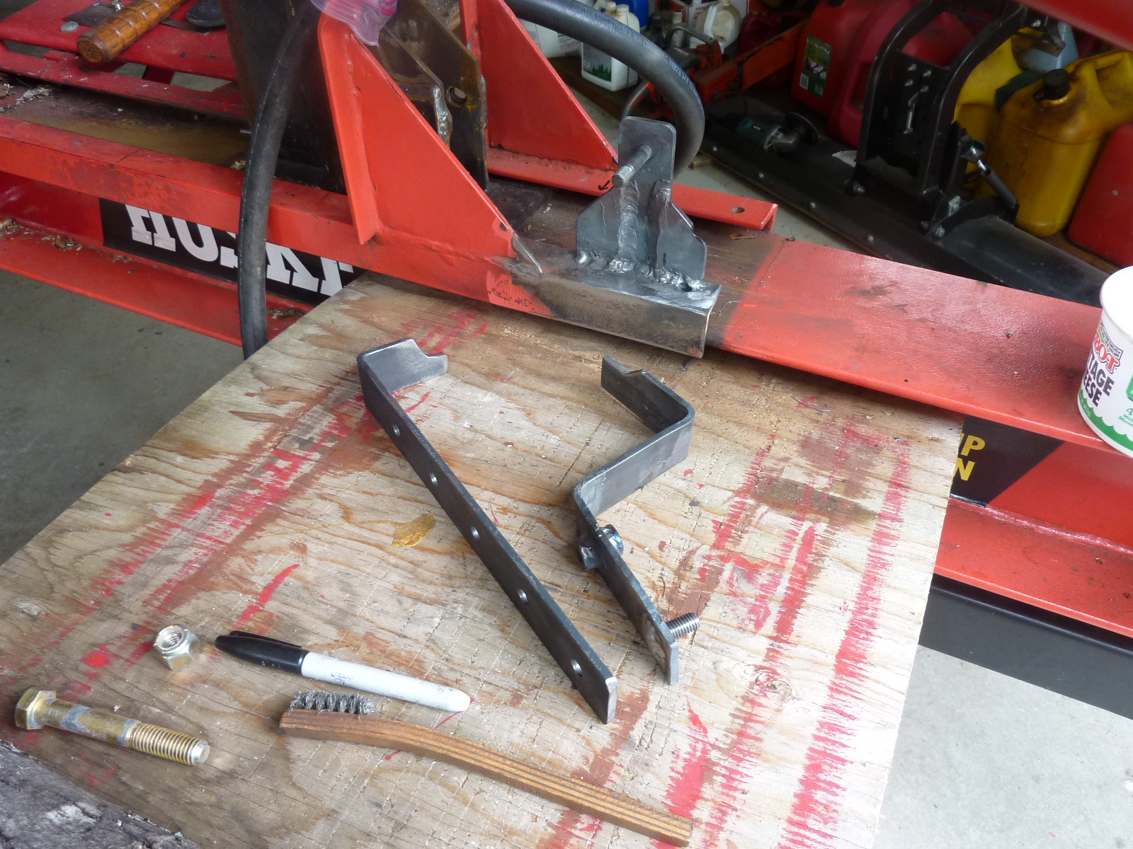

I did the same thing about 6 years ago. Splitter stops at 26" and I split 18" or 16" mostly. So I made a plate stop bolted to the beam. I tore out the wedge bolt holes. Fixed that and made an adjustable lever contraption to throw the the lever to stop. On mine I had to push the lever the opposite direction of the wedge travel so I needed a pivot. Saves a lot of time stopping the splitter in the right place.
SplitterReturnStop - YouTube
gg

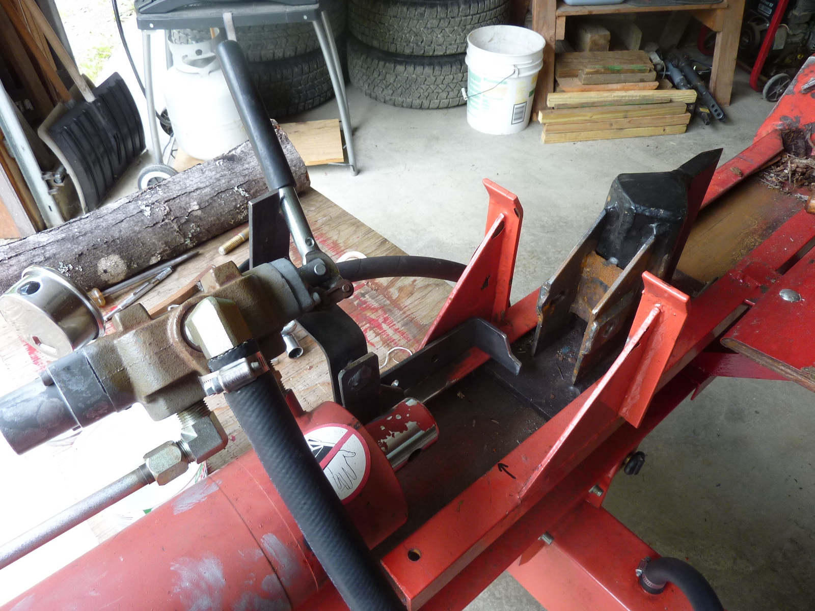

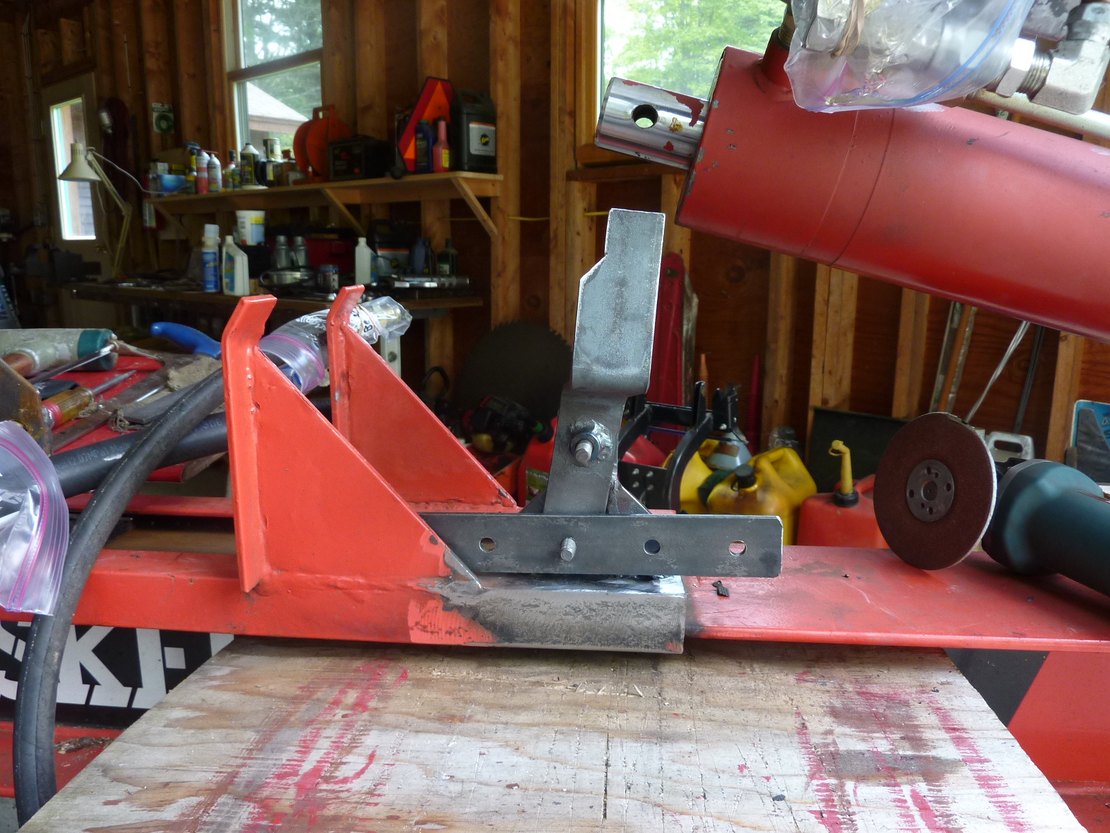

The direction of mine and yours is the same. Mine hits the valve body instead of the handle. But yours is a lot cleaner job than mine.

Oh ya I see - you were smarter than me !!
