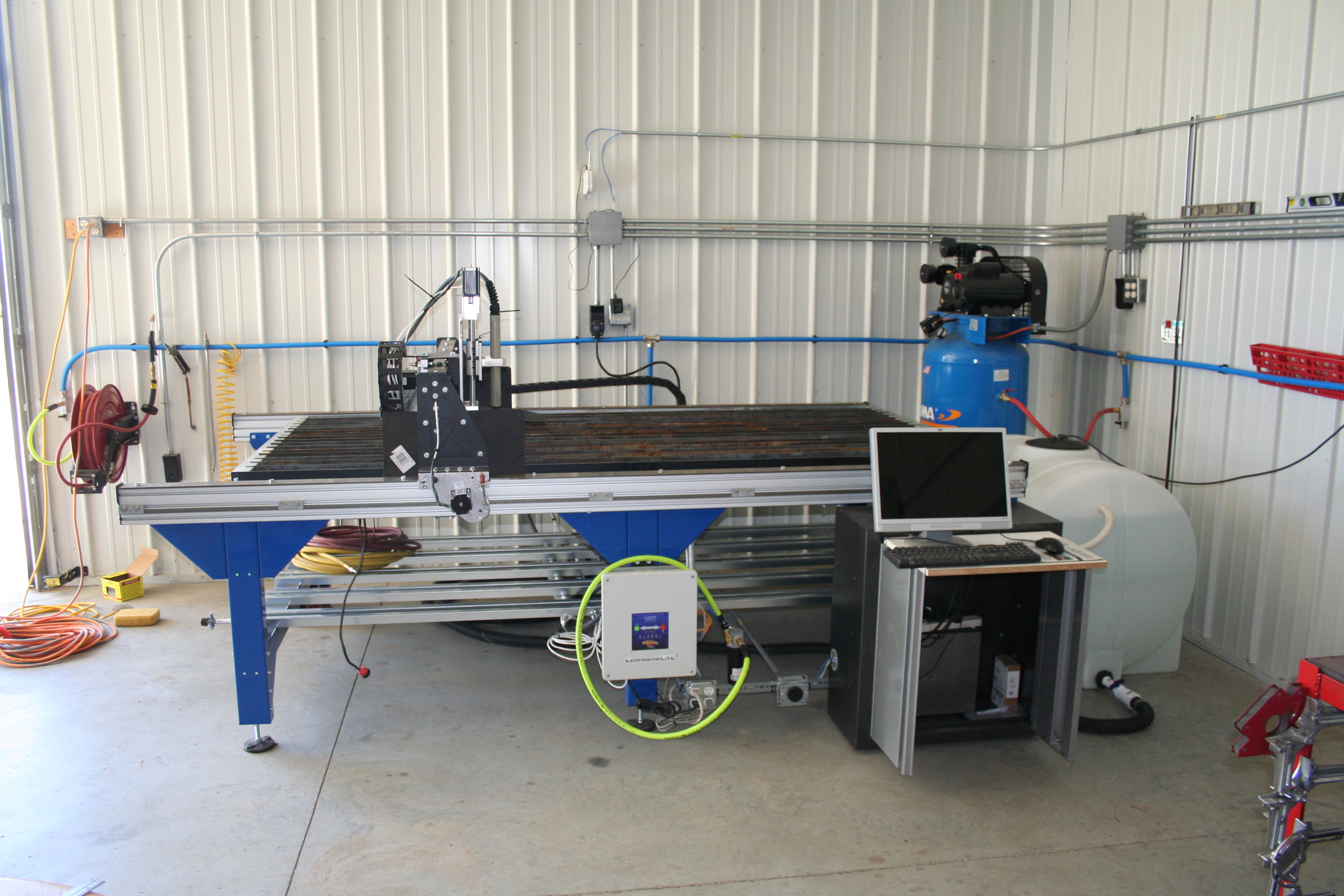

I have not been doing anything as cool as the projects most of you are working on. When I built my barn/shop I wanted it so I could get to all my equipment without having to move anything out of the way. So far this is it.
I have some other stuff on the other side of the barn that I can also just hook up. It all seems simple, but hooking everything up moving it around and out of the way takes a lot of time.

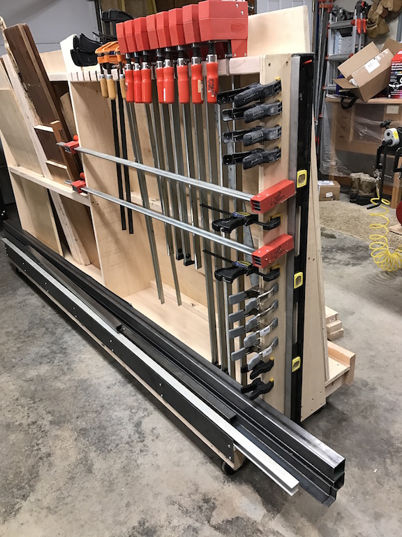

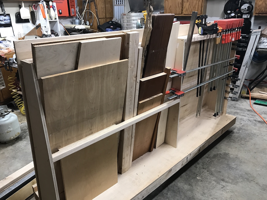

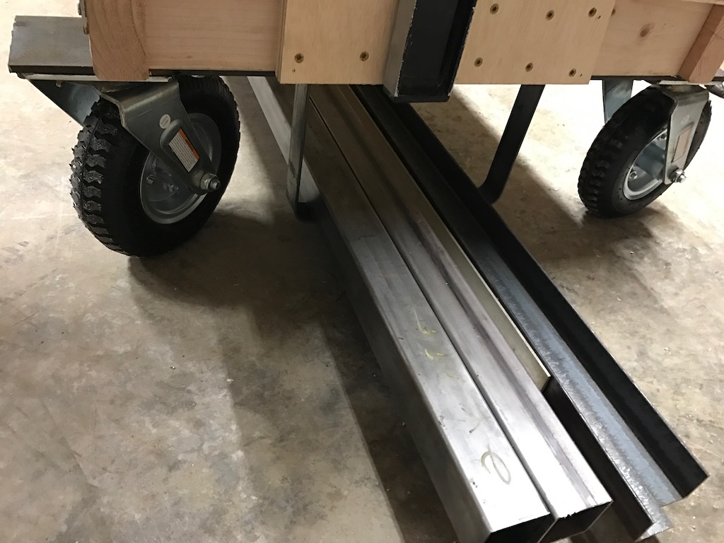

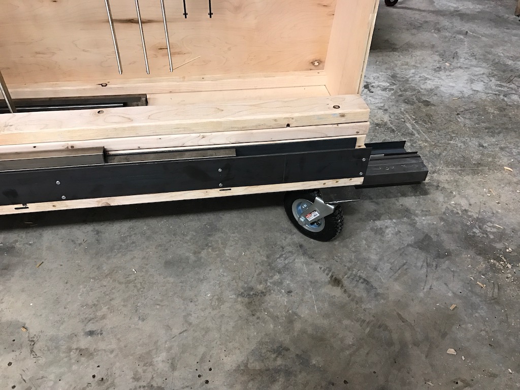

Okay for those of you that saw my material storage cart back in post #56, I finally finished the mod to add larger (8in) pneumatic wheels. I slimed them, welded them to a plate and bolted them to the cart, widened the footprint some and realized I have more storage space underneath due to increased ground clearance, for long metal sections. So I welded up a large U bracket on both ends and now I can store several 10ft tubes, channels, L's etc. I like it!
The wheels work better for rolling over rough ground but they take more to get them to swivel. An improvement but not perfect. The plates extend out a bit now and will allow future mods/additions! Need a remote and power steering. :D
View attachment 492469 View attachment 492470
The wheel work better for rolling over rough ground but they take more to get them to swivel. An improvement but not perfect. Need a remote and power steering. :D
Hmmm.... one of those powered trailer ball movers spark some ideas?
Looks good. Great work and ideas.

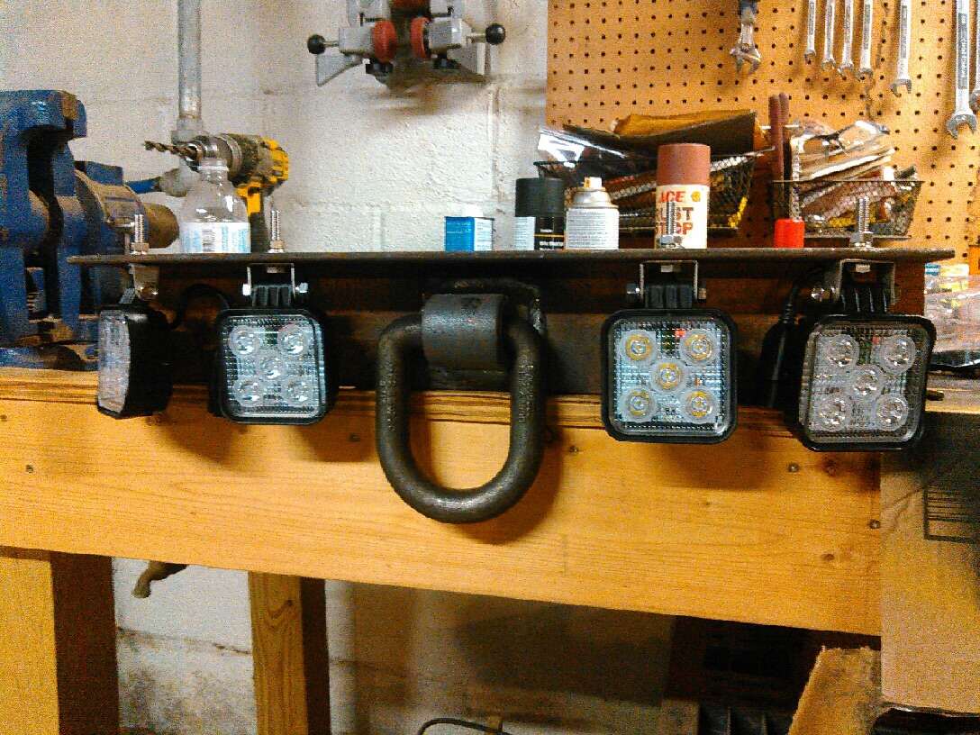

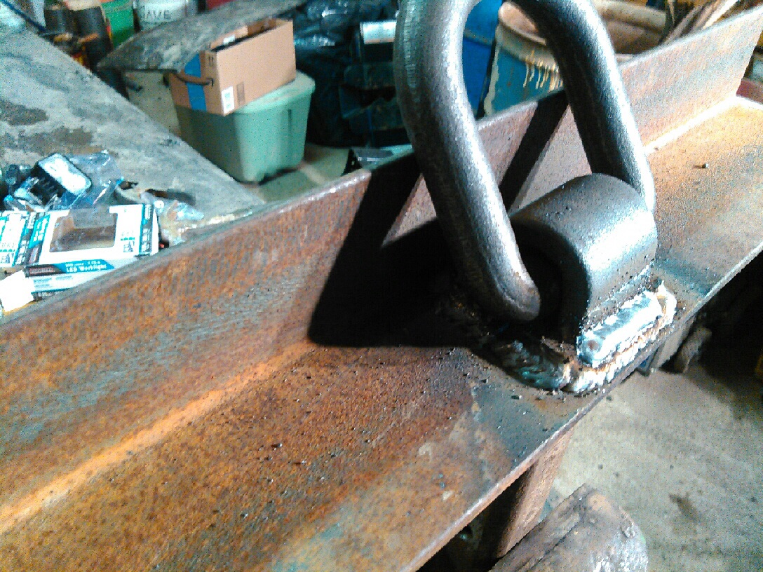

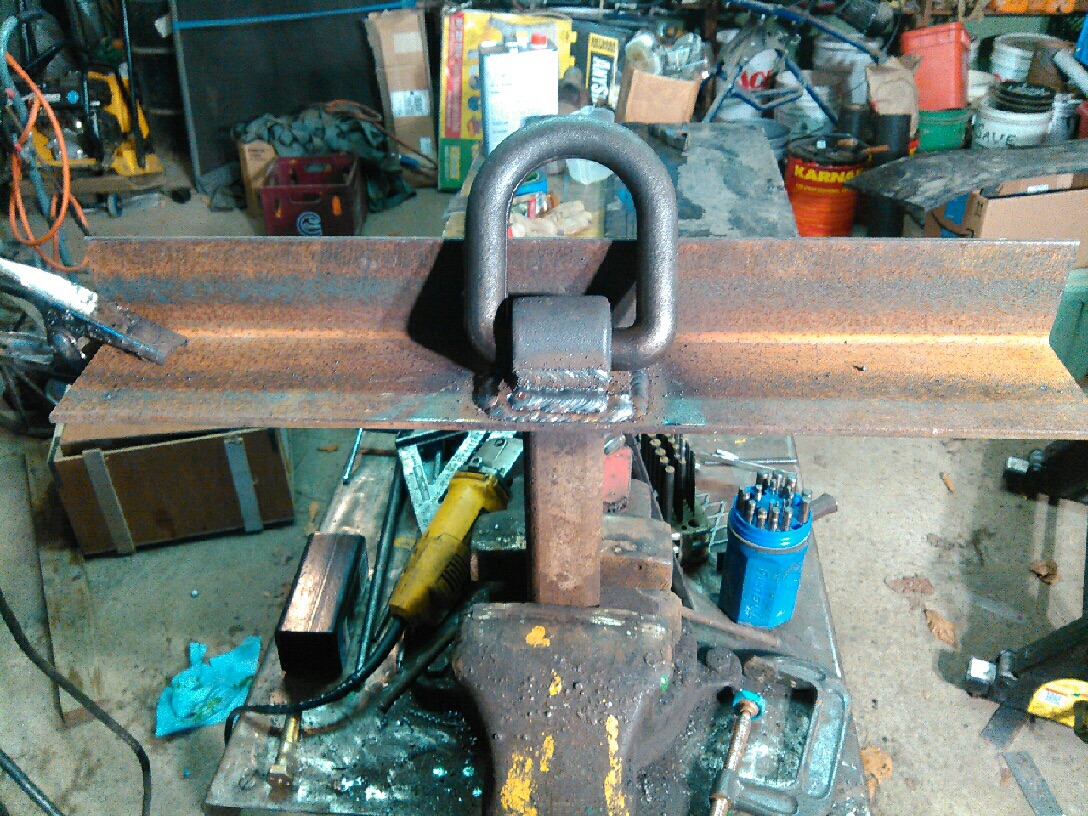

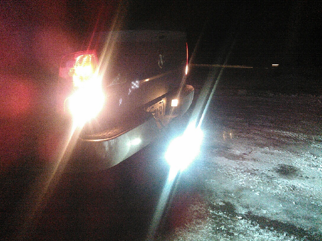

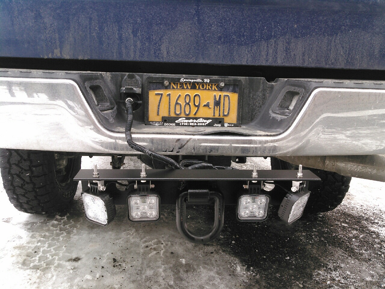

I built a "winter time" hitch for my truck when plowing as I seem to do a lot at night and always needs to pull someone out . I wired the lights into a 7 way plug so they come on whenever I put my truck in reverse .
With my luck I'd have those lights knocked off in a snow bank my first night out. The light is gonna be really nice though! :thumbsup:
/ Todays shop time. #116
nothing worse than trying to back up when you can't see, and Andy you are going to see really well now.
And maybe not back into a mailbox now...as I have. Really nice job. Plug and play.
Necessity is the mother of invention they say

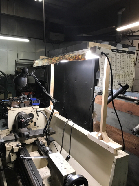

I built and installed a light mount for my lathe. That's been a needed improvement for years.IMG_8967.JPG
/ Todays shop time. #119
I built and installed a light mount for my lathe. That's been a needed improvement for years.View attachment 494694
Funny... I just did something similar... finally strapped an old fluorescent 'trouble' light that I wasn't using to my 20T shop press. I recently built a press brake from Swag Offroad kit and realized I needed better light to see my marks.
