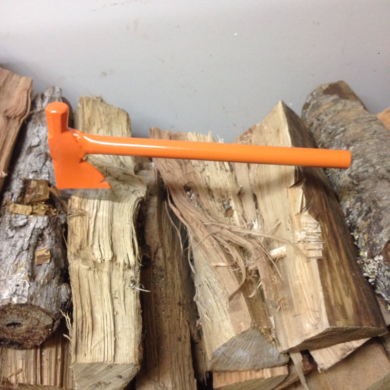

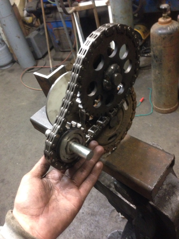

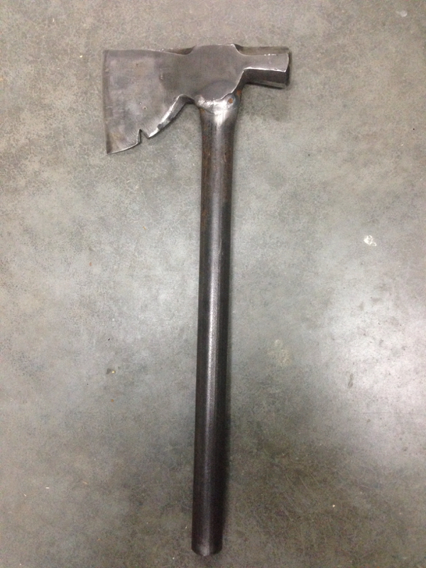

I made the drive gear for the winch, and I "handled" a hatchet. This hatchet suffered from design flaw and the slot in the head was too small. I couldn't keep a wood handle in it. I've always liked that hatchet. It chops better than others I have. Otherwise I'd have tossed it in the corner. I'll probably put a rubber hose over it for better grip. image-2872426568.jpg image-3278443558.jpg

Probably not one of my best ideas, but it was useless otherwise. I'm going to put something over the handle. I hope I can stretch a piece of rubber hose over it.

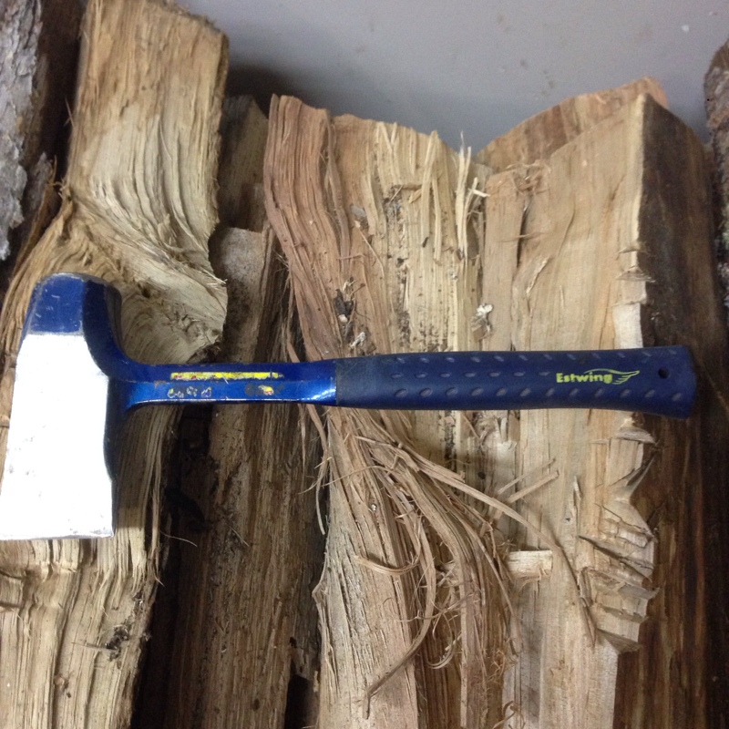

I bet you can figure it out. After all there are lots of steel shanked framing hammers right?

I was going to cut the head off of a steel shanked hammer and weld that handle on. I couldn't find a junk one and a new one was $20. This was a low dollar project. I decided to powder coat it to make it easier to find. A rubber grip like my kindling splitter would be nice. image-1058410705.jpg

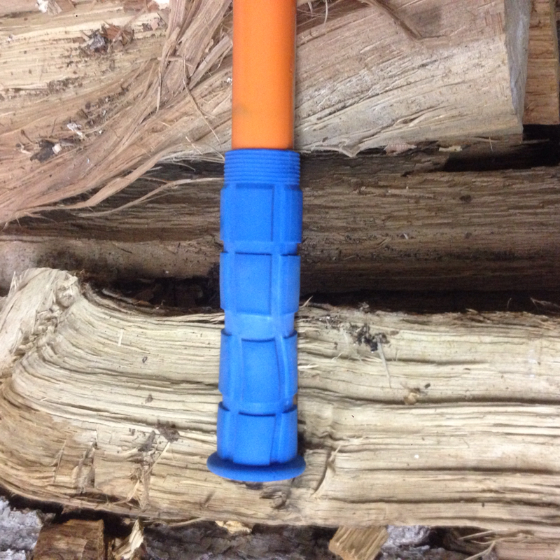

I came up with a likely solution. I stole a bicycle grip from the garage and managed to get it slipped on. I returned it to the bicycle. A new set is around $5 so that's close enough to low dollar.

great idea, that looks perfect. Better glue it, don't want that weapon flying off...
I used the same grip for the manual clutch handle on my Gravely rider.
/ Todays shop time. #96
try carburetor cleaner spray and then slide the handle grip on. makes it easy to slide on and makes the grip tacky after it dries. bike bmx riders did all the time
