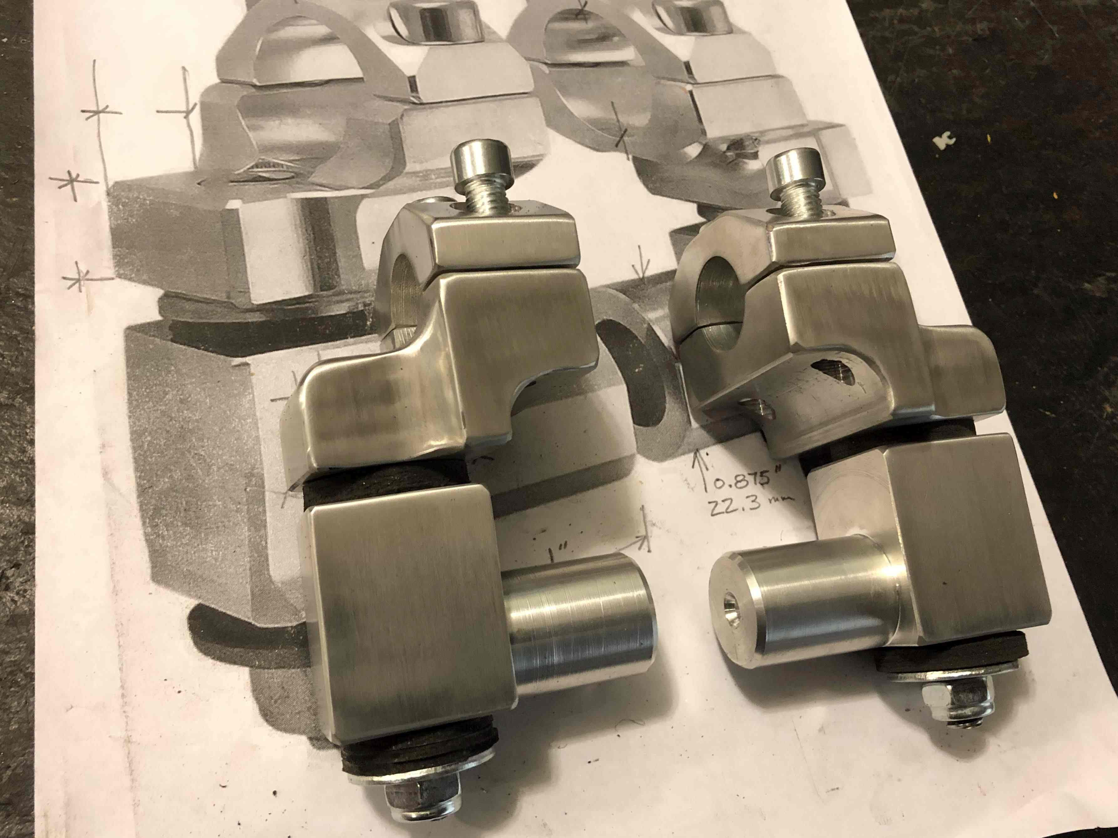

I needed to remove the vibration from my motorcycle handlebars. Planning a long trip out west this summer. The anti-vibration risers can be purchased for around $150, so I decided to give it a try. The picture shows the ones I built on top of a picture of the store-bought model. I used it to get an idea of the dimensions and then winged it a bit, making things up as I went along. Used an old gas line for the bolt bushing holding the two pieces together. The washers were cut from a block of rubber I had, but ran out of material, so I found a few rubber washers for one of the sides. And, the best news, they really work well.

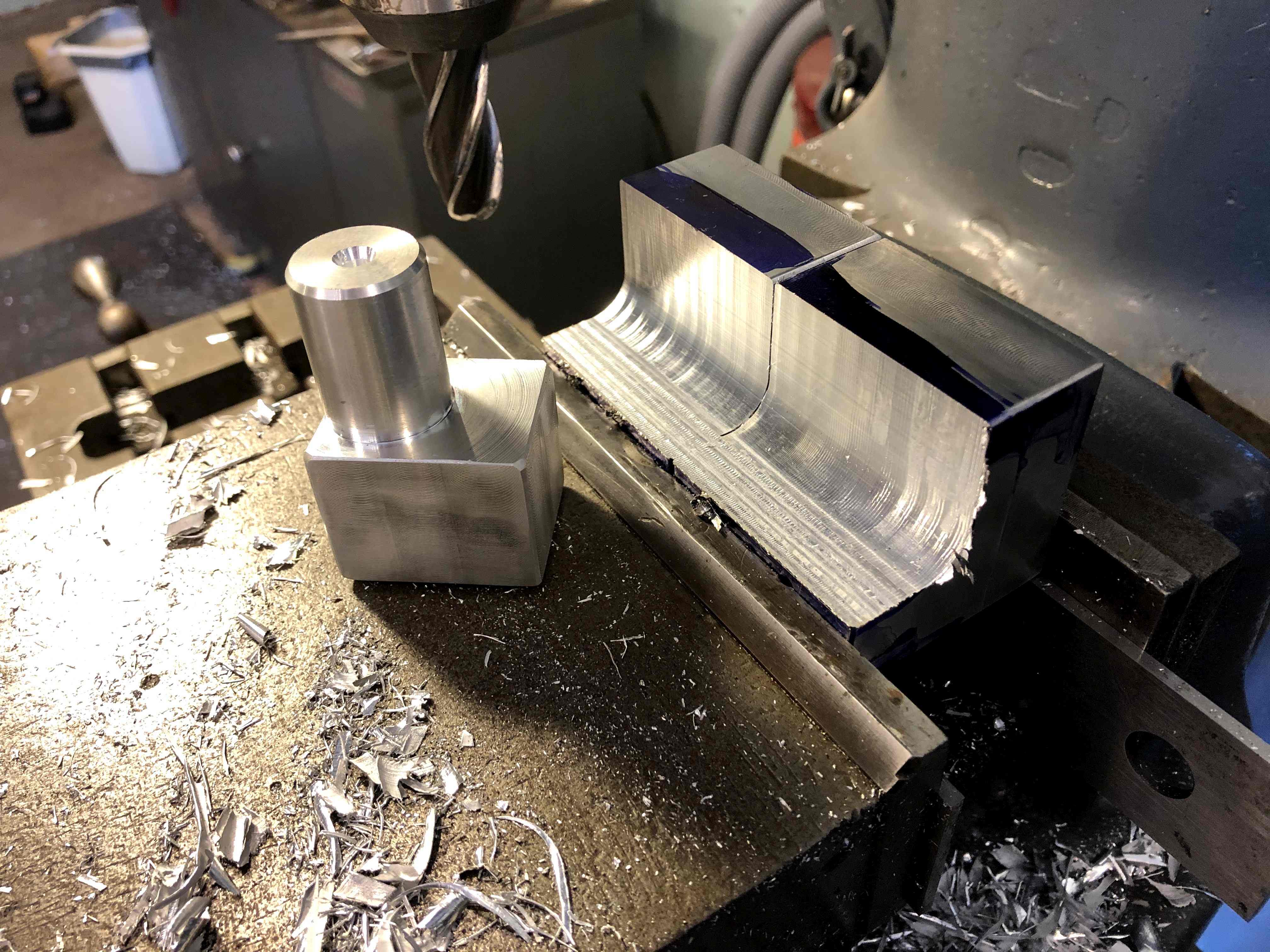

Here are some other shots along the way . . .

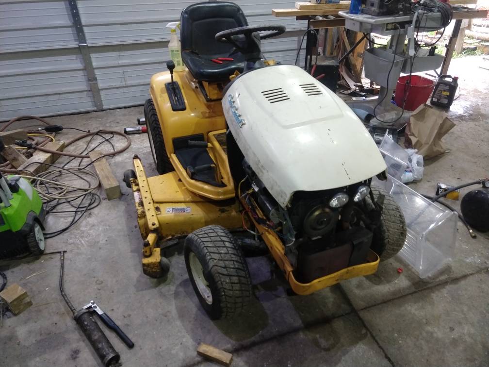

For the 1000th post in the thread, here is a mower that came through the shop, picked it up for a friend who was moving and needed a mower.
Needed a fuel pump, an oil change and headlights.

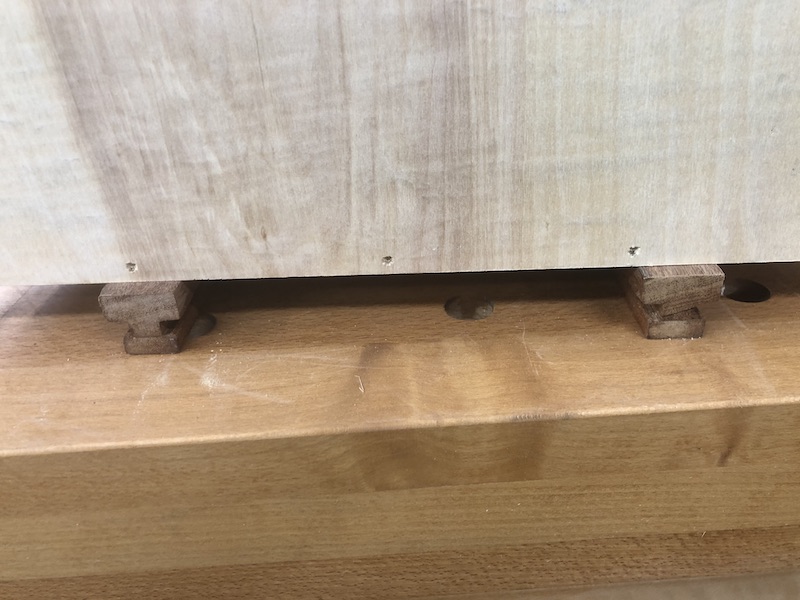

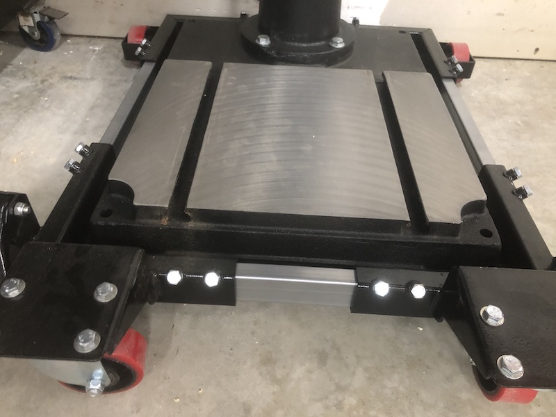

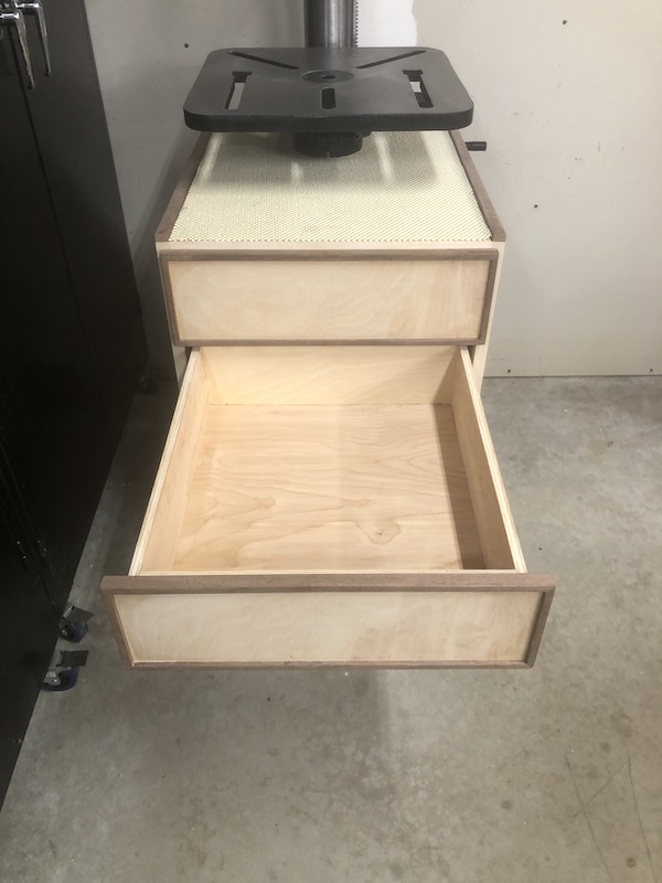

Hey figured I should post pics of my new drill press base cabinet I just built...
Designed it to mount on the base of the drill press and fit within the mobile base and attach to the T-tracks
The Tees are waxed hardwood and snugly slide on the tracks for easy removal if I have to lower the drill press table...
Two full extension drawers and a non slip top to temporarily store bits, chucks, keys, etc. while in use.
And a space below to store a sustainer...
   / Todays shop time. #1,000
^^^^ very nice, looks handy.
