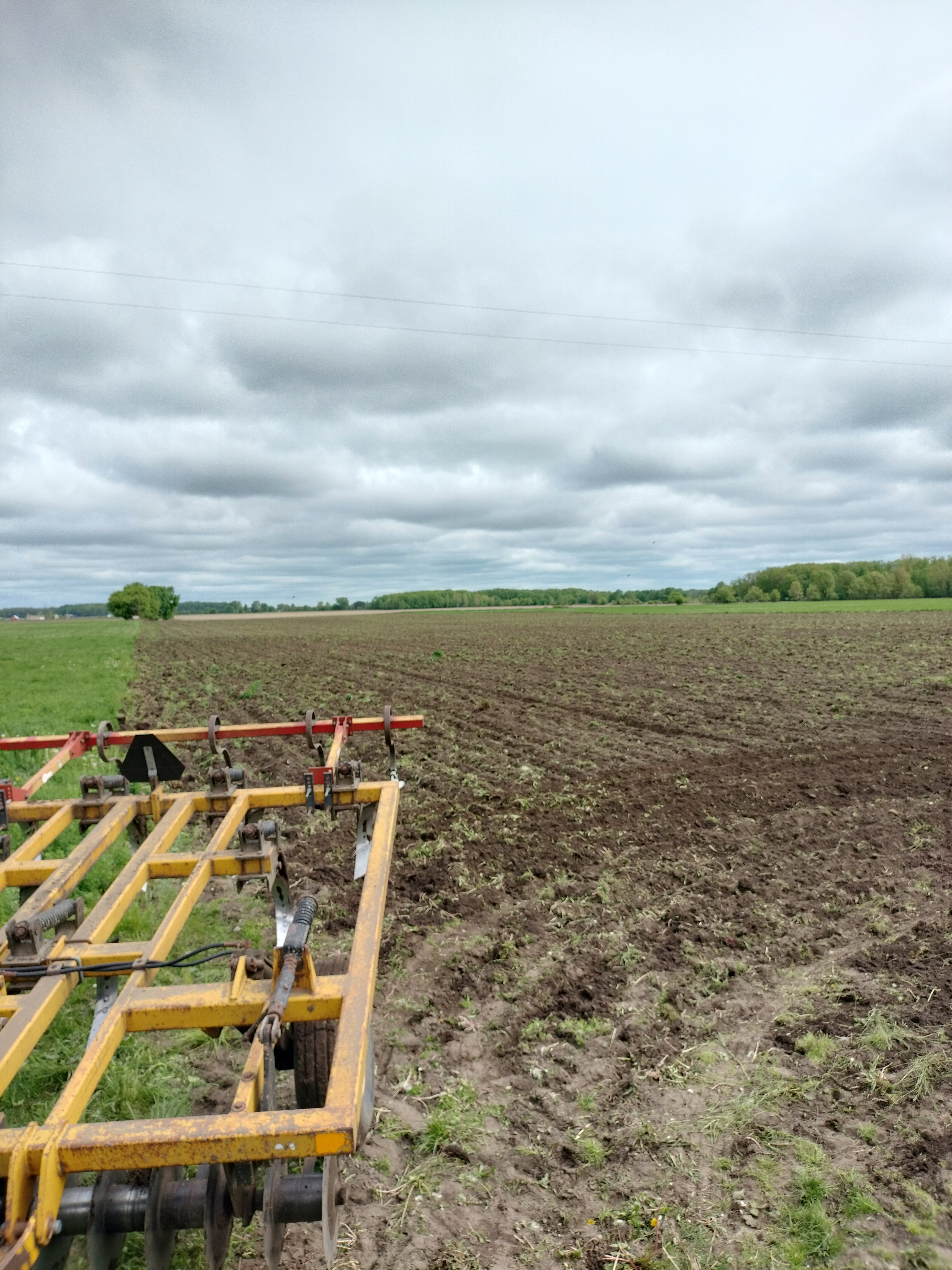

4.0 so far in the 5088 running the chisel plow. Probably do another 6.0 with the disc

Got 11.0 in today on the IH 5088. Plan the same for tomorrow. We chisel at 5.5 mph. Very few rocks. I picked them all when I was 10 😂
Ran about 80 acres today!

11.0 hours in the IH 5088 today. Put down about 80 more acres between the chisel plow and disc harrow. So 22 hours and about 150 acres by myself in this 115hp relic. Great tractor though, she has done a lot of work in her life.

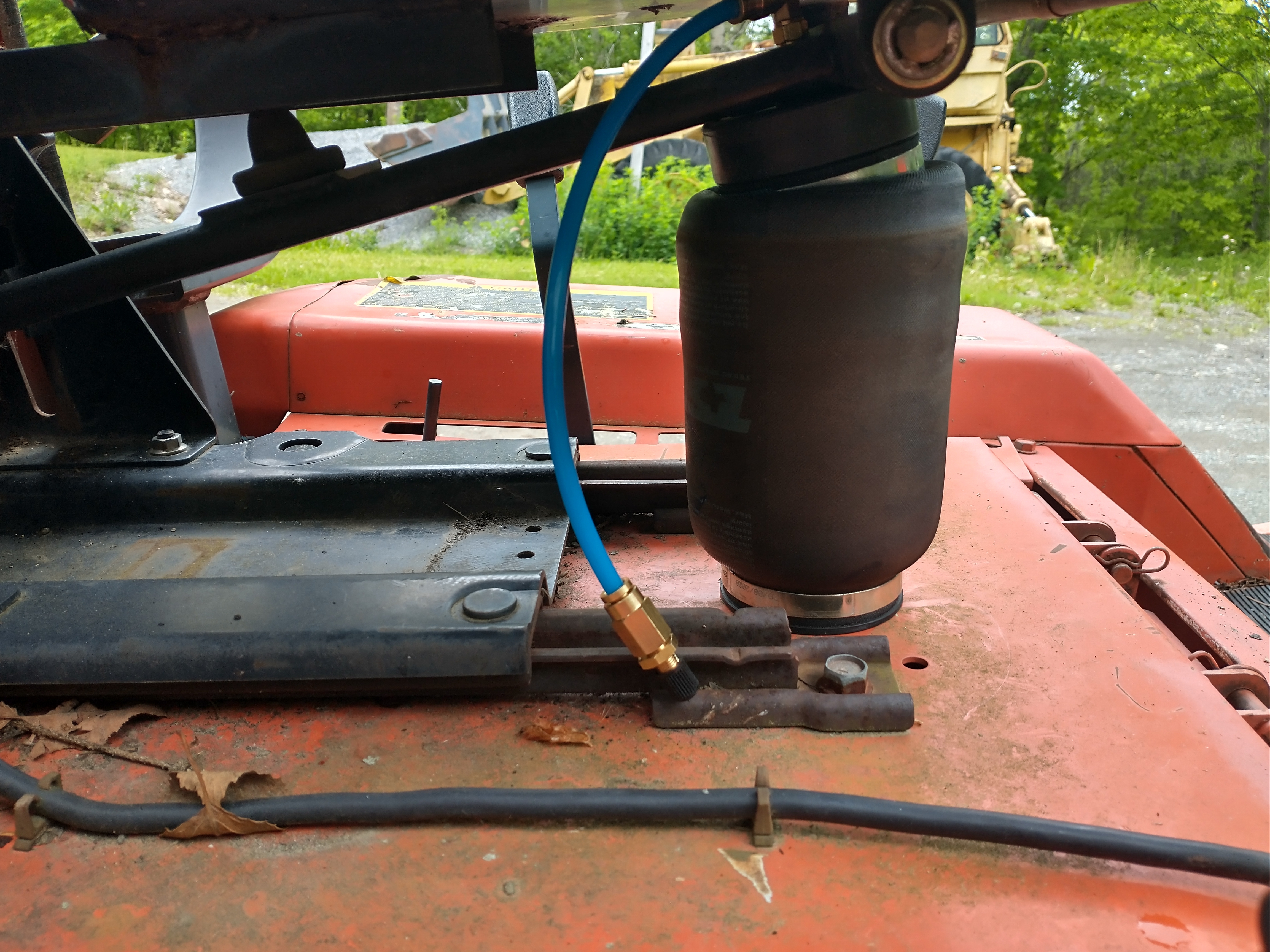

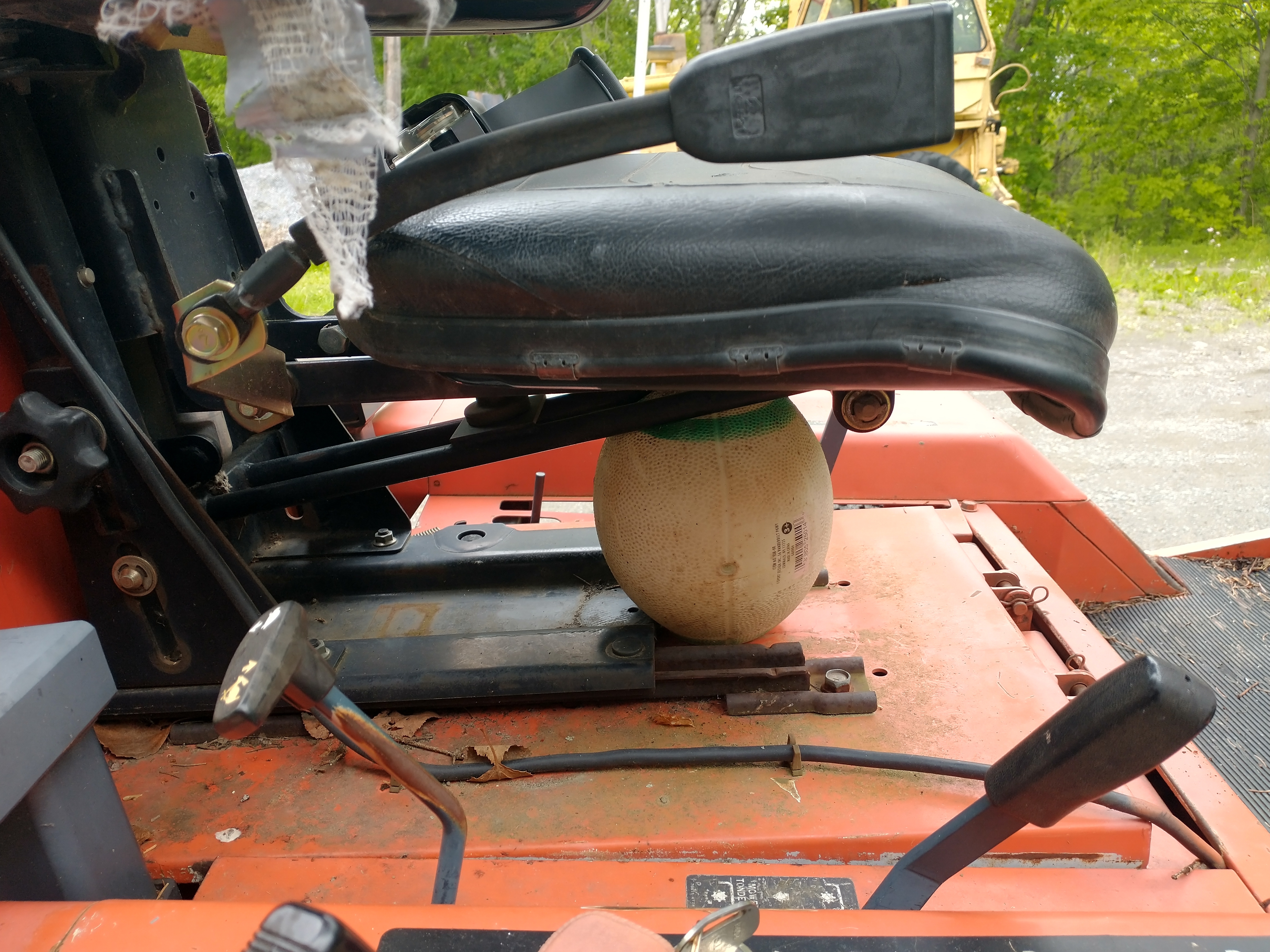

Well my seat time today was mowing a soggy lawn, after a minor upgrade to my old F2000 seat suspension;
The mechanical suspension on the Kubota F2000 was pretty well whipped for some odd reason, couldn't have been because it was 39 years old or that I tip the scales at close to 320 pounds.
I had squeezed a toy football in under the suspension for a couple of years and that actually helped, quite a bit when the air pressure was right.
I picked up a seat air spring a year ago and put it on the shelf and promptly forgot about it until I was wanting to mow.
Well today I dug up the fittings and a bit of plastic tube and installed it.
Inflated to 10 psi and backed the old suspension spring down to mid scale, wasn't bad took the pressure up to a bit over 11 psi, dang that is nice.
old .........................................................................new

I like the new seat suspension but the football gave it a special look. I had to look up Kubota F2000 to see what it was. I can't remember ever seeing one of those. Still going after 39 years is a testament for old fashion quality and good maintenance !!
