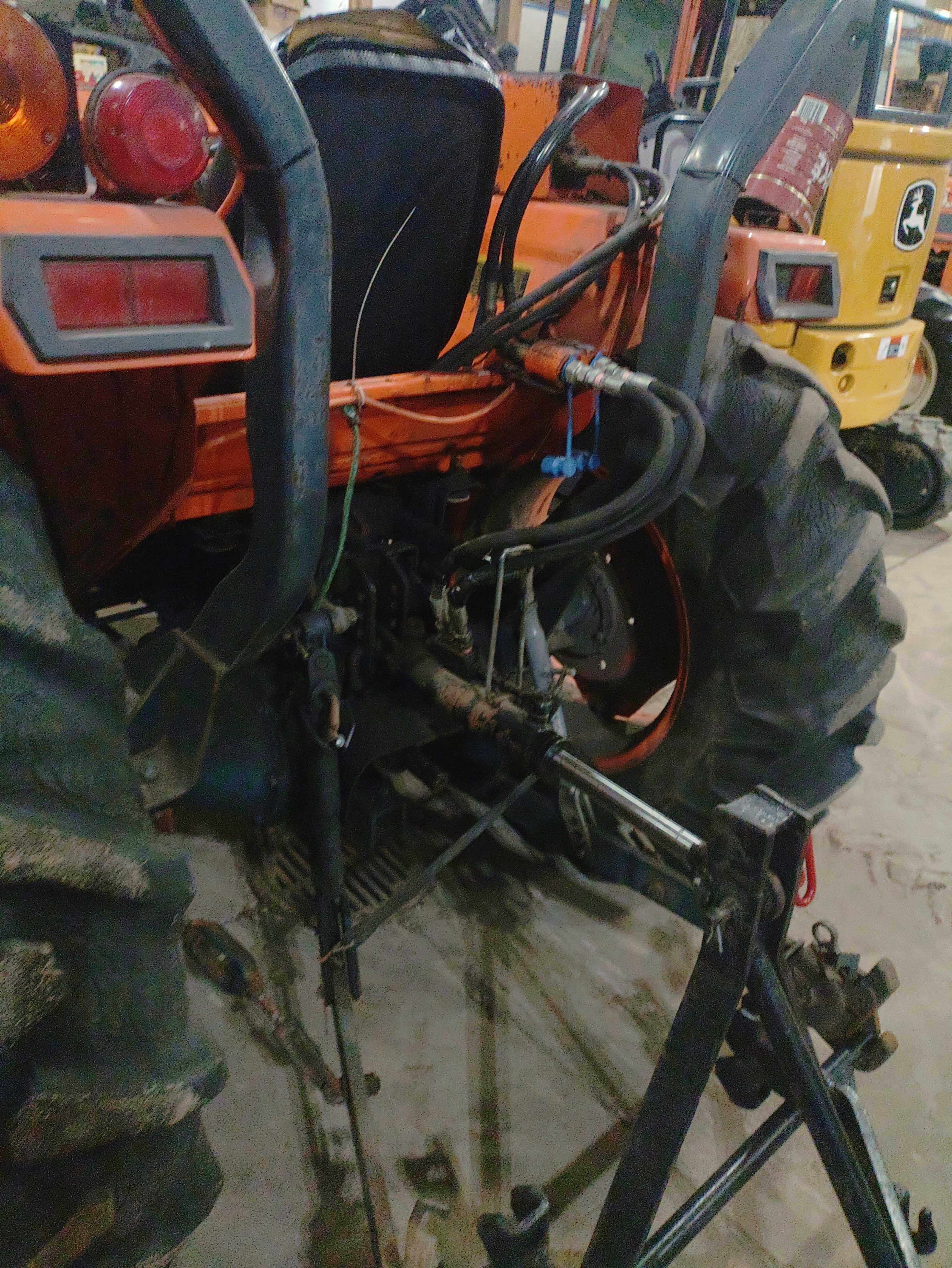

The trailer mover i Hacked together that I plug it into has A frame it was mostly off a repurposed tp attachment in derelict condition I had no use for. I did have use for a tph trailer mover though. You run the hydraulic top link retracted it does seem more aggressive and the tines dig in the ground sometimes aggressively, extended its less aggressive think because the curvature of end of tines are more parallel if not floating above ground. You really want to use the rake aggressively which I don't recommend especially the quality of this one you can retract the top link break thru the ground then extend top link until you hit rocks or roots it can dig down pretty aggressively. Not using the draft control. Both my old kubotas have two different set ups for using tph regular up down found on most tractors and draft control lever which is what I normally use when rakes on. Anyways I usually set draft control midway and use lever for controlling top link and subsequent tine angle.

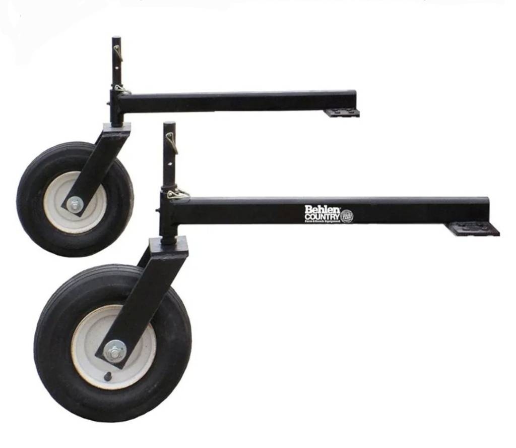

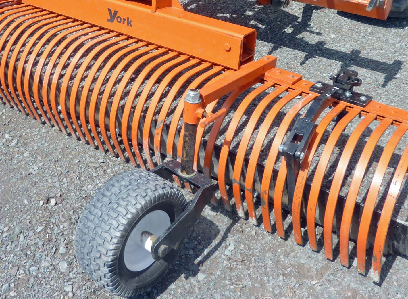

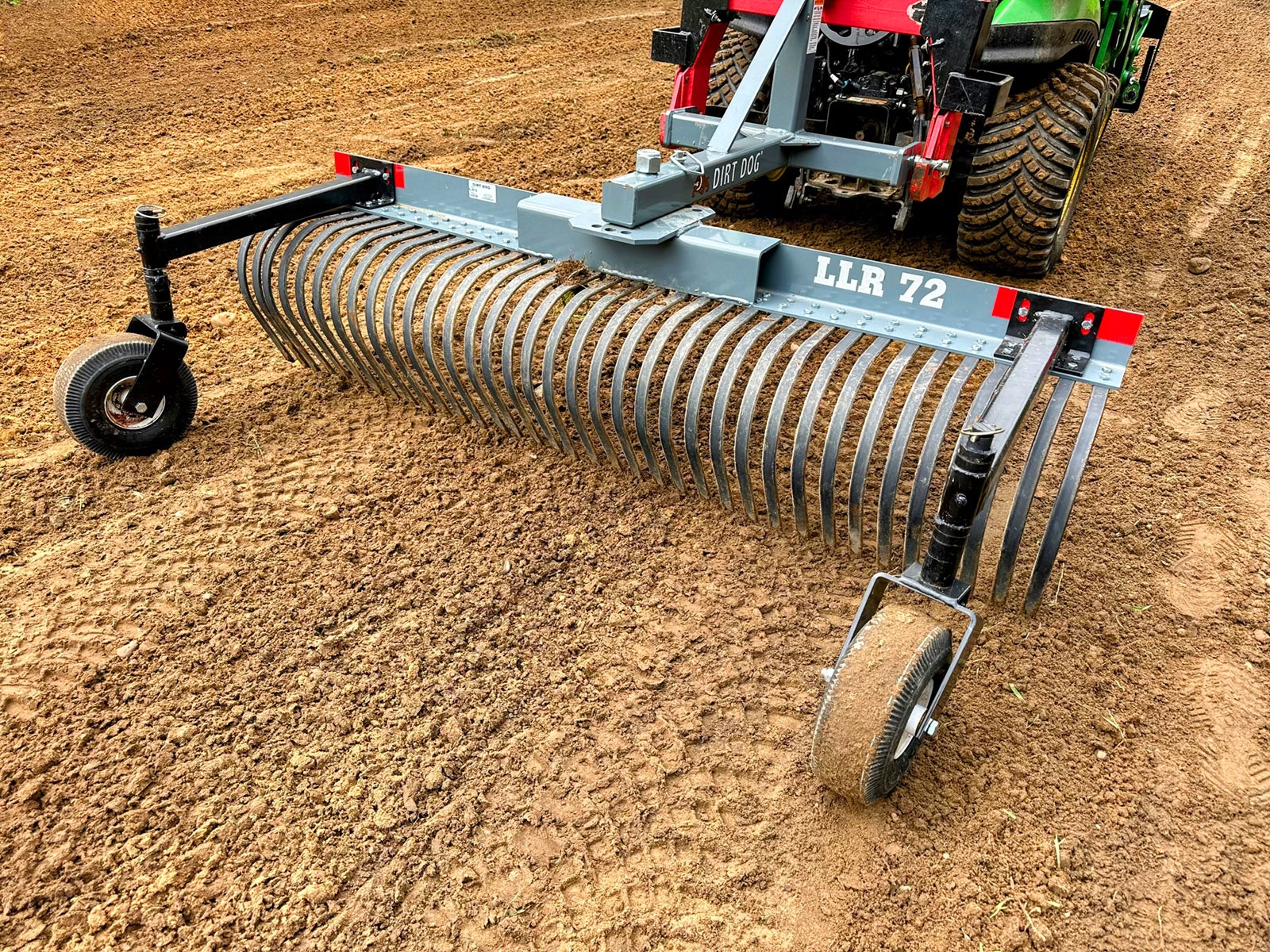

Few of us on TBN have the practice and skill to keep implements on the 3-point of our compact tractors level as the tractor pitches on uneven ground. I'll wager fewer still have draft control on their compact or smaller tractor or even know what draft control does. As many have stated, gauge wheel are almost a necessity with landscape rakes. I concur with their usefulness. I also concur with the practice of less aggressive raking with the tines reversed (concave backwards with respect of direction of travel). A shopper for a rake should be aware of some geometries that may affect these practices.
Can one spin the rake 360° (or 180°)? Some structures may impinge on this. A long rake may not turn when attached, or the parking stand stub may interfere. Other structures may strike the arm between the 3-point and rake swivel. The quickest work-around is to rake "reversed" in reverse. How close are the gauge wheels to the tines? On York rakes the casters do not have clearance between the vertical pin and the tines. On my Land-Pride there is enough room for the wheels to pivot 360°, and the longer arms make for smoother raking but limit some close space maneuverability. This is not an endorsement for either brand but somethings to consider when shopping.

bmaverick, Will you identify which particular brand of rake that is please. Those gauge wheels look like they are readily available for adaption to another rake and they look quite stout also. Thanks Greg
