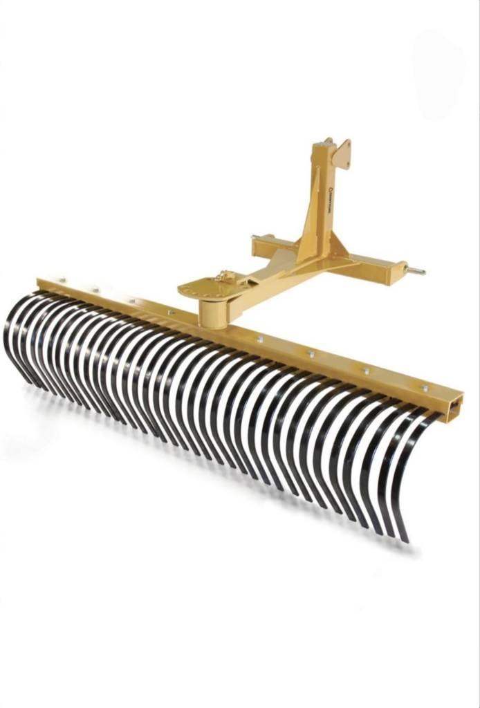

I recently got a stump grinder which does a great job but leaves a foot deep pile of chips and dirt. I have 40 pines all in a row to do.
I was thinking about a rake like this TSC or similar.
1) if I use it for small limbs, sticks or leaves does it work for that?
2) does it damage the lawn. I have hydraulic top link so I can change angle
3) It won't get a lot of use. What's the best bang for the buck?
4) 6ft.? (50hp Deere)
5) We have a horse paddock that's compacted with sand on it. It's about 50x60, level & hard as concrete. Horse piles I clean area every 2 weeks or so. Would it work for that?
I have a 7ft rear blade or sometimes just the FEL bucket...but I then have to put a little more sand down.
6) Is it useful for anything else?
Thanks so much...View attachment 4265190
I have the exact same rake from TSC and have used it for 5 years . Its my favorite rear implement. They do make a set of gauge wheels for it as well which you can set at a height for a perfect level finish. The thing is a beast you will not be sorry buying it.

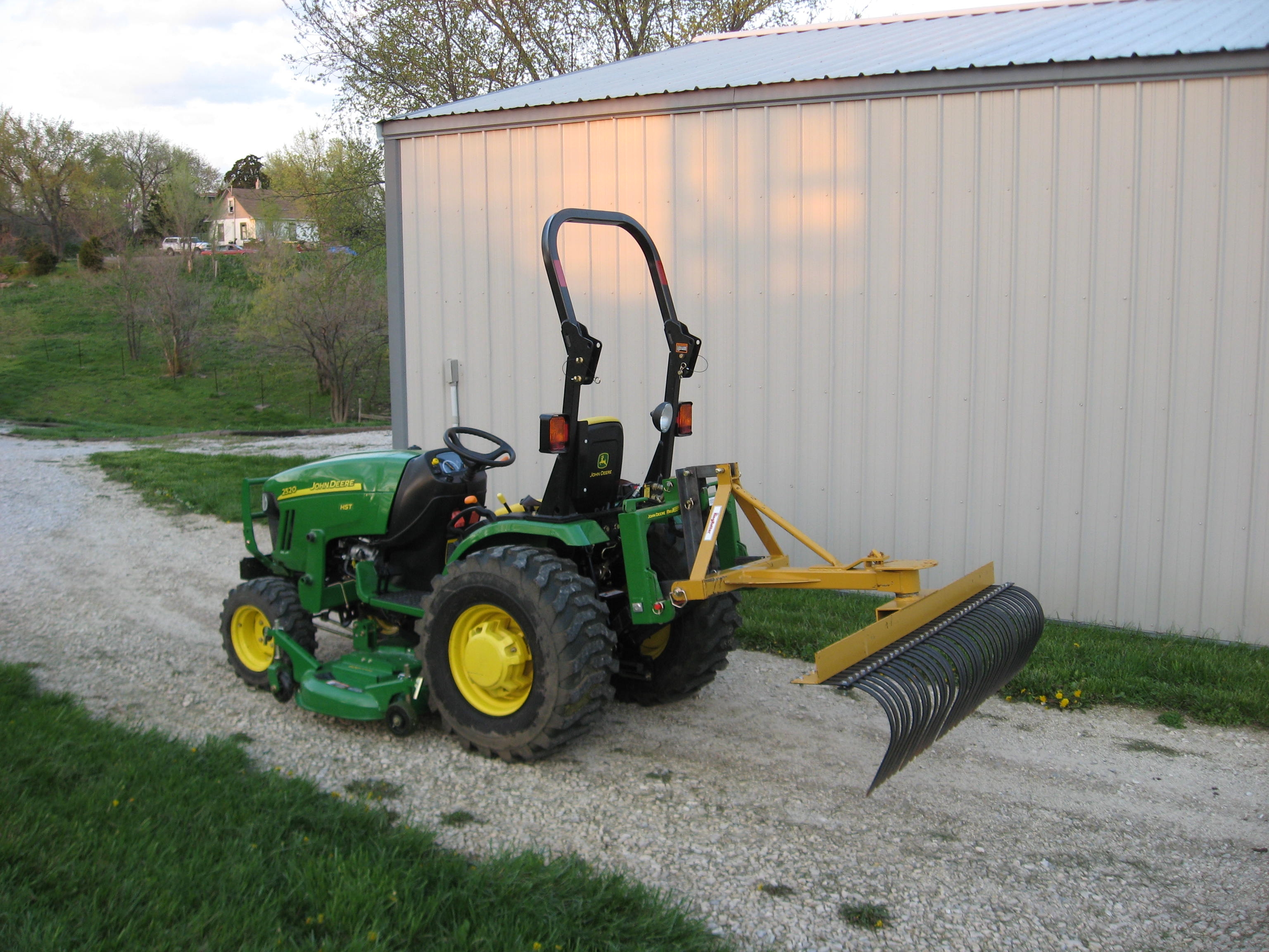

I have one, very similar to the one pictured, that I use to rake leaves/branches in a semi-wooded area. It works very well along with my grapple to clean up the area. Sure saves a lot of time and work, as I hate raking leaves by hand. Although I'm not sure how it would be on a finished lawn without gauge wheels. I also like to use it to refresh my gravel driveway.

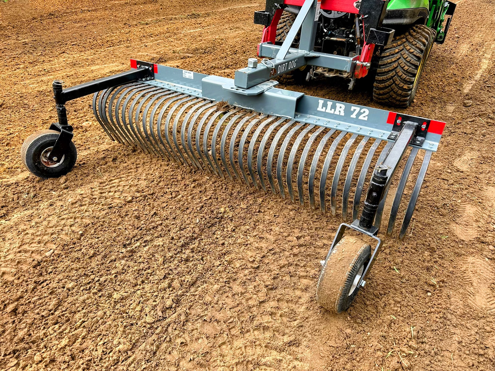

Could someone show a close pic of how gauge wheels attach to the rake? I’m considering if I can buy a set and fab the attachment.

For an idea of how to attach or fabricate gauge wheels, go on line and look at pics of land Pride or York rakes on their websites.

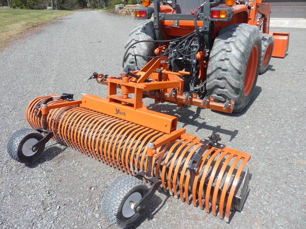

Looking at the pics of the gauge wheels you posted, the tires on the orange rake and on the red hubs in the close up look pretty light duty. Might want to look at the York rake Co. site to see ones more HD.
/ How good or useful is a tractor rake? #39
The York rake has a bracket bolted to the frame on one end and a short sleeve welded to the other. A threaded T handle screws into the sleeve and allows for height adjustment of the wheel yoke.
