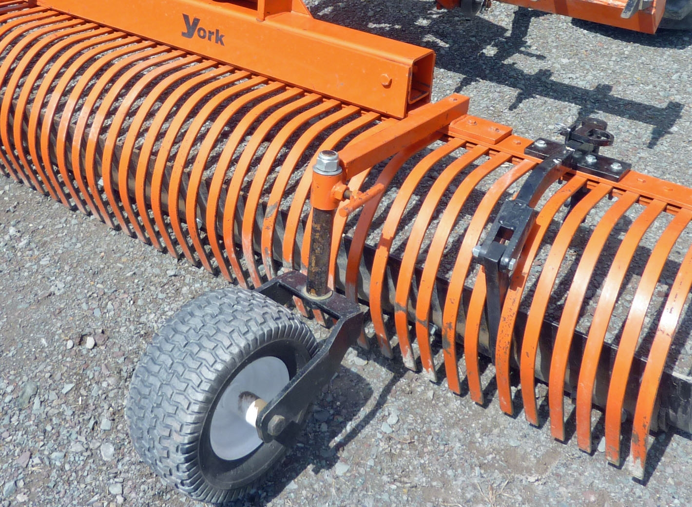

The York rake has a bracket bolted to the frame on one end and a short sleeve welded to the other. A threaded T handle screws into the sleeve and allows for height adjustment of the wheel yoke.
There's a big difference between $1,200 and the York $3K to $4K for something not used a lot. Everything is going to be better if it's double or triple the price.

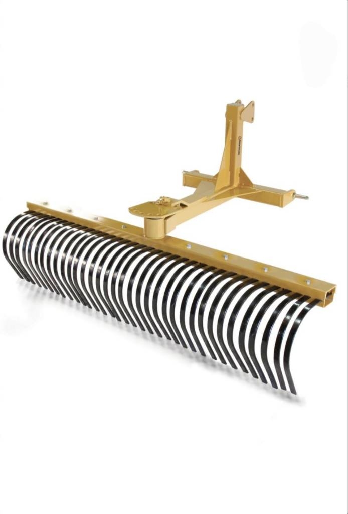

I guess I'll soon have 40 attachments!
I recently got a stump grinder which does a great job but leaves a foot deep pile of chips and dirt. I have 40 pines all in a row to do.
I was thinking about a rake like this TSC or similar.
1) if I use it for small limbs, sticks or leaves does it work for that?
2) does it damage the lawn. I have hydraulic top link so I can change angle
3) It won't get a lot of use. What's the best bang for the buck?
4) 6ft.? (50hp Deere)
5) We have a horse paddock that's compacted with sand on it. It's about 50x60, level & hard as concrete. Horse piles I clean area every 2 weeks or so. Would it work for that?
I have a 7ft rear blade or sometimes just the FEL bucket...but I then have to put a little more sand down.
6) Is it useful for anything else?

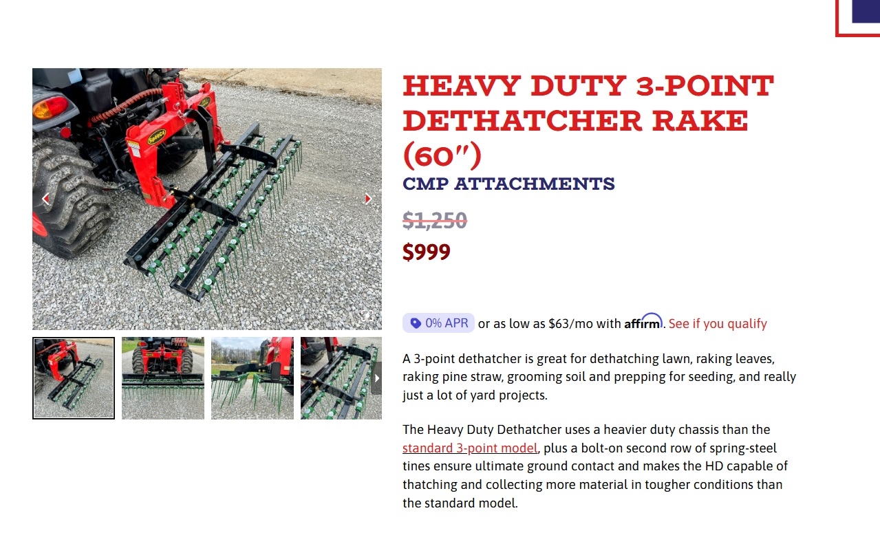

I used to use my york rake for trails, driveway, goat pen, etc. But found it got clogged a lot with twigs and thick weed stems and I have to get off all the time to unclog it. I got this one Heavy Duty 3-Point Dethatcher Rake (60") CMP Attachments and love it for all those things. Never get's clogged up and doesn't damage the lawn.

I read none of the posts but have used rakes like this for 50 years, homeowner and commercially. They will not damage your lawn but will also not adequately gather the chips. They are already gathered at the stump. I have a stump grinder and when I'm done use an aluminum scoop shovel, a rake and get what I can. Put some dirt in the hole and after a year or two the grass will fully fill in and look great. Grass grows though some chips but not too many. I've done threads on chips and stumps and grass so search if interested. Leaf blowers disperse the few chips out in the lawn.
**Wider is better. 8 ft is what I have and you should too. Pay up and get a heavier one since weight matters. Light ones bounce over things and make a mess. Narrow won't cover your tracks at an angle.
**They rake dirt best if's it's 100% powdered dusty. If not clean, it will pick up any twigs, stones or bunched grass and that will pile up dirt and make a mess.
**They work great in a driveway as long as the stones aren't too big. Bank-run gravel works great as does 1/2" and down to dust crushed.
**The best kept secret of the landscape or rock rake is that they plow powdery snow great. Drive over the snow with the rake flat to the ground and at an angle and an 8 ft rake will just plow it aside and not pick up gravel if it's frozen or you have some experience under your belt.
**Using for grading with a tractor with draft control is an another thing. I could make acres as smooth as glass and put in acres of grass so flat that people would stop and take pictures. There are threads on draft control as well.
