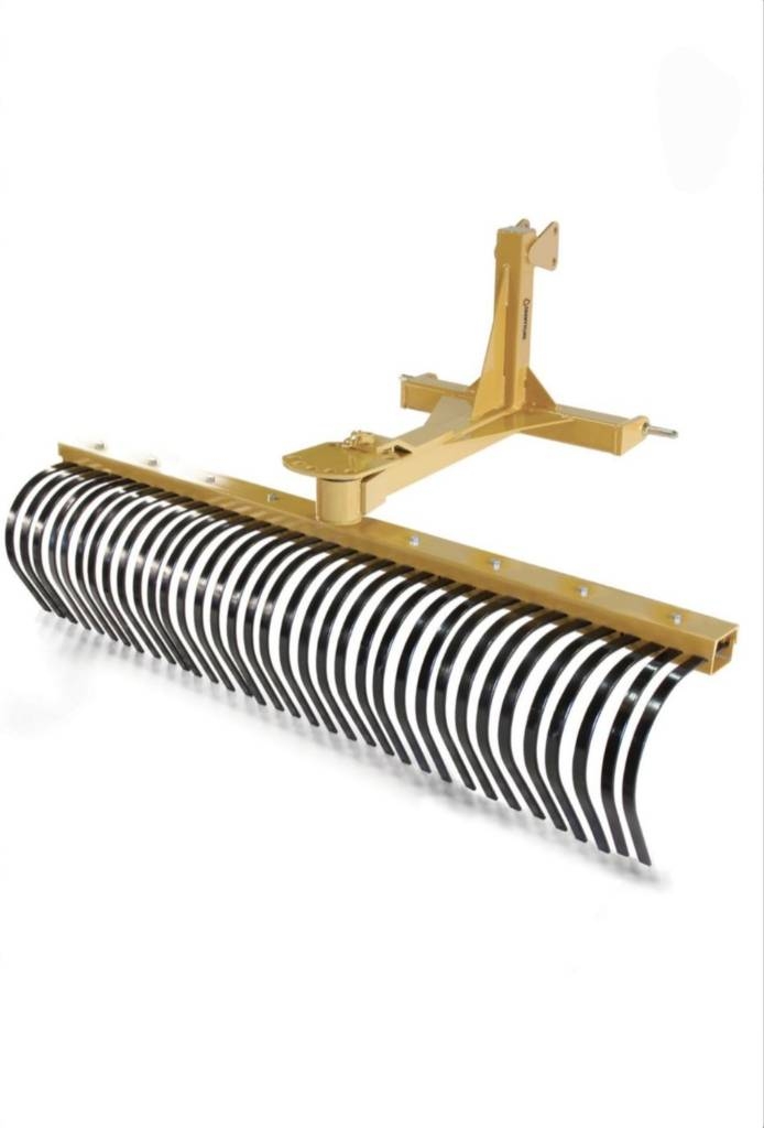

I recently got a stump grinder which does a great job but leaves a foot deep pile of chips and dirt. I have 40 pines all in a row to do.
I was thinking about a rake like this TSC or similar.
1) if I use it for small limbs, sticks or leaves does it work for that?
2) does it damage the lawn. I have hydraulic top link so I can change angle
3) It won't get a lot of use. What's the best bang for the buck?
4) 6ft.? (50hp Deere)
5) We have a horse paddock that's compacted with sand on it. It's about 50x60, level & hard as concrete. Horse piles I clean area every 2 weeks or so. Would it work for that?
I have a 7ft rear blade or sometimes just the FEL bucket...but I then have to put a little more sand down.
6) Is it useful for anything else?
Thanks so much...

We use ours in the spring to rake the small branches and things that fall on the trails. Was it worth the 950, 2 years ago I think so, it’s not used much but saves a lot of time!!!

I have one. Old school york industrial model. Hydraulic angle. Works great for grading gravel and picking rocks.
I like it.
/ How good or useful is a tractor rake? #5
I've had mine for a long time, it's 7 ft for 6ft wide tractor. Never does exactly what I want... the exception being windrowing fist rocks on hard ground for pick up. In tall stuff it just pulls grass and weeds until it clogs up. On deep gravel it digs deep every chance it gets. I added hydraulic angle. Rock collection it's good at, may work for your manure collection in a hard pen too.

I bought that exact same one and the first time I used it to gather up small limbs after cleaning up a downed tree it bent and twisted like a pretzel and some of the tines fell out. That cross channel that is used for the main beam is just to soft for the job on that brand. The one I have is headed to the scrap metal yard next trip.

The rake for the wood chips IMO just spread them around more. It might be easier to drop the bucket to the left side of hte stump leaving room for the tractor and chip into the bucket then rake by hand whats left when your done.
No easy way to clean up wood chips unfortunately. But for your other users paddock etc would work for that but a pine straw rake might be a better choice for the paddock and sticks etc.

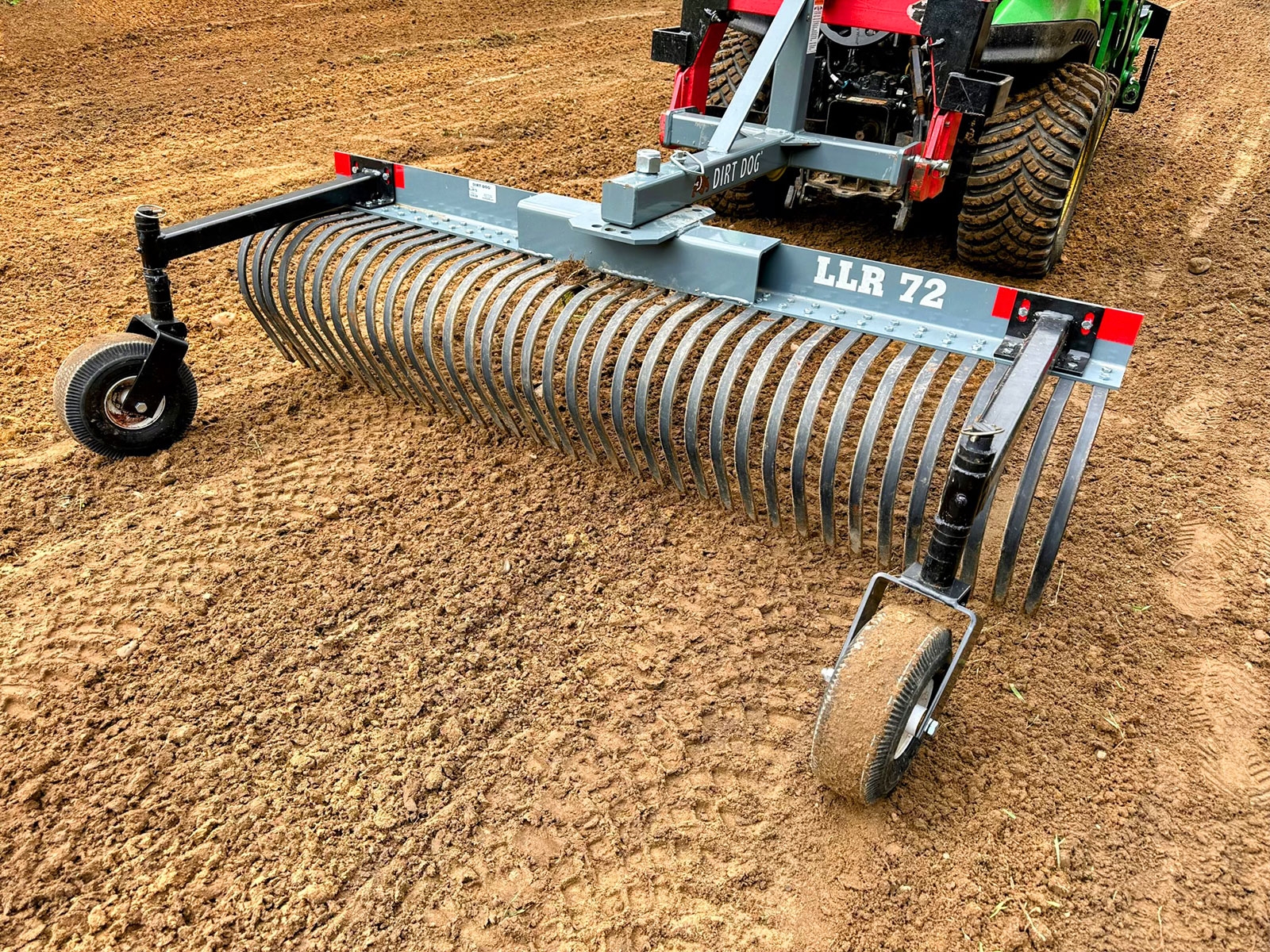

A rake becomes much more useful if it has gauge wheels. They can be set to minimize surface damage when raking lawns or gravel driveways instead of relying on 3pt height adjustments. Add a T&T kit and you have a very versatile implement.

As @bdhsfz6 said, gauge wheels make it WAY more useful.

I've had mine for 17 years and have not yet found a good use for it.
I guess I thought it would be good for grooming the gravel drive, but I've found it's better to leave the gravel alone as much as possible, because whenever I loosen it up by "grooming" it wants to wash and move around. Also, when trying to "groom" the drive with a rake (or blade for that matter) it always winds up pushing my gravel out into the grass and I wind up having to rake it back onto the drive by hand, so, not worth the effort. On the rare occasion I need to fix a spot on the drive, I use the rear blade with gauge wheels.
I can't imagine how you could use one to rake up sticks without gouging the crap out of your lawn.
I will say, of the possible uses, grooming a horse arena sounds like about the best one I could imagine for a rake. Spreading out piles of dirt/wood chips in a pasture type setting sounds feasible.
Whatever you do with it, I recommend also getting a pair of gauge wheels for it because, just like a rear blade, it's really hard to keep it from digging in on uneven surfaces.
