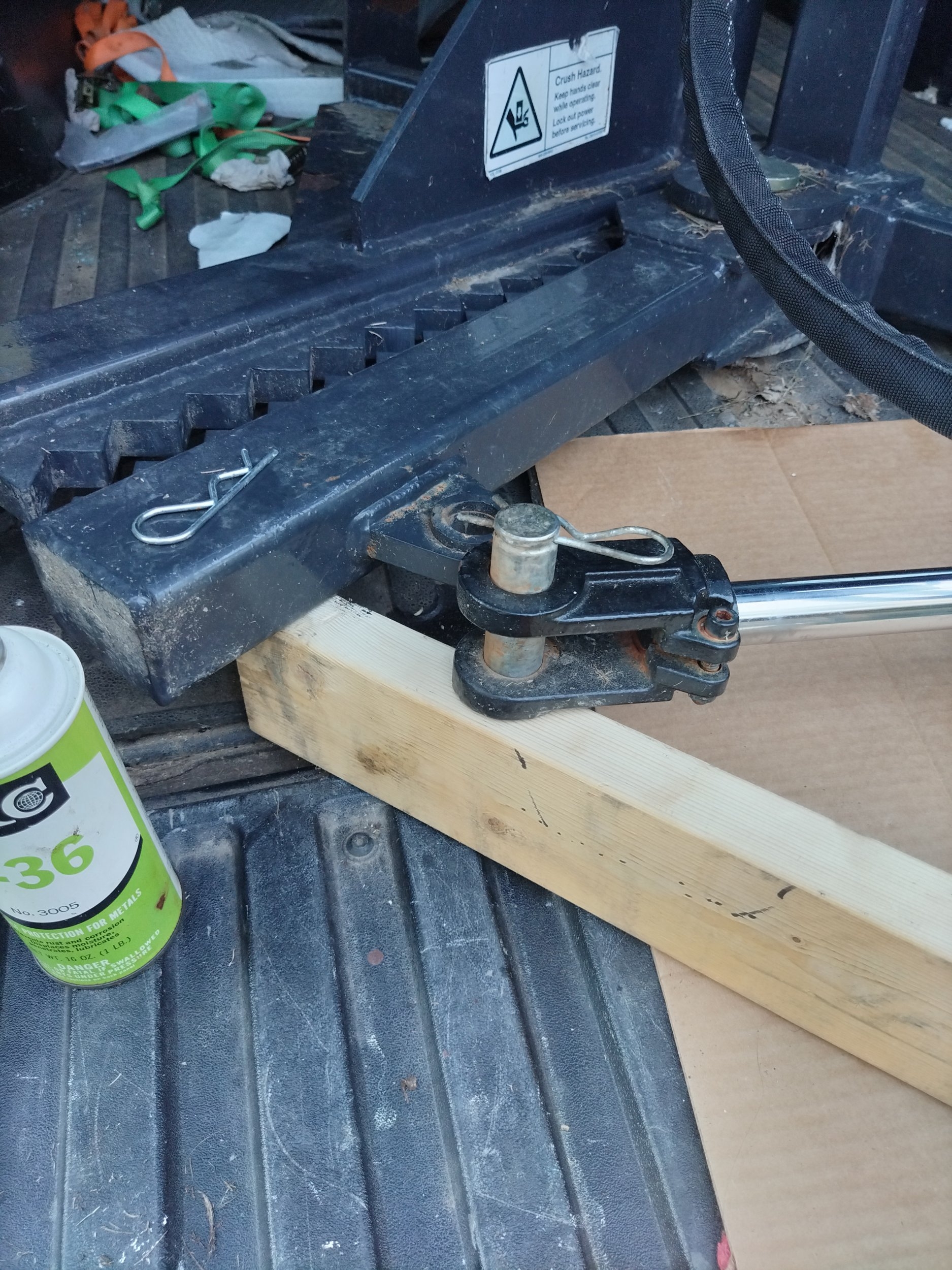

I just got a used tree puller and there are no grease fittings on it. The 2 pivots for the hydraulic cylinder are kind of open and I could see lots of dust and dirt getting in there. The larger pivot for the jaw is a bit more closed and protected. My question is should I still grease the 3 pivots? Will I just be creating more wear in those open pivots by the grease creating a grinding paste? The upside is those pivots are VERY easy to service. I am thinking about adding a grease fitting to the larger jaw joint that is more protected. Here is a pic of the open hydraulic pivots

No grease, for those. Grease would only attract dirt and create the "grinding paste" you mentioned.

On the contrary, I would drill and tap those moveable joints for grease fittings and keep them well greased often. The infusion of new grease in those joints will evacuate any and all dirt and grit and keep them from wearing excessively. Anytime and everytime I rebuild any customers to be repaired or remachined assemblies, I always drill and tap ALL the moveable joints for grease fittings and instruct my customers to grease them and not with cheap, clay based econo grease either. Only Polyurea based semi synthetic grease and do it often. Really prolongs the life of moveable joints, especially those under high load.

I have a couple joints like that. Haven't taken the time to drill/tap/instal zerk. I disassemble - clean - grease - reassemble.
I know - one of these days. It's on my list but keeps falling to the bottom. Just too easy to do it the "old" way.
However - the point is - - I do grease these joints.

Yeah, they are lightly greased at the moment, so I will probably roll with that for now. It is not like I will be digging with this thing, and they are very easy to service. So I will reassess in a couple of months.
