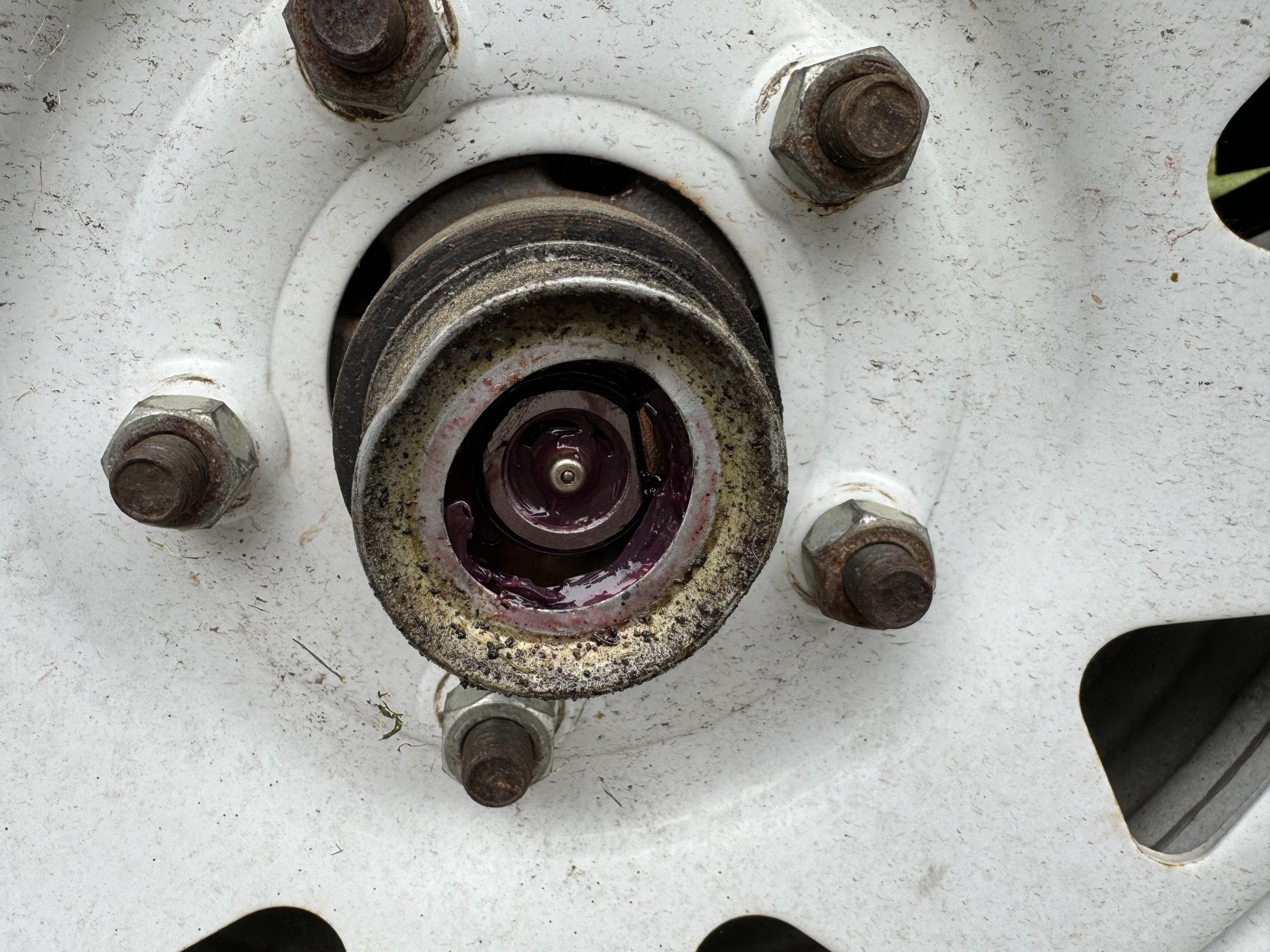

Yes they are EZ lubes. I redid all four hubs with new brakes assemblies and new inner and outer bearings and races. Reused all four grease/dust caps. Three have remained on and one was shed on the first day. Replaced with a new cap twice on return trip and shed again. Have now lost three all on the same hub. The other three original reused caps are holding just fine, at least so far they are holding after 1000 miles.

Empirical evidence indicates that this is a problem with the hub itself. Maybe there is a hairline crack in the outer bore that allows the cap to work out due to force redistribution during rotation.
If close inspection and a dye pen test doesn't show anything, swap sides and see if the problem stays with the hub (I'd probably strapping tape a lanyard to the cap so it doesn't get lost) or with the original axle location. The spindle could have a slight bend that would set up harmonics that worked the cap off, but that's admittedly getting into the weeds theory wise.

^ This. If three of your four hubs are fine, and just one keeps ejecting caps, it's obviously time to pull that one apart and figure out what's happening. I can't believe anyone would actually suggest mod's like pinning the cap or venting the hub, EZ Lubes are a well-engineered system that should work without DIY mods, and it's clear there's a problem with just this one hub.

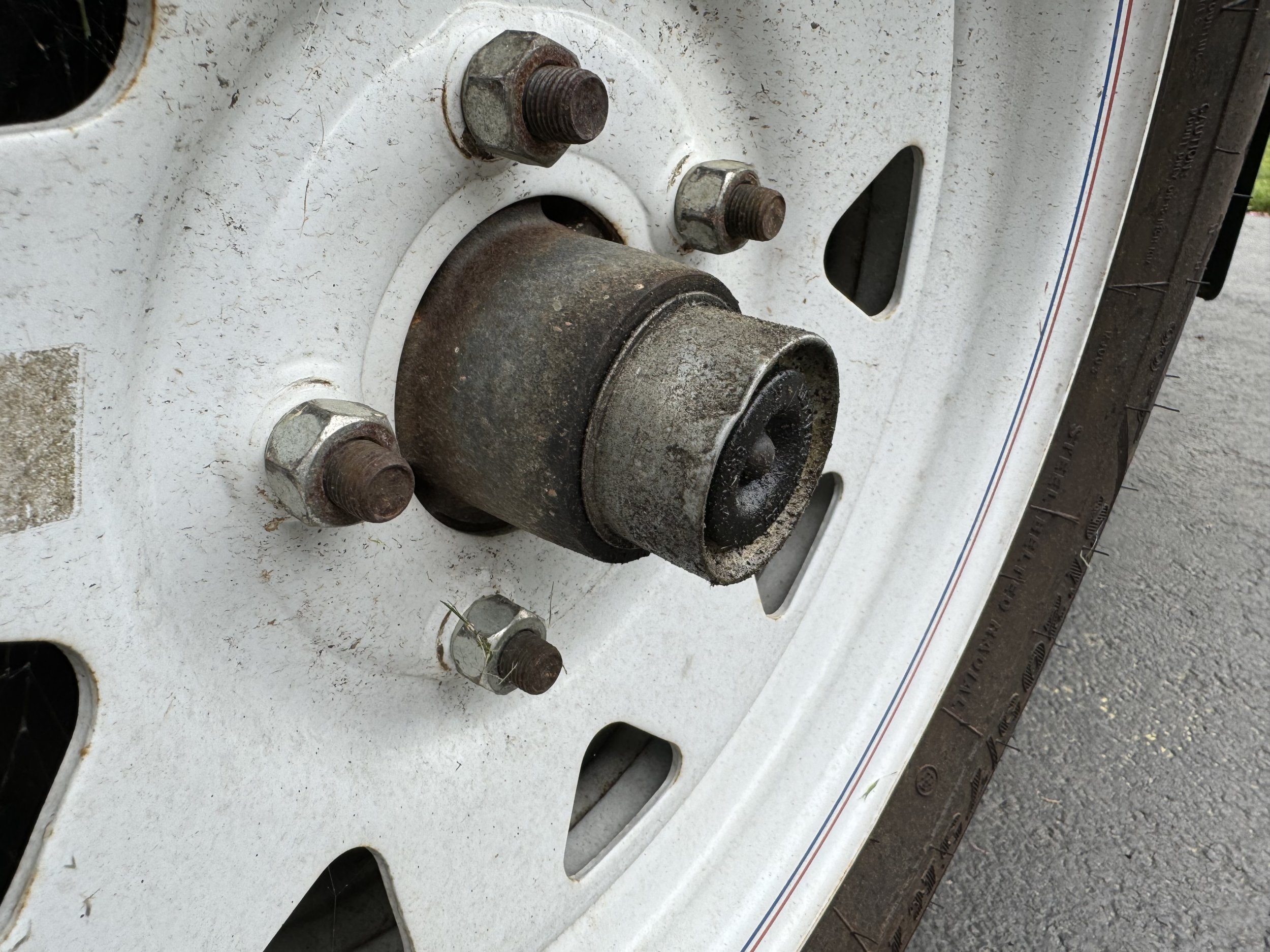

I was out mowing this morning, and happened to notice how badly one of my EZ Lube hubs was deformed. Still no issue staying together!

No it is not the rubber inner plug it is the entire metal grease/dust cap. Now having said that the rubber plug I presume went with the cap
That is for a much lighter weight axle and hub but the principle is the same. Never had this problem before and I have seen them beat up before as well

The wheel bearing may be too tight, producing more heat that normal. Supposed to be 1 flat off from slightly tight. Make sure the Cotter pin isn't interfering with the cap.
