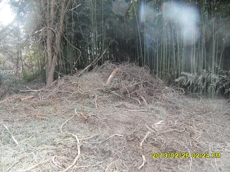

Heh, wanting a tractor is as natural as us 50s kids wanting Lionel trains back then. Looks like you'd be flat enuf to use a SCUT, but I'd want to rent a mini-ex for big chores, since with a sub-framed BH on a CUT or SCUT you might lose ground clearance and/or come up short on raw digging power. What I mean is just choose based on o'all battery of attachments you plan for.
Sometimes a small gen & sawzall beats a chain saw for cutting vines/roots 'out back', with less time spent changing blades vs dulled chains. 'Brush Grubber' gets small stuff out roots & all, pulls vines down from standing trees once cut-off at the base. Chip all while green ... or burn later. Push piles with a ratchet rake or similar and just bundle onto bucket with tie downs to haul out vs using/buying a grapple.
btw: Don't wait to put up bat houses, Summer's coming. :) Habitat mgt is a fun 'hobby' in itself. As time goes by you do less & enjoy the results more, nice as you get 'up there' in age, too.... ;)
