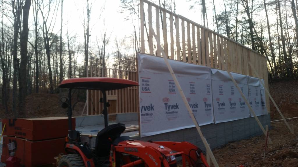

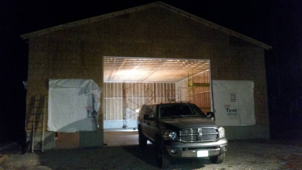

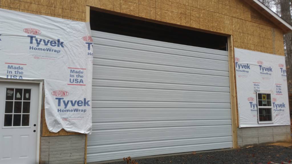

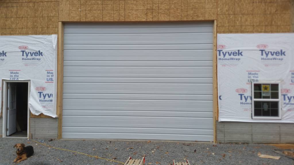

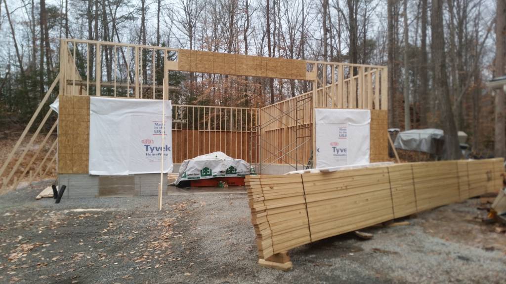

With the roof on, doors in, and tyvek up it was time to get to work on the electric.

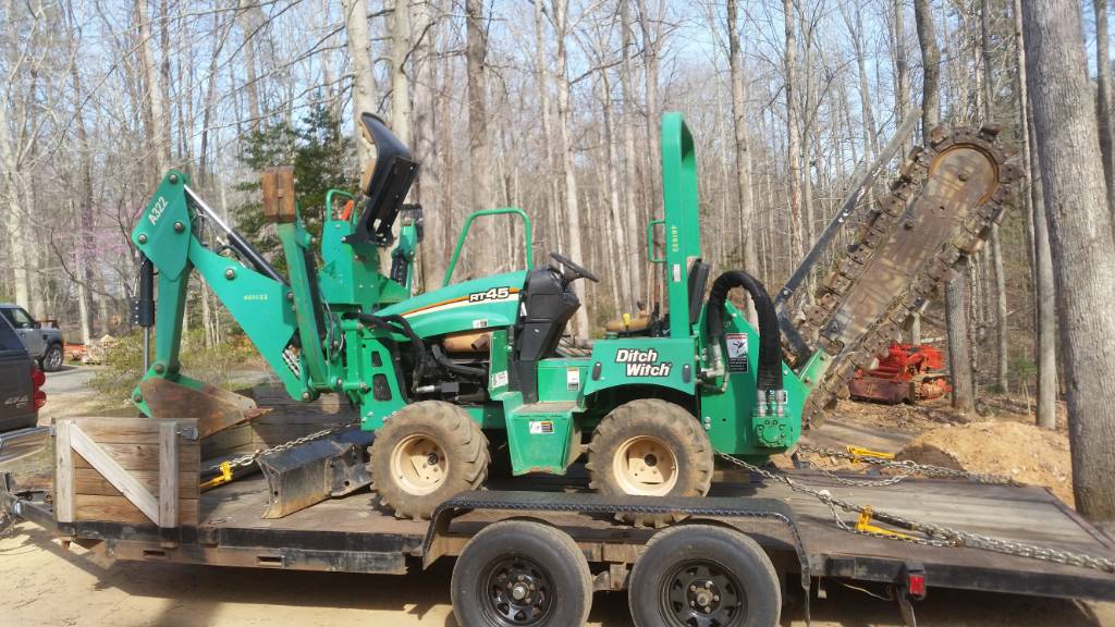

I was very lucky that a few years ago the power company ran 3ph right in front of my property as a back feed line to the lumber mill down the street allowing me to get 3ph at my shop.

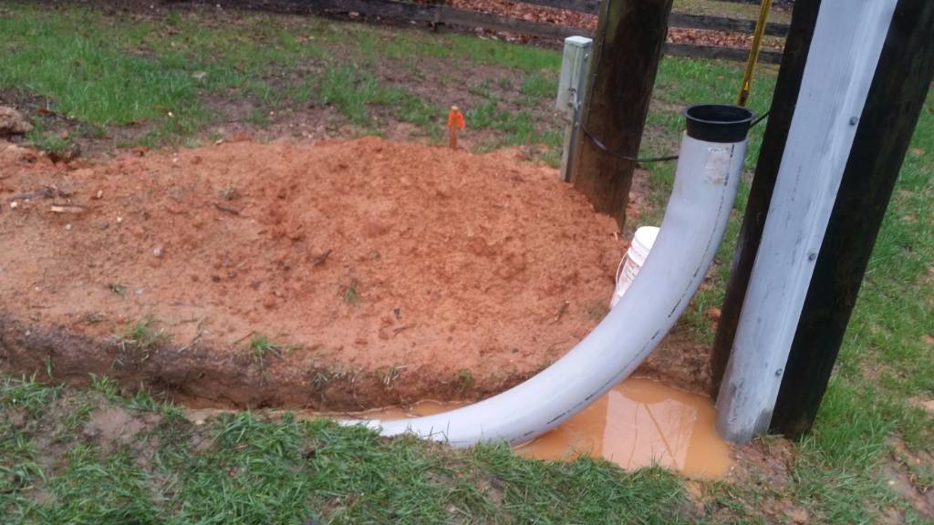

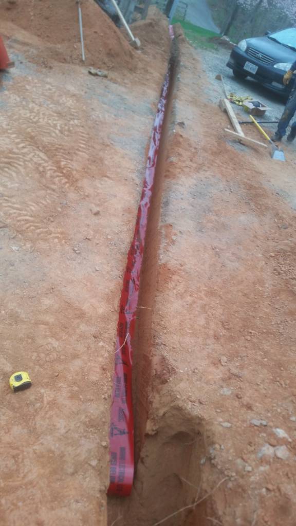

I decided to go with a 400a 120/208v service, unfortunately that required 6in conduit from the pole to the transformer, about 220ft, through the woods. I decided to just rent a 8" wide trenches to deal with the roots and rocks and I'm glade I did.
Even though I used the trencher I ended up taking my backhoe and opening up the trench to 15in everywhere but the driveway, so I clean out the bottom and have more room to work. Luckily the power co. Inspector was pretty cool and let me backfill the driveway without him there as long as he could see both ends. I would have never been able to dig through everything with my BH alone (sorry didnt get any pics of the BH work).

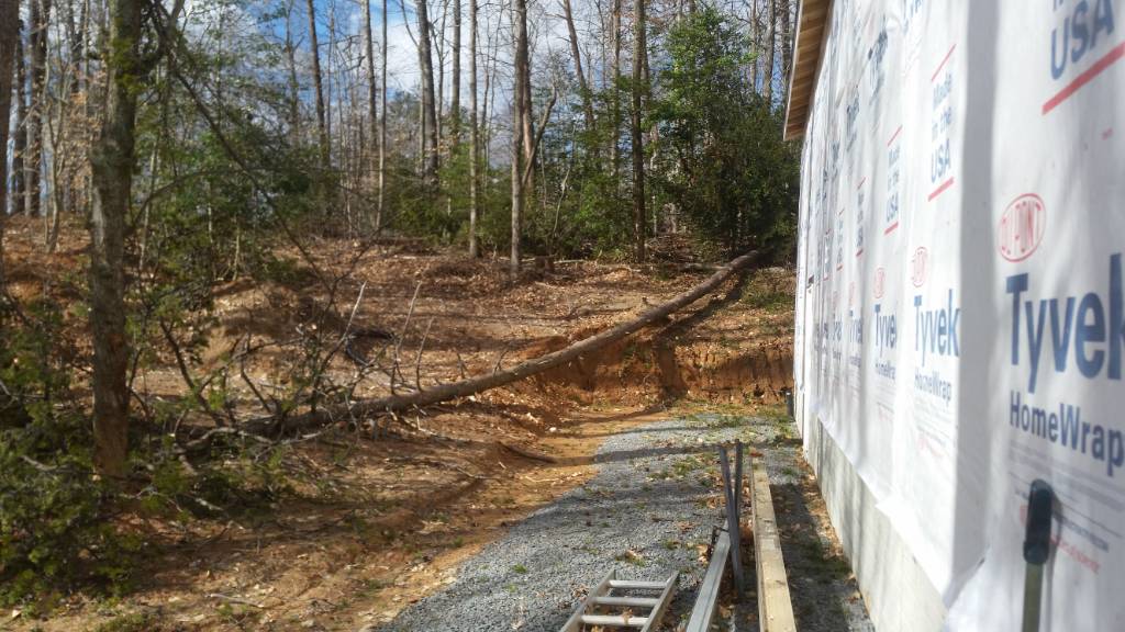

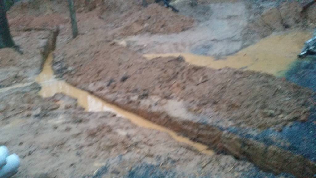

Of course the next day this happened........
the area by the pole with the 90 on it was floated almost 3ft, it was restrained at the driveway 20ft away, had to dig next to it with the BH so i could clean the trench under it to get it back where it belonged.
The other low area was 4ft deep and 15in wide, overflowing, took a couple hrs with a pump to drain it.

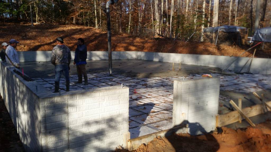

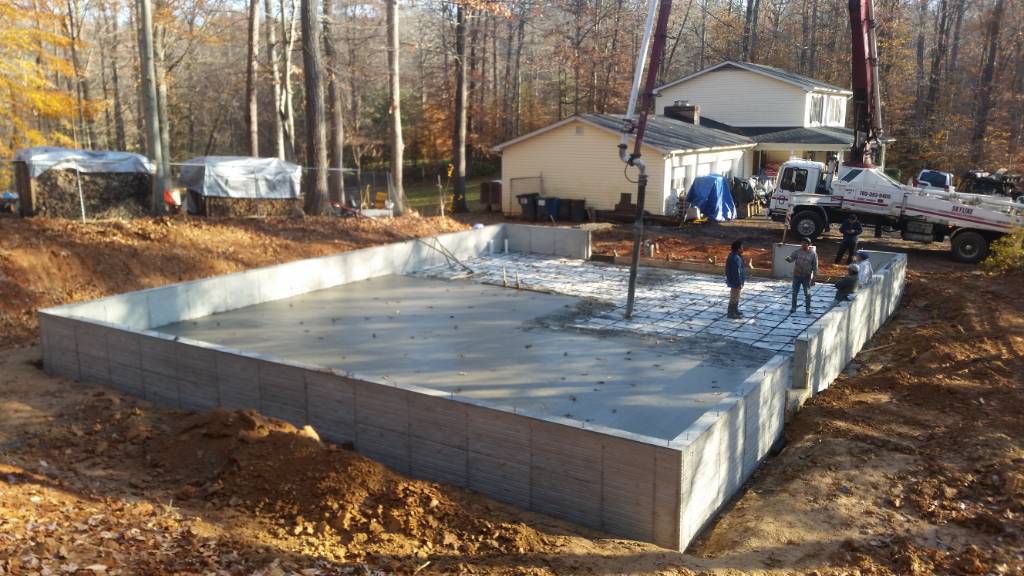

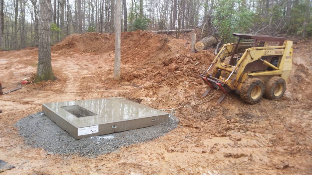

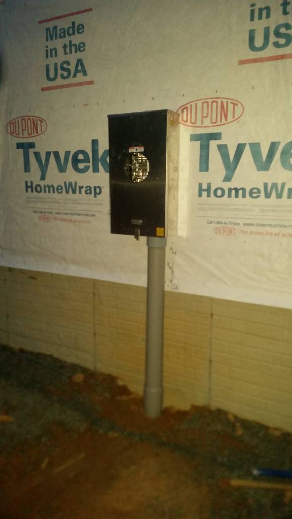

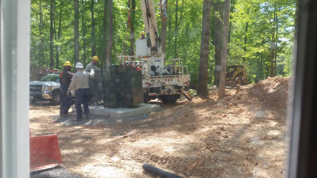

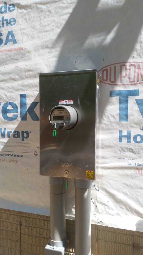

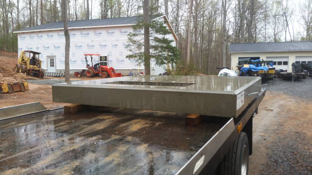

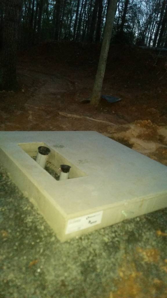

Next up was setting the pre-cast pad for the transformer to set on, after some discussion with the power co. design engineer, we decided to set the transformer close to the shop for minimal voltage drop since I am about 250ft from the pole. It ended up being a little closer to the shop then I was hoping, about 20ft, but I have really fresh electric
Luckily I was able to borrow a rollback to go pick up and set the pad as is weighed just shy of 7k lbs, this was the second biggest expense for electric after the underground conduit.1251531060.jpeg
Of course it was raining and the clay was like ice, ended up having to bury the forks on the skid steer to have an anchor point. For reference the pad is on top of the water filled trench in the previous post.765973852.jpeg
With the pad set and leveled I was able to get the stubs on and ready for the PoCo.
Finally the PoCo was able to come pull the cable and set the 75kva transformer. Then the ball was back in my court as I had to wire the shop and get my permits signed off before getting the meter installed...........883011389.jpeg

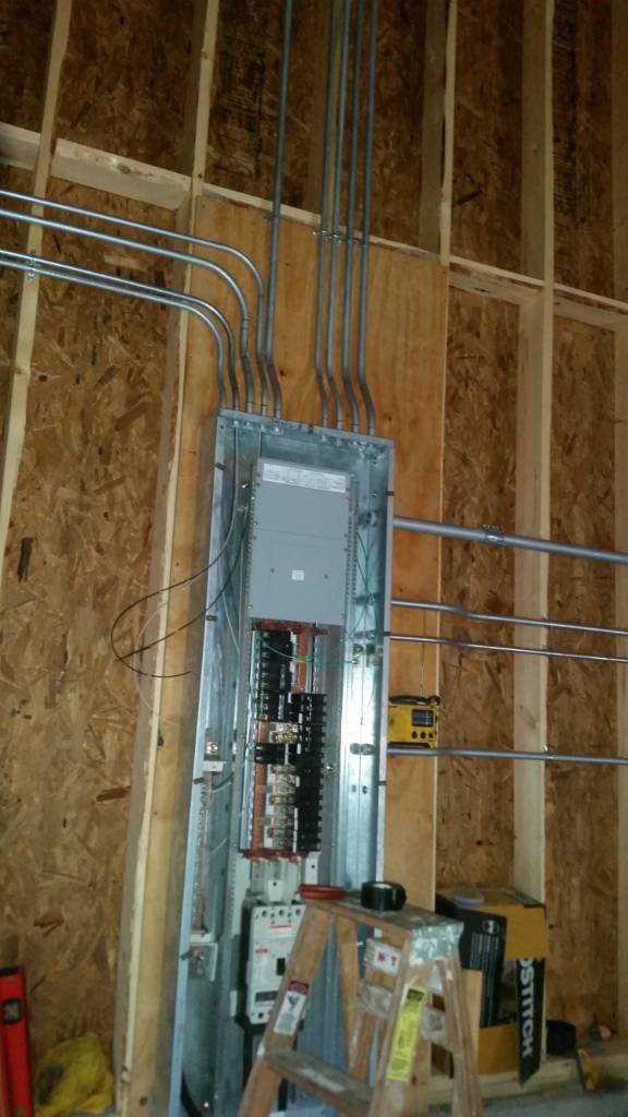

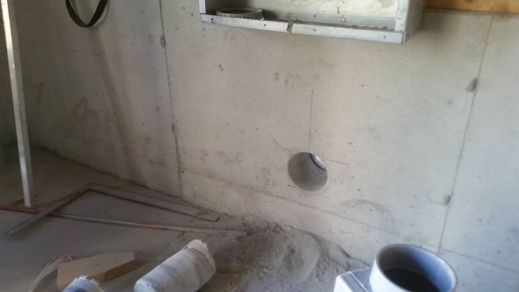

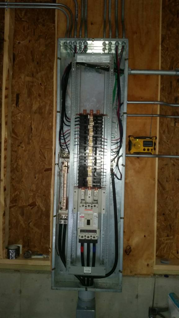

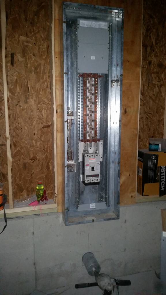

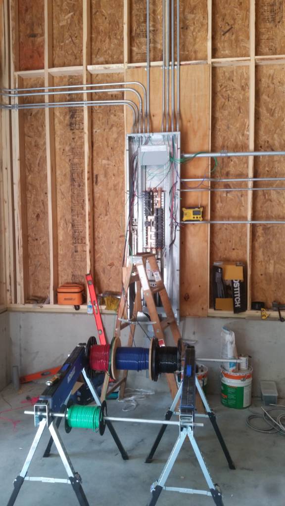

Electric being run, I lucked out and found a nice 42space 400A panel full of breakers for a great deal, it was an installed but never used deal. I wasnt able to use all the breakers but it still saved me a lot of money.630999219.jpeg

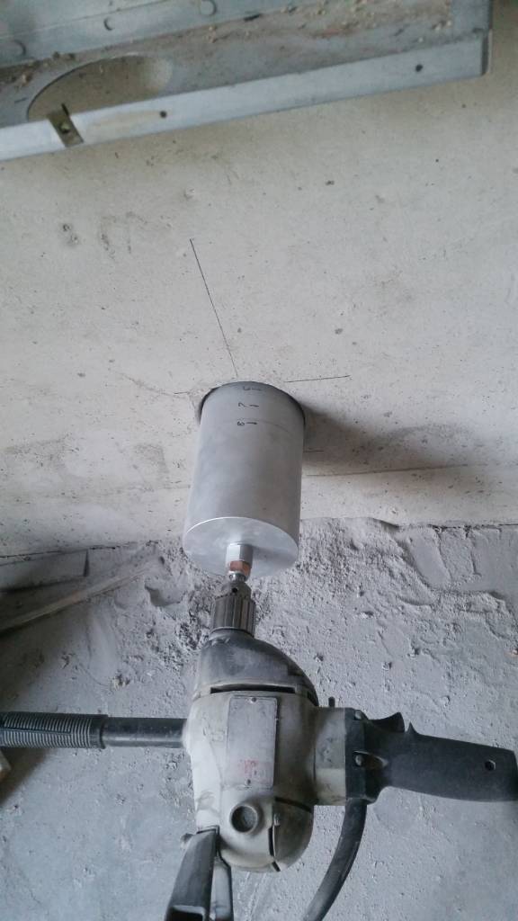

In order to run the service wire to the panel I decided the only clean way was through the concrete unfortunately, man talk about a pain! It definitely wore you out using a 5in core bit on a hand drill.1723284905.jpeg
Finally made it through the wall after about 3days of drilling, I used a 4in LB on the outside and inside to make the connections.641920567.jpeg

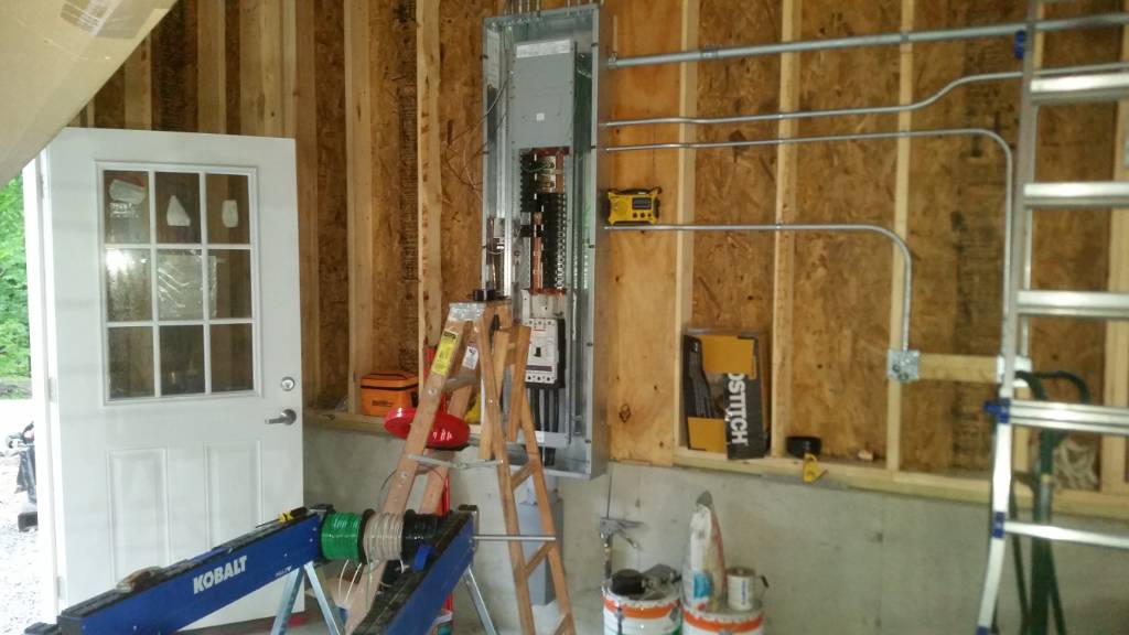

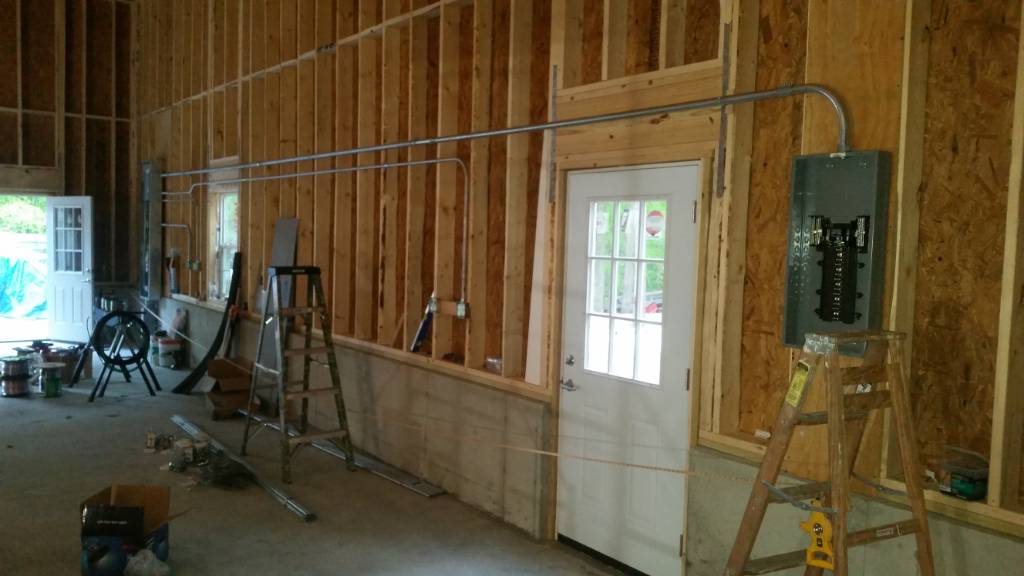

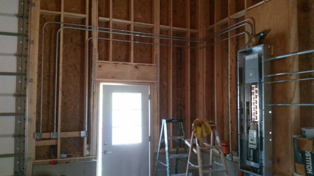

I chose to go the EMT route for running the wires (except the romex I used in the ceiling). Also added a 30space 100A sub panel to minimize wiring to the machine shop area and give me more space for breakers, 3phase really eats up panel space quick!1597553014.jpeg646182252.jpeg

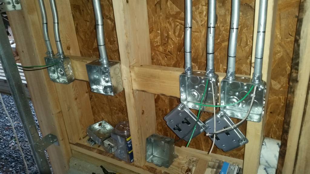

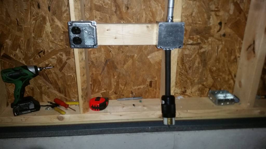

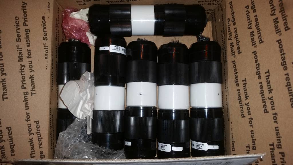

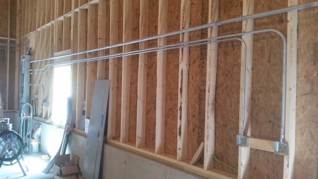

Lot more conduit run, all the electrical boxes installed. I decided to go with 50A twist locks for all the 208v stuff, used a small piece of SOOW to connect them to the boxes, figured I less of a chance of breaking off a connector that way.
Lucked out and found a bunch of like new 3ph takeoff twist lock pairs for a great deal, ordered 12 pairs and might get a few more while I still can.263687212.jpeg
Started pulling all the 120v wiring.380910957.jpeg2035735381.jpeg1261888350.jpeg
Next up was pulling the 3phase wiring, not as fun but not bad since I used 3/4" conduit.1785127595.jpeg

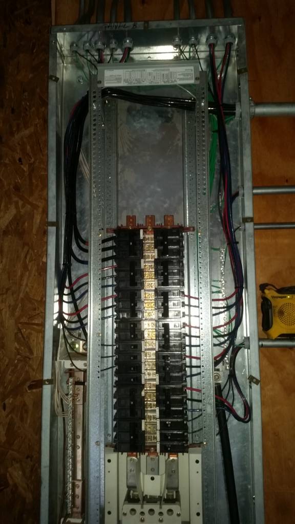

Box all tidied up, I'm not an electrician by trade, but I'm pretty happy with the way everything turned out. Definitely learned a bit about bending conduit, I have a little pile of scrap to prove it 16245109.jpeg1182346575.jpeg
/ TMGT's shop build #49
You might not be a professional electrician but those bends on the conduit are a **** of a lot better than some I seen done by people that call themselves pros. When running wire in pannel keep same discipline as running conduit p.l.s. helps to keep from getting the spaghetti look . But overall nice and neat.:thumbsup: Don't want to be captian obivious but a always try to put plugs in form work for electrical and plumbing before you pour . Core drilling vertical walls suck. Hindsight is 20/20. I have the same black and decker drill they don't make the like that anymore . I was always worried about that toggle switch looked like a catch all but after 30 years never had a problem with it. Its definitely a wrist breaker .:drink:
/ TMGT's shop build #50
Looks great!!!
I think if you enjoy running conduit it turns out looking good. If not, it doesn't. You obviously enjoy doing it.

Thanks guys, I try to stick with the "if you're gonna do something, do it right".
Spitter, I know what you mean about hindsight, the problem here was a last second change on the concrete which made the stub wall 1.5ft higher then originally planned which is why it ended up where it did.
Because of code, I was limited on the max height of the breakers, and with the large size of the box, I was limited on options. I had a few different ways I could have gotten around drilling the concrete, but I wouldn't have been happy with them so I chose the hard way, but at least it came out the way I wanted.
I really like how nice and neat your lines are, but I'm curious as to your reasoning for running conduit instead of going through the studs?
Are you going to insulate your walls?
Are you going to cover your walls with something like sheetrock or plywood?
I plan on insulating and covering with painted OSB. With the surface mounted panel and being a shop where I will most likely be adding/moving electrical as needs change, it just makes it easier to run conduit. Since I'm running a lot of 3phase wiring it also ends up being cheaper and easier to run THHN which allows me to use a smaller gauge on the higher voltage runs.
Probably not as much of a savings for the 120v runs, but I think it just looks cleaner, plus thing of all the stuff I can hang from the conduit............

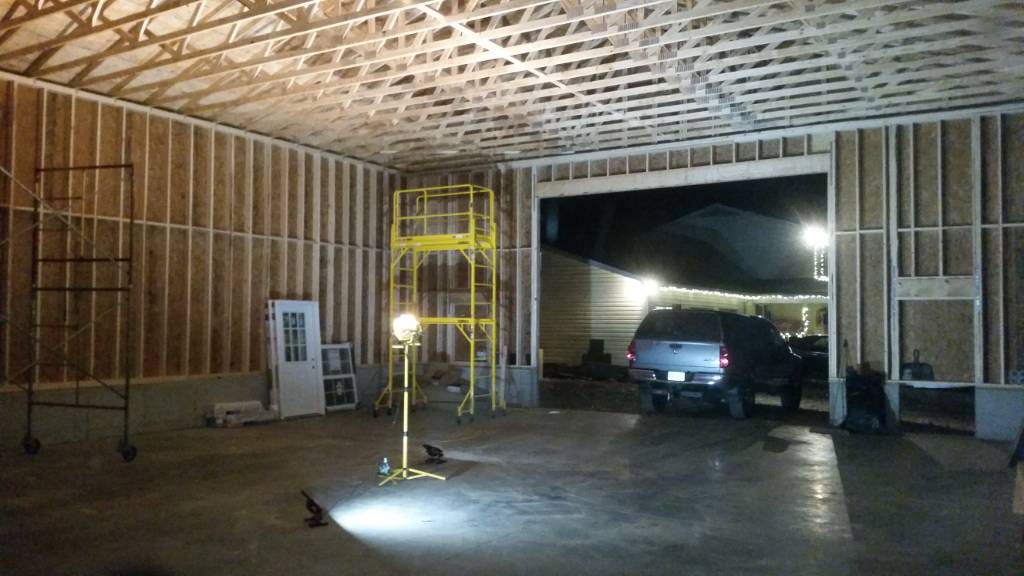

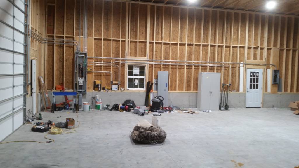

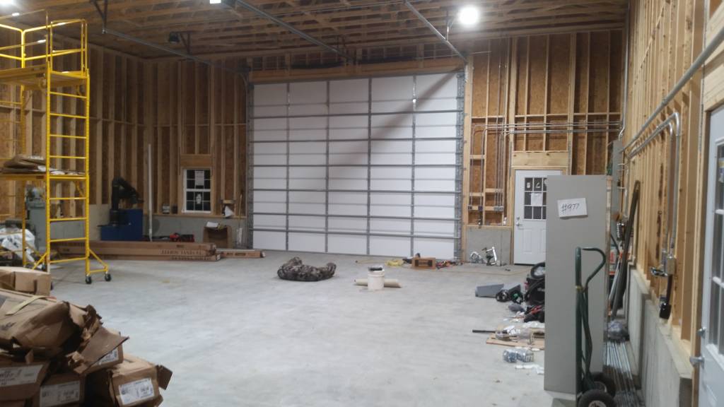

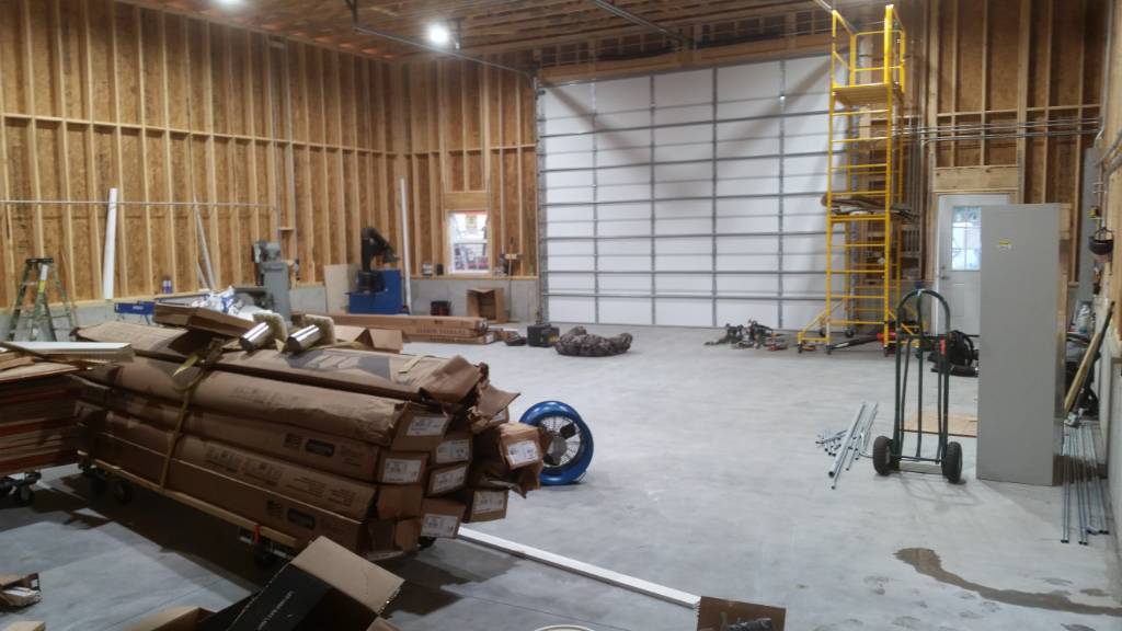

With the minimum wiring done, I was able to get my permits signed off on (after a few minor changes......) which means.......power!580494948.jpeg
For lighting I decided to go with 8-150w LED "UFO" style high ceilings lights, I placed them in a even spaced grid in the first 40ft of the shop, the back 10ft will be taken care of later. (The 9th light in the front-middle was omitted due to the garage door blocking it when open)643918357.jpeg2058572153.jpeg
I have the lights divided left and right on separate switches, so far I like the way it's set up. Very little shadowing, although I will probably put some 8ft LED single bulb tube fixtures going along the wall lower down to help fill in.851032750.jpeg

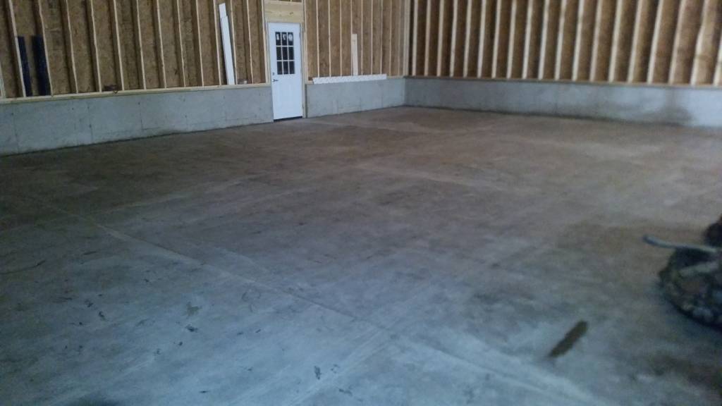

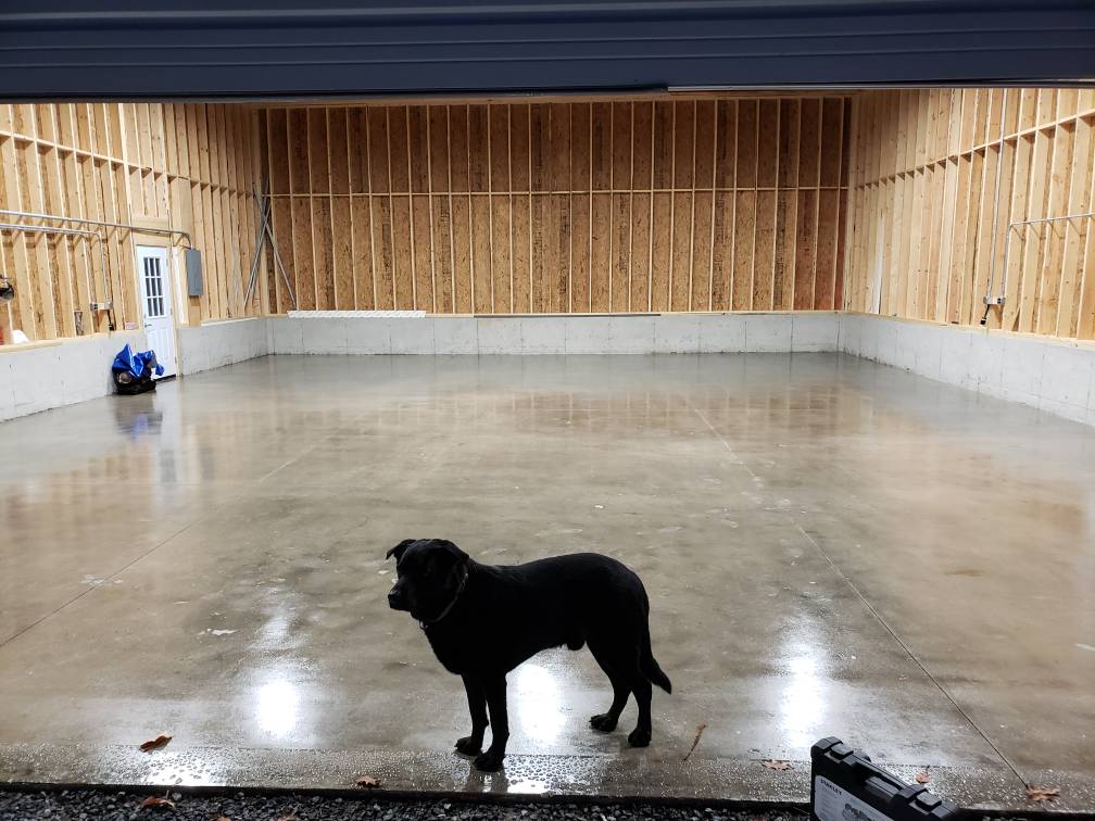

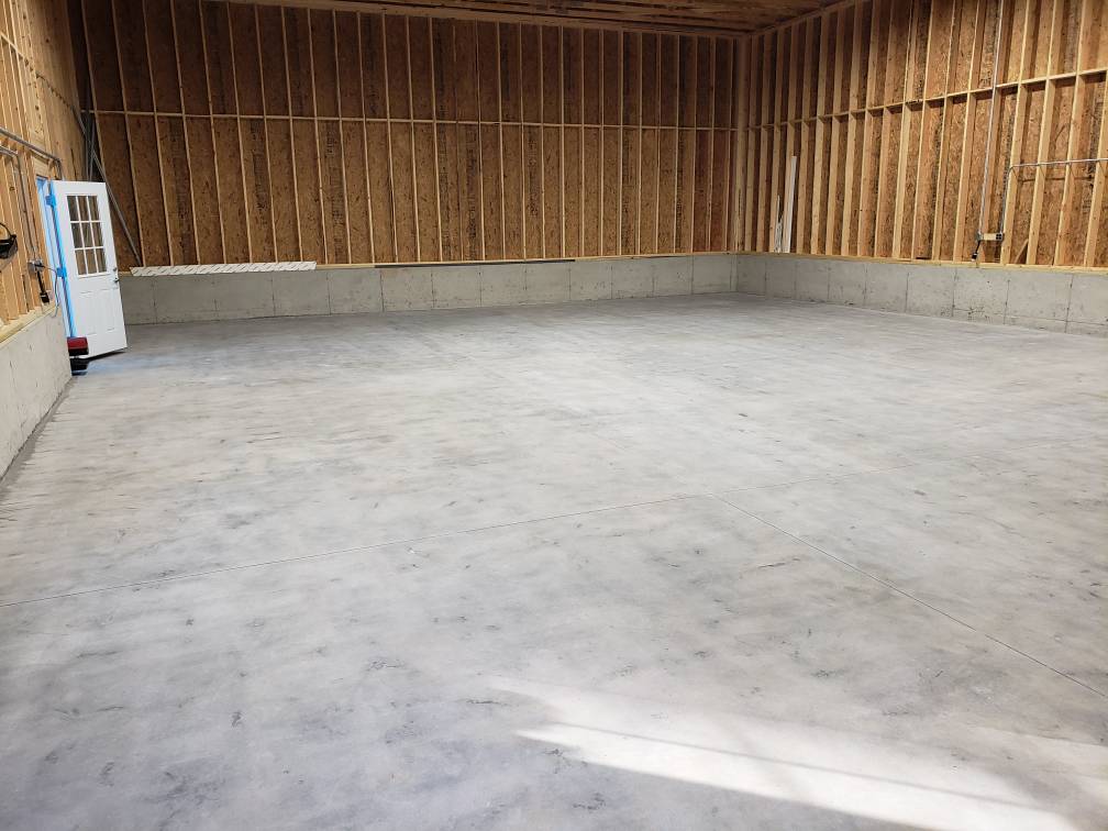

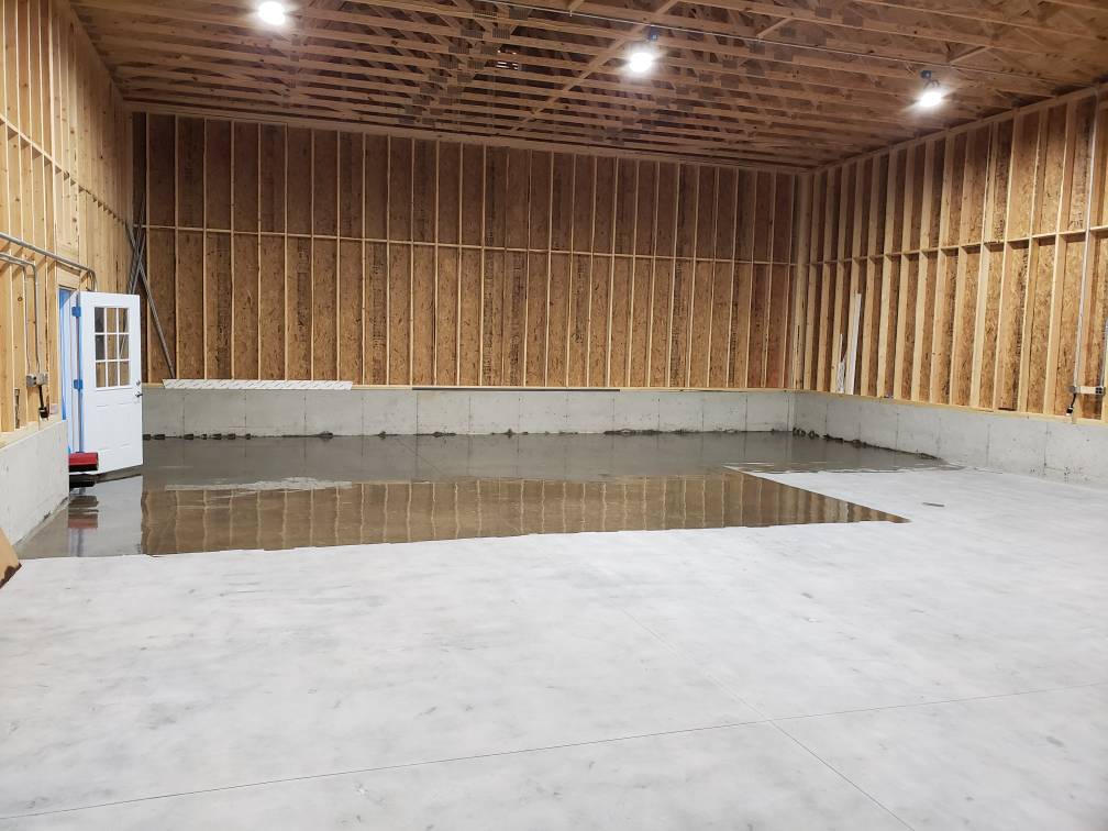

Gets me a little out of order as I slacked off on doing the floors, but the concrete company gave me some filler and 10gal of Super Diamond Clear because of some of the issues with the floor.
I wouldn't recommend this for a shop as I found out the hard way it doesn't have a great chemical resistance to things like brake clean, acetone, gasoline etc.
It does hold up well to diesel and oils which is nice.
The sealer going down, I used a cheap HF backpack sprayer to spray it, didn't work great because of how thick it was, ended up using a roller to even it out anyways. If I was to do it again I would pour and spread.1267990594.jpeg
All cured, of course I did it in the winter and had to have 2 torpedo heaters going to keep the temp up long enough to cure, hard to do with no ceiling or insulation.2022163951.jpeg
