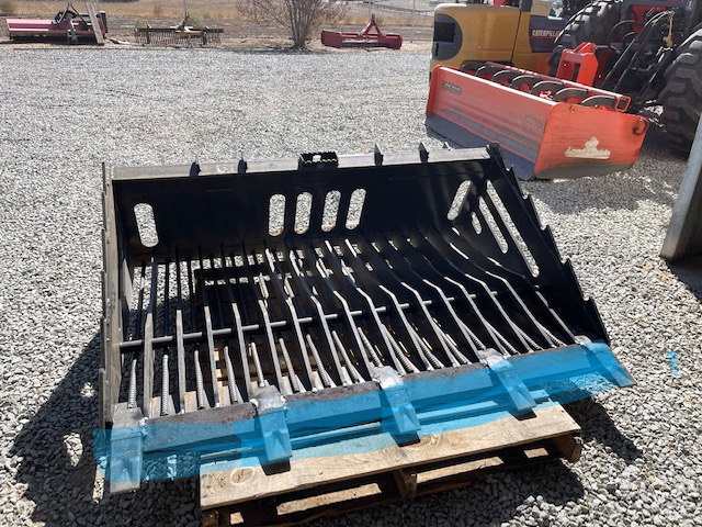

If you were trying to improve how much material you are scooping each time here... You were on the right track .
Instead of welding the cutting edge between the teeth, weld across the top of all the teeth. Like shown in the blue highlight . A common straight plow edge like goes on a box blade would work fine
Common mod done to excavator buckets with teeth
   / Titan skeleton rock bucket mod
#33
View attachment 770056View attachment 770058
By golly I think yo Sir are right. Maybe should have used this approach
