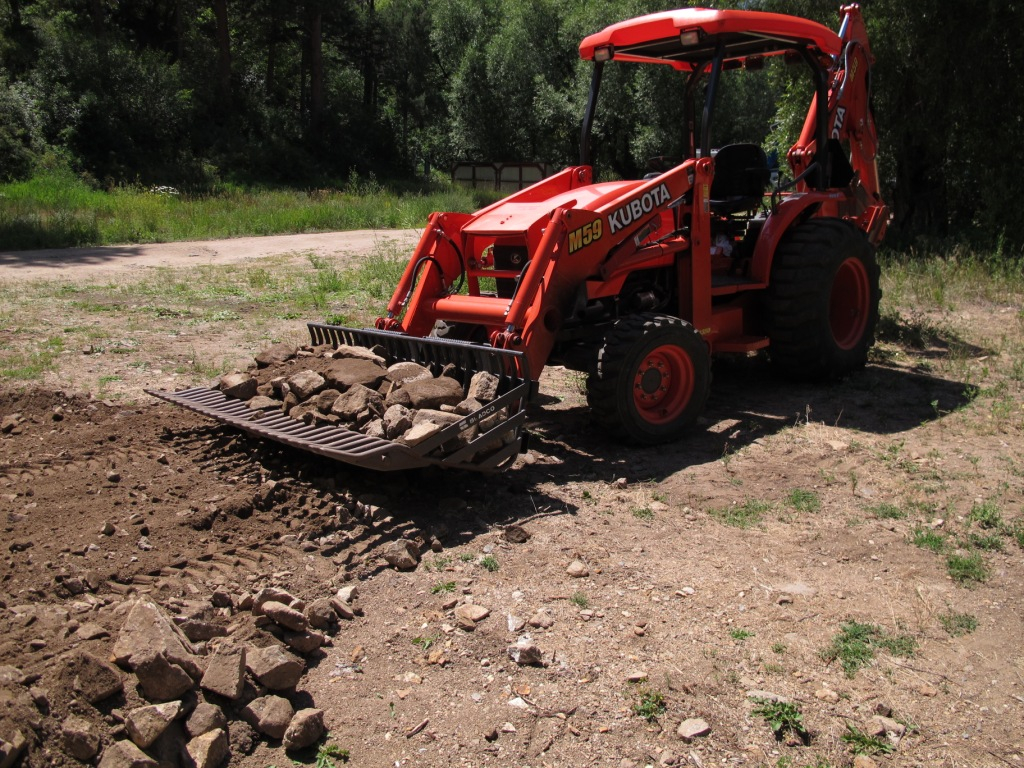

/ Titan skeleton rock bucket mod #4
We had a lot of rocks to move so I bought one of those inexpensive flat tine rock bucket with 3" spacing. Several companies build exactly the same design. It looked good and was stout, but didn't work well. It didn't do anything well. It let biggish rocks fall through and yet it tended to "clog up" and not let the dirt fall through. The flat tine points were hard to force under rocks & then didn't move them to the back or lost them off the front. This is all on a pretty heavy tractor with enough HP.
About a year later I saw an adv. for what looked like a different design of rock bucket with longer Round Tines more closely spaced (2.25"), better tips, and a different way of holding rocks in. Also somewhat heavier construction. Not perfect, but it works a thousand percent better. Also costs more. Like the Flat Tine types, several companies make the same bucket. So I bought one and sure enough, it is a lot better. It also has better visibility - though that may vary with the tractor.
I guess my conclusion is there isn't much difference just looking at the flat and round tine buckets. But they sure work differently. The round tine bucket is so useful that I tend to leave it on the tractor. It's long enough that I can see what the front end is doing. That's real handy.
rScotty
1_Typical Flat Tine Rock Bucket.jpg2_Flat Tine Rock Bucket at work.jpg3_Typical Round Tine Rock Bucket.jpg4_Round Tine Rock Bucket at work.JPG

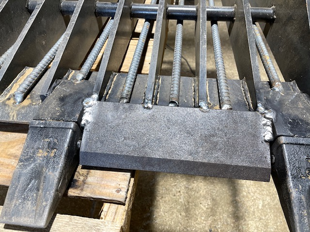

#9
I cut up a smooth replacement edge and welded the pieces in between the teeth. It is better but it's still not perfect for my use.
But it did help significantly. My advice is if you are trying to pickup rocks on hard ground get a smooth bucket. No teeth.

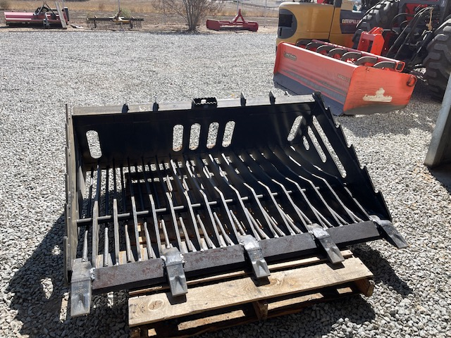

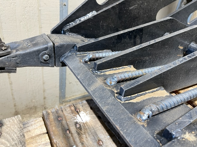

Here's what I did with my Saturday am.
In picture #1 You can see how they built it but with my rebar added reducing the spaces 50%.

/ Titan skeleton rock bucket mod #10

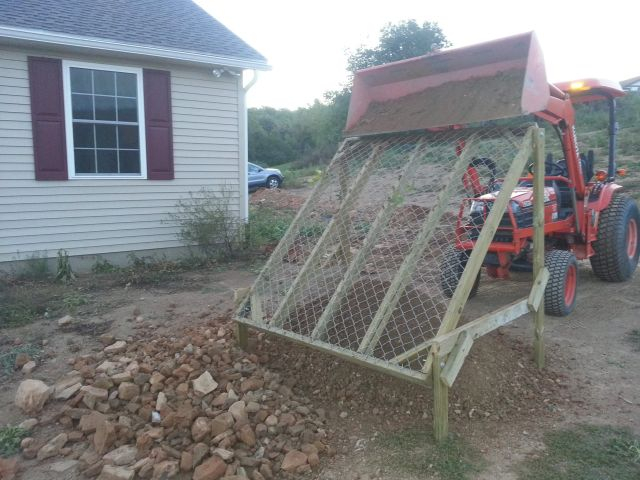

Usually a "grizzly " works for me as the cost of a rock bucket in out of the picture for my needs..... Not mine but something similar works for me...
/ Titan skeleton rock bucket mod #16
Thanks for posting the photo of that grizzly. That looks like about as simple and strong as one needs to be. If I ever get around to building one that design is a good place to start.
I wonder why they are called, "grizzlys"?
