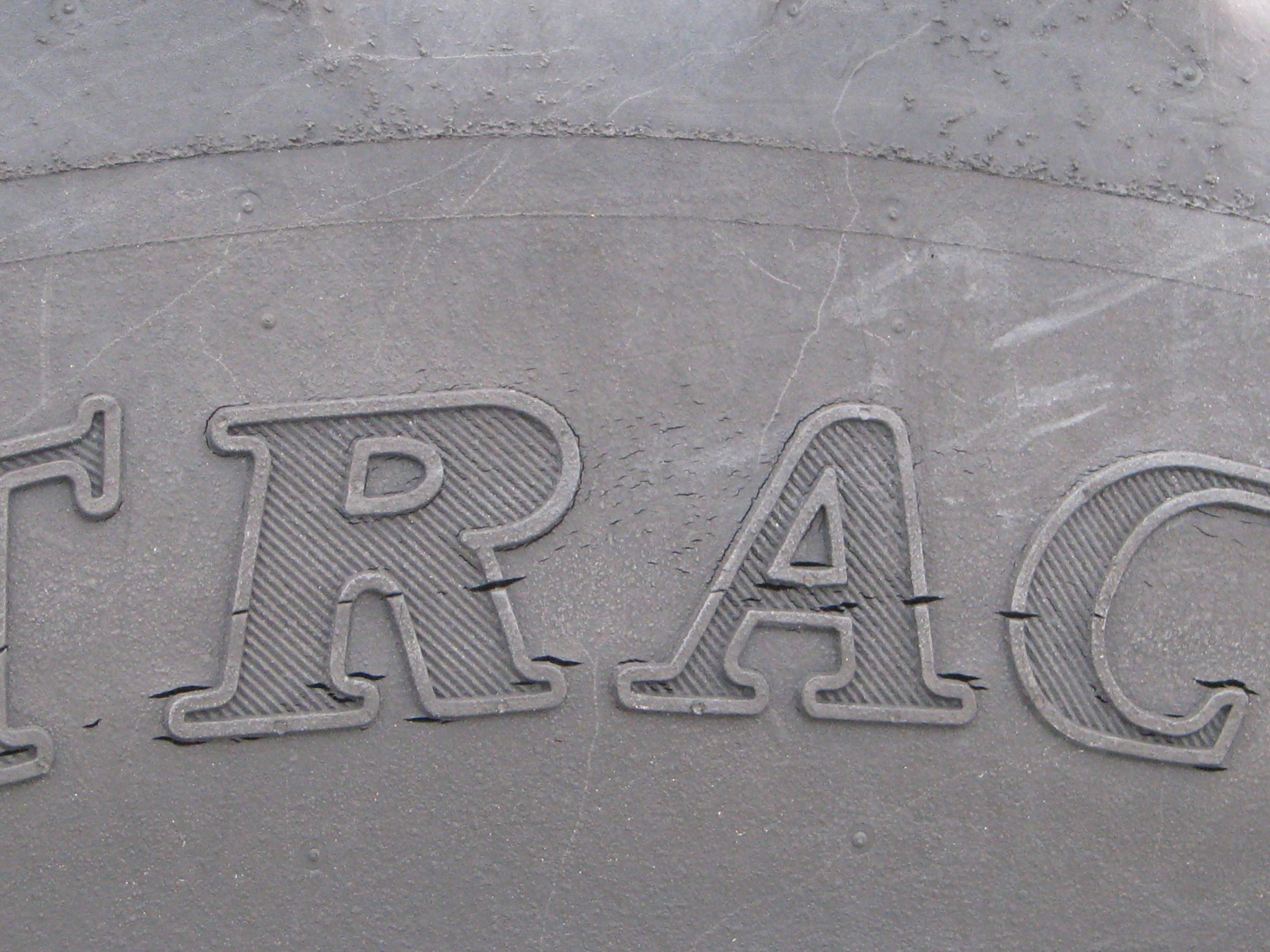

How would you feel about cracks like this? This is a front tire, the tractor has about 50 hours and was purchased late last summer.

The grains in the rubber in that photo look to me like they are using recycled rubber in thier tyres (left click on expanded photo) . It makes good floor mats for horse trailers but would be no good for tyres (if that is what they have done).
