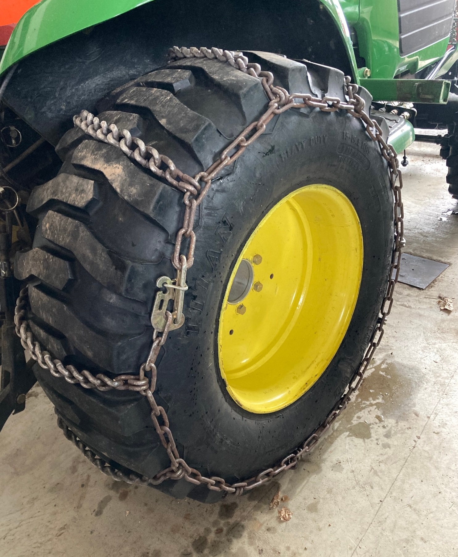

The snow we have recently accumulated was wet and about 10", so after several years escaping the need for throwing on the tire chains, yesterday was the day. Went on easy and made a world of difference as the wet snow left a layer of ice that didn't provide good traction.
Another 8-10" coming next two days, they say.

If your tire lands on ground in between the chain latters, you could still end up in a pickle.
/ Tire chains on tractor tires
That doesn't happen. The next cross link doesn't so you don't just sit somewhere and spin. ;);)

Never been a problem in the last 25 years using these chains. Appreciate your concern tho.
Not necessarily. The tire will only spin until the next cross chain comes around and contacts the ground. 4-link chains still offer a good traction enhancement compared to a bare R4 tire. In some ways I prefer 4-link chains to 2-link chains.

I've seen 2-link and 4-link ladder style chains before. This is the first time I've ever seen 5-link chains.
Calling my chains 5-link chains? Didn't know that distinction between chains, but now see what you mean by 5-link. Has not presented a problem. Benefit might be they are lighter to carry and lay onto the tire, as well as pick up and hang on the wall. Win win for this old man. ;);)

I had V-bar tractor chains when I had my first tractor - Ford 1700 4WD. They were exceptionally heavy and difficult to install. They had 3X the cross links as the OP has pictured.
They rode like a COB - but gave exceptional traction.
Those were most likely 2-link ladder style chains: the cross chains are every other link (a cross chain, a gap of one link, then another cross chain on the second link). 4-link ladder-style chains have a cross chain every fourth link (a cross chain, three empty links, then another cross chain on the fourth link). Those two set-ups are the most common for ladder style chains - mainly because the side chains "line up" better if you have an even number of links.

4-link ladder chains with V-bars (not mine)
Odd numbers put a slight twist in the side chains in order to connect the cross chain. I'm not sure this makes any difference on the life of the chain or the tire. Beenthere certainly seems happy with his 5-link ladder chains. If you don't need the extra traction of more cross links, it certainly makes them lighter.
