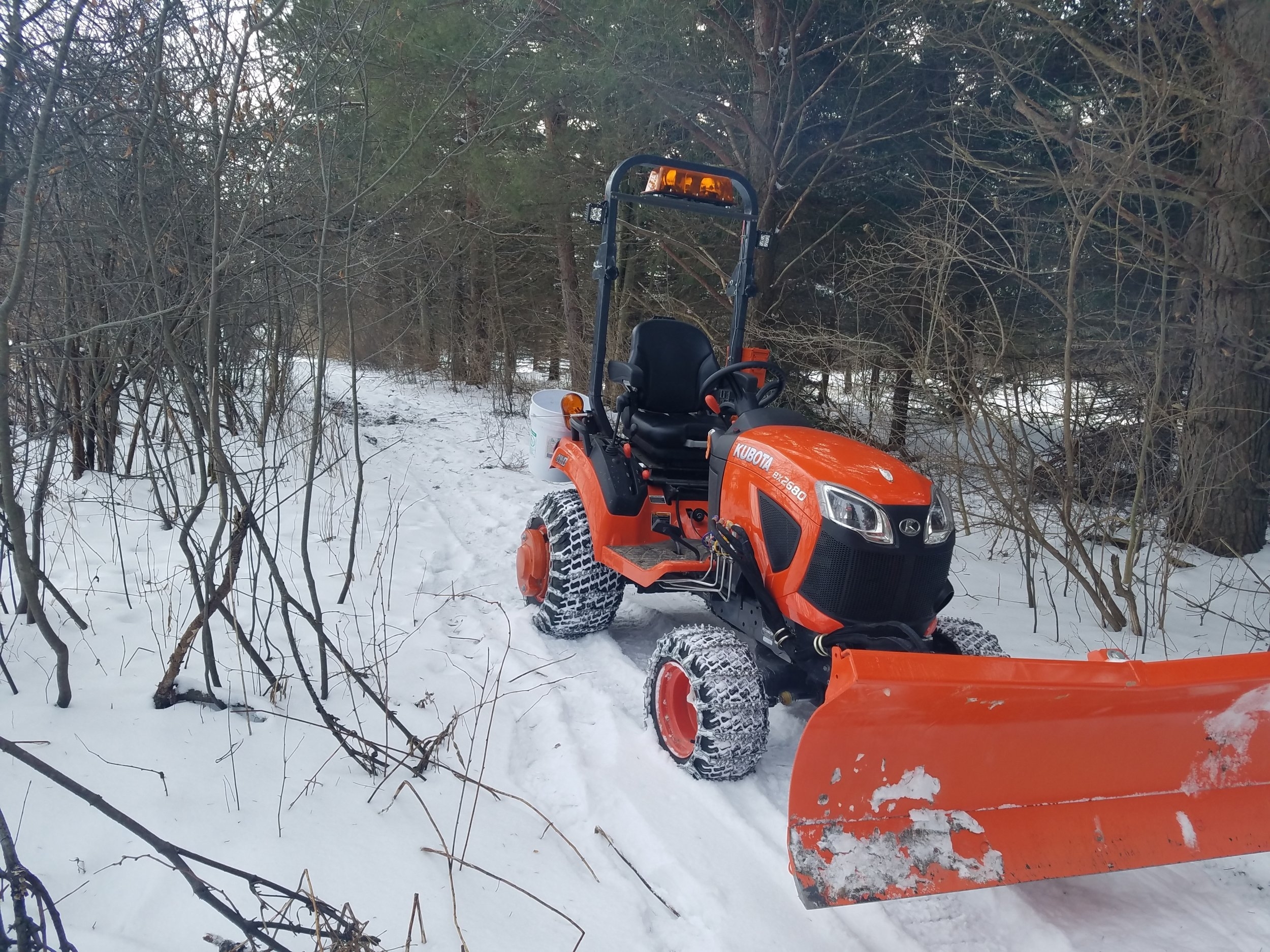

I have always run chains on my smaller tractors. They make all the difference in the world.
Ladder chains on a turf tire are a match made in heaven.

You know how to fit chains to a tire. No need for hanging bungy cords and springs on the side when the chains are fitted to the tires. Good job. (y)(y)

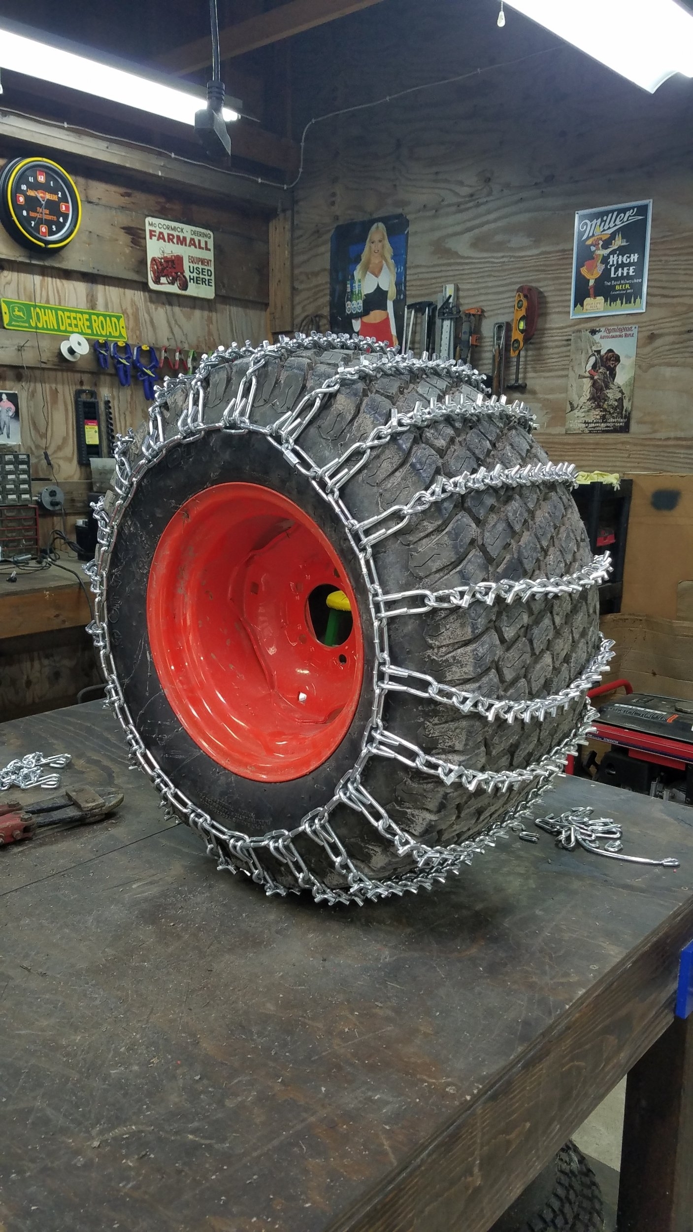

Thanks, it's not easy, but they aren't going anywhere. I wouldn't be able to do that for my JD4320, but I have not needed chains for that.

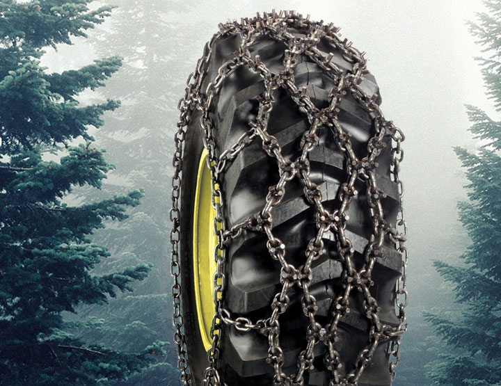

Ladder chains, especially with 2 link spacing do an adequate job as far as traction as far a securing your tractor to the terrain they do not come close to Euro style studded chains.
I have used most styles of tire chains, from the double ring and duo grip, the v bar reinforced, the square link chains, two link spaced, and 4 link spaced, the studded Euro pattern chains are the best ones I have bought, the multiple diamond ones look to be even better.
I would like to try a set of these,

I’ve used V-Bar ladder style, V-Bar Duo Grip, and now the studded Euro style (same style as what Lou is using) - all on the same tractor with the same tires used with all 3 styles of chains. I agree with Lou: the Euro style are by far the best for my use (and also the most expensive).
I’ve never seen the multiple diamond type in a size that fits my tires. They are similar to what many skidders and other logging equipment in my area use. In addition to the traction, they provide pretty good protection for the tires when working in rocky terrain

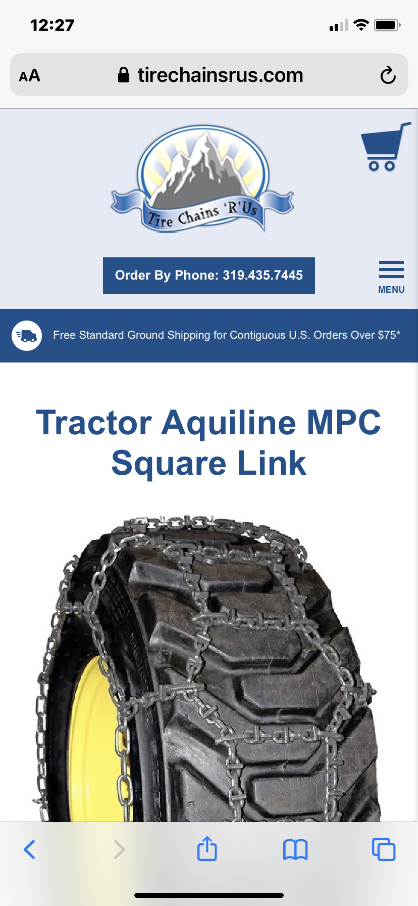

I bought these specifically for clearance issues. Highly recommend them for that application.

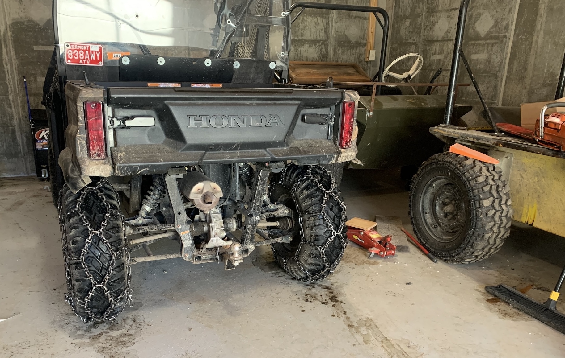

I put a similar patter square link chain on my Honda Pioneer 520 UTV. I wanted some traction for plowing snow, but was concerned about going with studded, since I did not want to tear up the paved loop of driveway. It's been working well so far.
