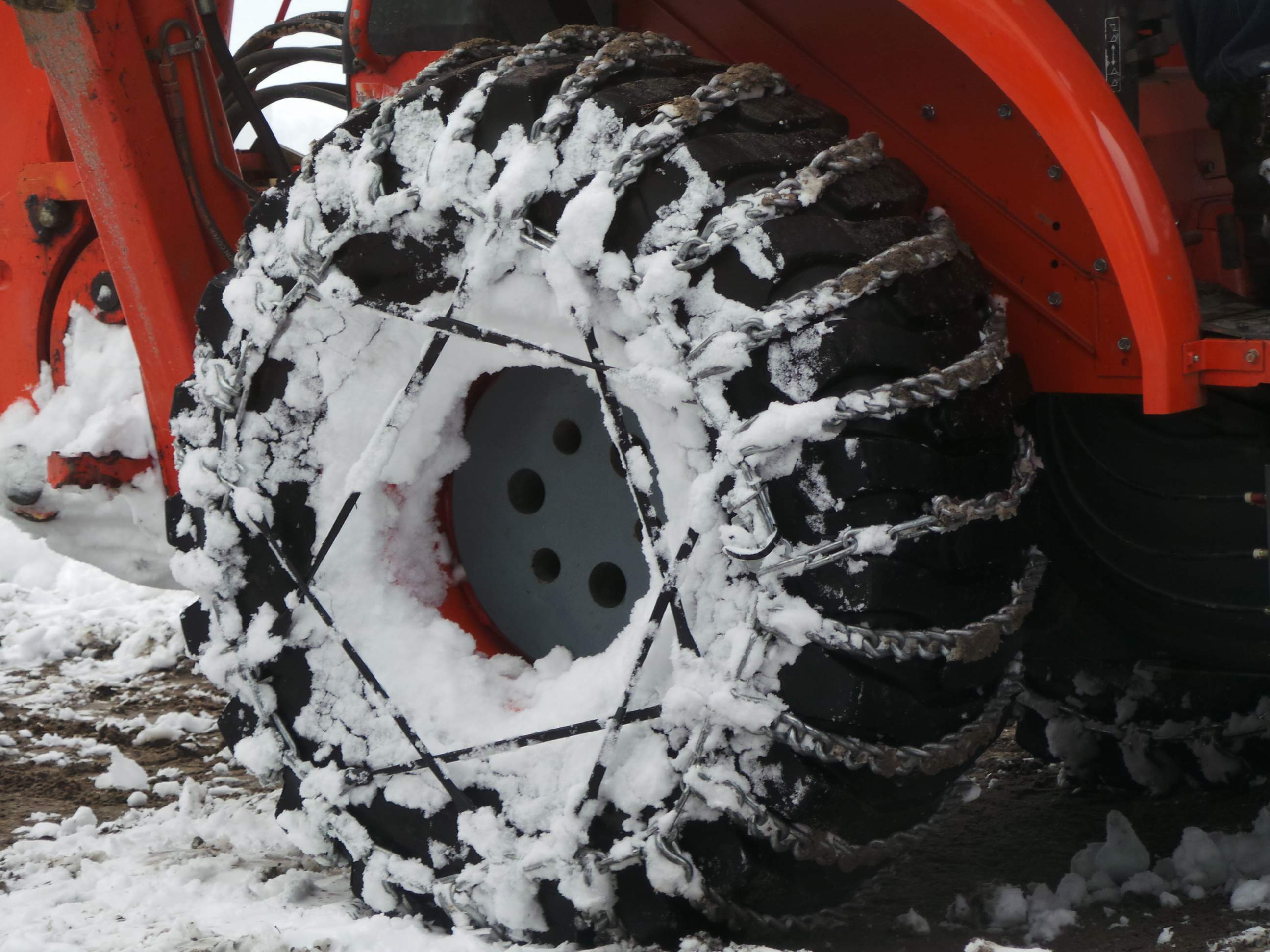

Search my threads about chains on L48s. Not impossible, but pain i the arse. Here is one of mine chained up:

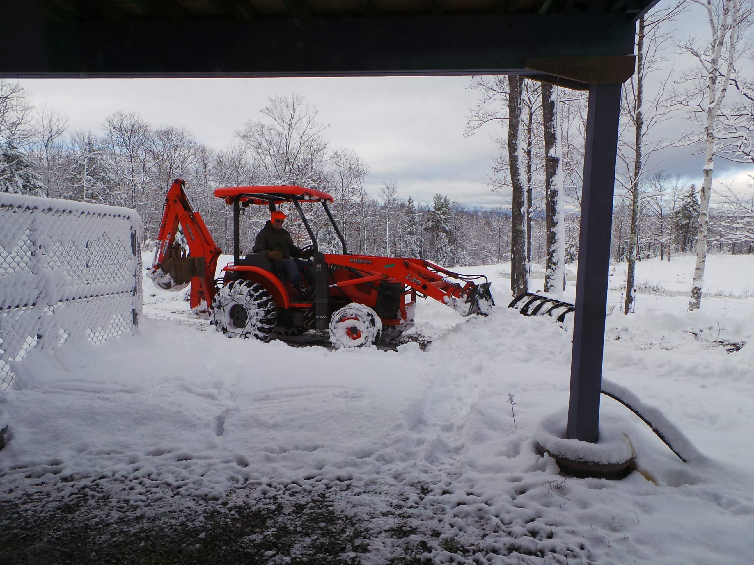

No it will not workwithout at least another inch spacer.
Kubota sells the long wheel studsseperate. have a plate cutting shop with a plasma cutter make you a set of spacer/ weights The stud holes can be key-holed, they do not have to be a circle, you can get weights spacers all it one.
M59 has a stout front axle, so you can get away with front chains like the Chain & Wire Rope | chains, call them ask for Rick.
