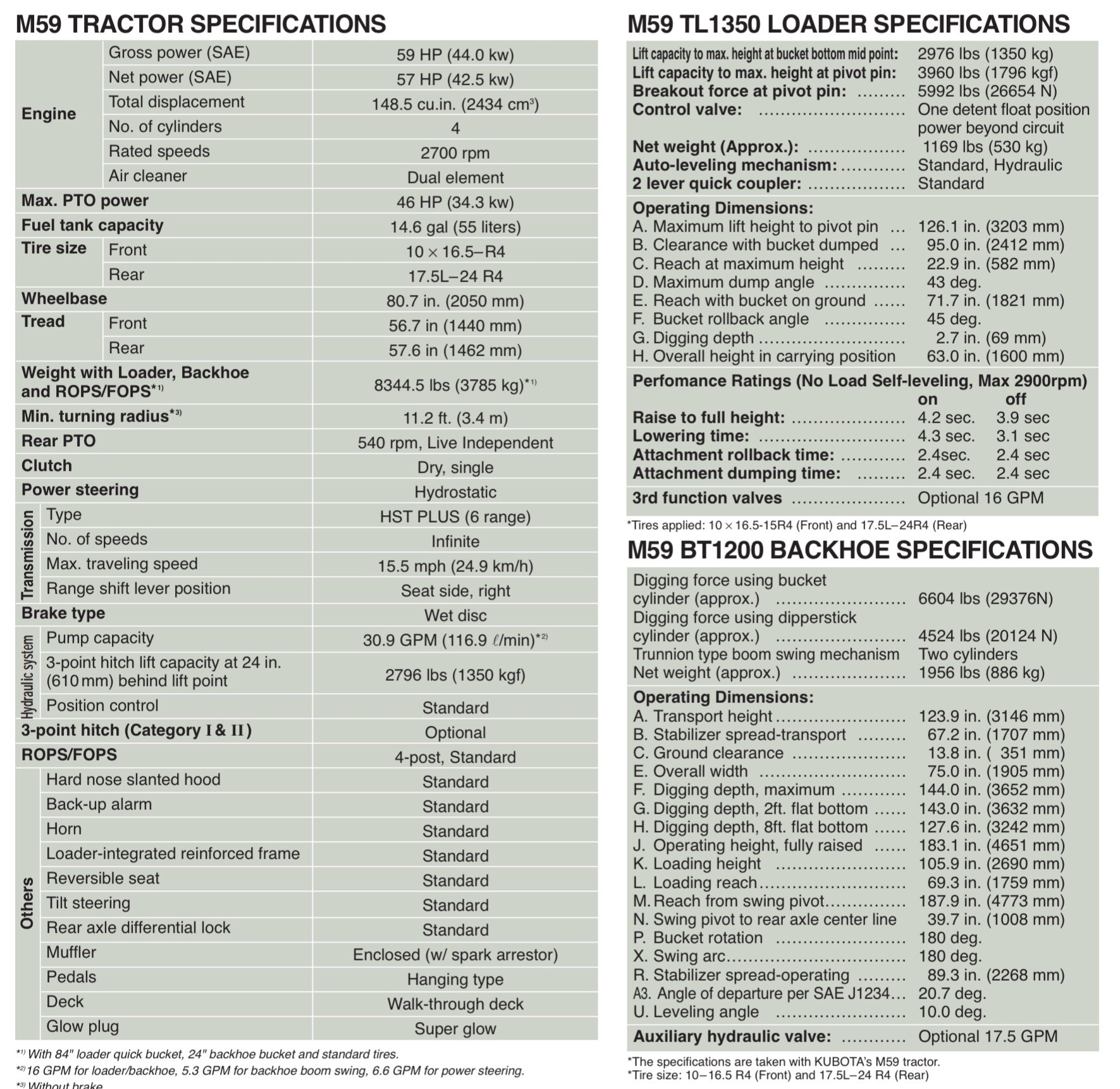

Not one to argue with answer directly from Kubota customer service, but I thought the front axle max load was a bit light in their response since each wheel, at 4140 Lbs, can almost fully load the front axle with max rated load of 4410 Lbs. The M59 loader max lift is 3968 Lbs at pivot pin so add in some front end weight from engine and your at the 4410 Lbs.
Guess 10 ply is more than sufficient and I'll be making sure I always keep the machine greased to minimize wear and tear.
I think I will argue. I think we should use worst case conditions rather than max axle load rating when figuring how to prevent tire & wheel failure. Kubota's rated breakout force is a higher number. Breakout is 5961 lbs. Combine that with whatever degree of side slope it sees, and that is your wheel and sidewall stiffness requirement.
My own opinion - not from any calculations - is that the Titan HD that Kubota uses is an excellent premium tire even if it only has an meager 8 ply rating. It performs so well that In 20 years now, failures like yours are rare.
But your use miles back in the woods with a grapple puts even more force on the rims. If I was doing that type work or using a different brand tire I would go for a higher ply rating...especially since I like to run fronts at less than 60 psi.
YMMV,
rScotty

Kubota Customer Satisfaction just replied back to my email to them from earlier today so I'm posting it for those with the M59 machine.
Here is their contact info if you want to go that route
https://www.kubotausa.com/contact Then choose “Send us your question”
My Q to them:
Please provide information on front axle load rating for M59 TLB? I've looked through Operator and Workshop manuals and found no info on front axle rating. I’ve contacted my local Knoxville dealer with no result.
Also looking for front wheel rim ( size 16.5 x 8.25 by 8 bolt ) load rating so I can choose between 10 or 12 ply tires to match rim load rating.
Their answers:
Thank you for contacting Kubota Customer Satisfaction. I have included below the information you have requested.
  • Maximum permissible front axle load--lbs (kg): 4410 (2000)
  • Kubota tests wheel and rim combinations. The combo we market uses a Titan 4393D1 Tire on a 16.5 x 8.25 rim with a max load rating of 4140 lbs @60 PSI. The Titan 4393D1 is an 8 Ply.
Kind Regards,
ADKq_NaHEsqyyfrfAzYwp2wivTpje7IHhtLamUb0ooR5bMJbC-HzX7tYA7RgIKR2j4dQi2Uogfc-_3u6TRU-S04vFTrhTiaruYLh8ga_gHJ_wDavTcIGlG7mhemI23C7aK-uxH8OEMOy8SRW_1wZKLUugdKHGwCr_YdleOED4i8za-rrijiNf7Bq_eKnvSg=s0-d-e1-ft
Sounds like the TLB at 8,300lbs the front axel is at it's max load rating before adding another 3,900lbs load on the bucket pins.
With my ~1,200lbs cab I'm way over
