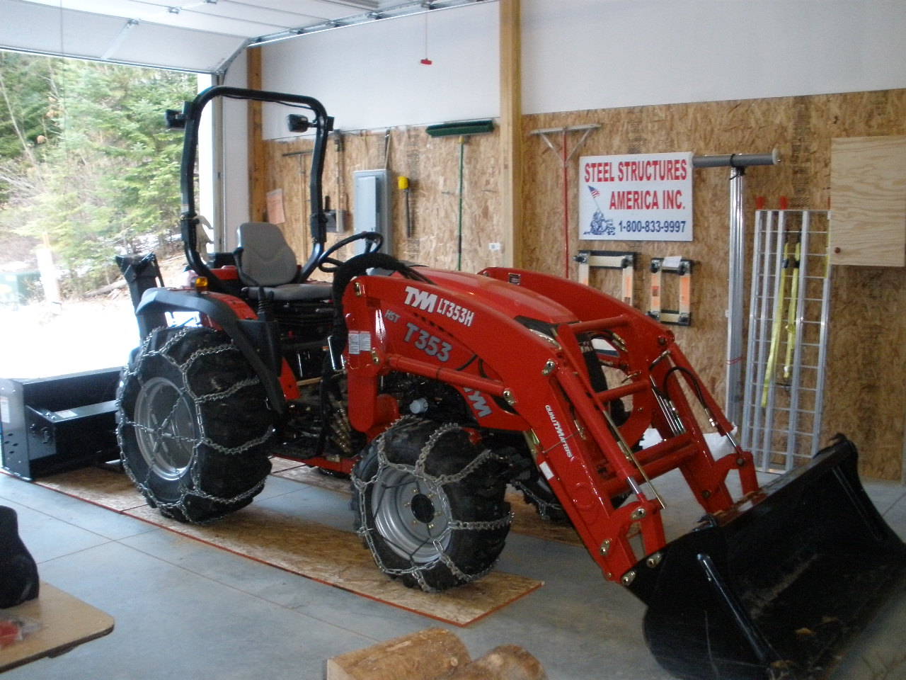

Another vote for tirechains.com, I use rubber tensioners on front and the spring tensioners from TC.com for the rear wheels. I plow a gravel driveway and a dirt road with some grade issues so I went with v-bar. I have had no problems even when it gets icy. I use OSB to protect the floor, I'm on my third winter with the same OSB.

I just bought chains for my tractor (about 9,000 pounds with both the loader and rear blade) and am planning to also put down wood to protect the garage floor, but I'm concerned that the OSB won't stand up to the melting snow on the floor. Do you think the OSB will be adaquate?
I think your weight will chew up OSB in one season if you have v-bar or similar chains. Snow melts, the OSB gets wet, and that doesn't help either.
An alternative with higher upfront costs, but very long life, is to buy the heavy rubber stall mats at TSC or other stores. They weigh a ton and are tough as heck.

Pressure treated plywood won't care if you get it wet.
