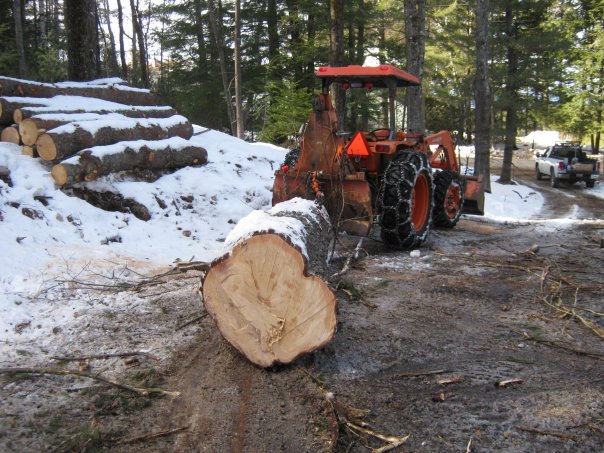

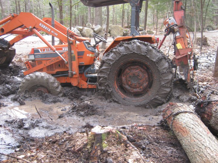

I've got the same chains Gordon does, mine are branded "Norse", but are made by Tellefsdal.
Very well made chain, I drove a fair bit on pavement this past winter keeping a friend's driveway clear, and there is virtually no wear on the studs.
As someone else mentioned, they are meant to be run loose.. the instructions say that the chains should rotate around the tire 30 cm after driving 1 km. Mine do that, no problems with them coming off or slapping the fenders once they're adjusted right. You should be able to get a clenched fist between the sidewall and the side chains.
If you do get them, use the roll pin link fasteners instead of the twist-lock joiners, they come with both.
They really impressed me with traction, very little slippage on ice and snow, both on finished surfaces and around the woods during the winter.

These look identical to the Aquiline Talons I have just ordered.
They are quite probably the same, in today's global economy there is an excellent chance they're made in the same factory as the Tellefsdal (Norse) chains.
As I said earlier, I really like them, but I have a gravel driveway and woods use for them. They damage paved or concrete surfaces pretty quickly.
Sean
