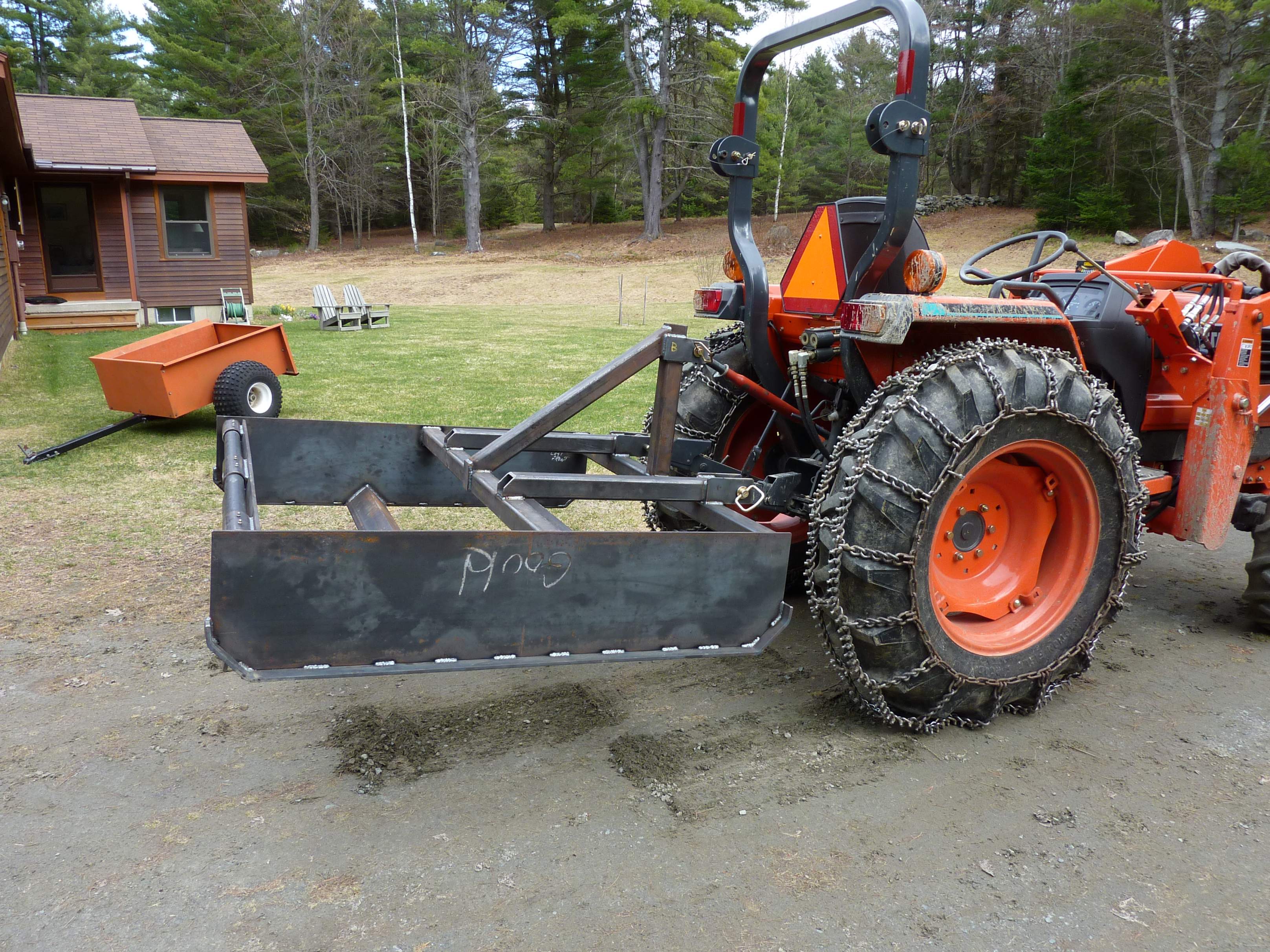

I would definately go with an "H" pattern like the "duo-grip" with either v-bars or studs. Mine has welded studs and they make my tractor virtually unstoppable on ice and snow. Good in the woods to but not for asphalt.
They are made in Norway. Brand name is Tellefsdal and were less money through my dealer than any internet chains I could find.
Here is a picture I had from this spring. Blow it up to get a good look at the chains.

Hey Gordon -
Yup - those chains ARE nasty alright. Nice road grader too - is that a DIY?
I tried to find distributor/dealer information for Tellefsdal chains in the USA, but had no luck. Do you have any contact information I could try?
What do you suppose those chains would do to concrete? I park my tractor in a concrete-floored garage bay.

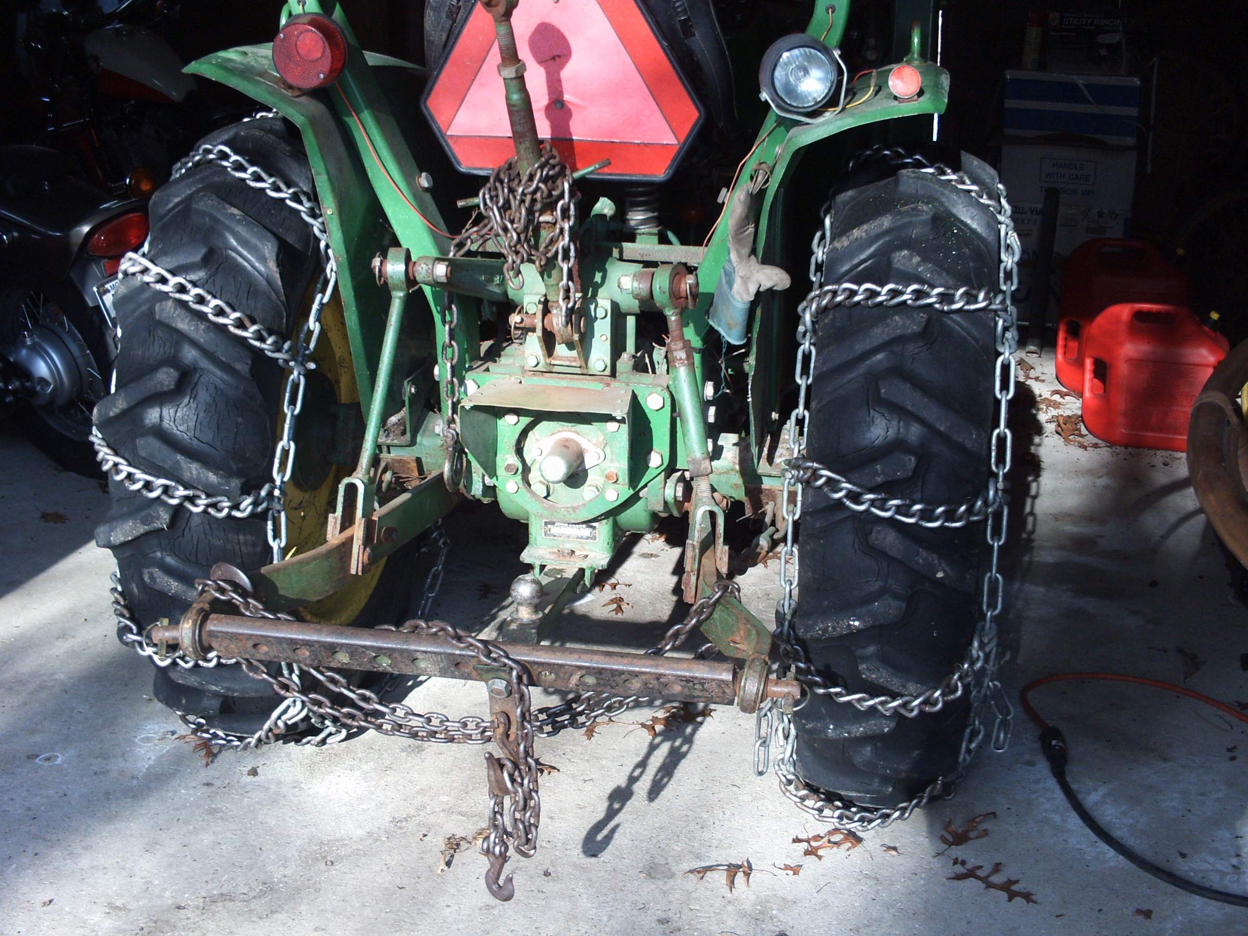

Any chains will help a great deal. I have 4 link regular chains on all tires and even these made my tractor virtually unstopable when pushing snow or skidding logs in snow and ice. I have ags on my tractor and found the chains to fall nicely into the ground as the tires rotated. I do not snug up the chians any more tightly than I can by hand meaning I do not use a leverage device.

I've got the same chains Gordon does, mine are branded "Norse", but are made by Tellefsdal.
Very well made chain, I drove a fair bit on pavement this past winter keeping a friend's driveway clear, and there is virtually no wear on the studs.
As someone else mentioned, they are meant to be run loose.. the instructions say that the chains should rotate around the tire 30 cm after driving 1 km. Mine do that, no problems with them coming off or slapping the fenders once they're adjusted right. You should be able to get a clenched fist between the sidewall and the side chains.
If you do get them, use the roll pin link fasteners instead of the twist-lock joiners, they come with both.
They really impressed me with traction, very little slippage on ice and snow, both on finished surfaces and around the woods during the winter.

Incidentally, I don't think they are helping much in picture #1 :).

Lol, nope. Winch hooked a stump, logs behind the winch wouldn't allow me to back up, mud in front got soupier and soupier. Had to drop the winch, go get the excavator and lift the winch out. Ugly mess.
