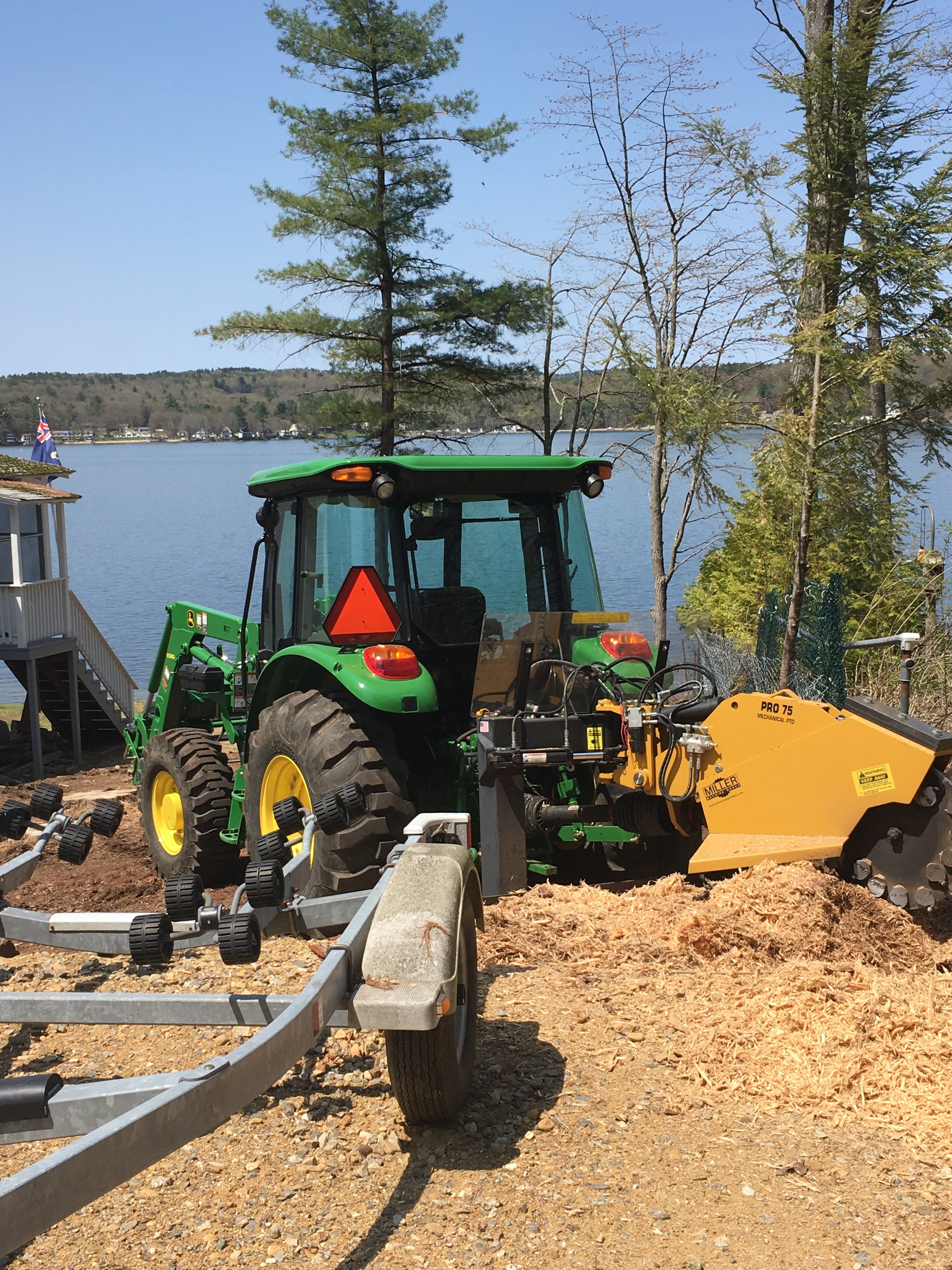

Get yourself a heavy stump grinder and stop beating up your machine. This one weighs 2,000 pounds.
