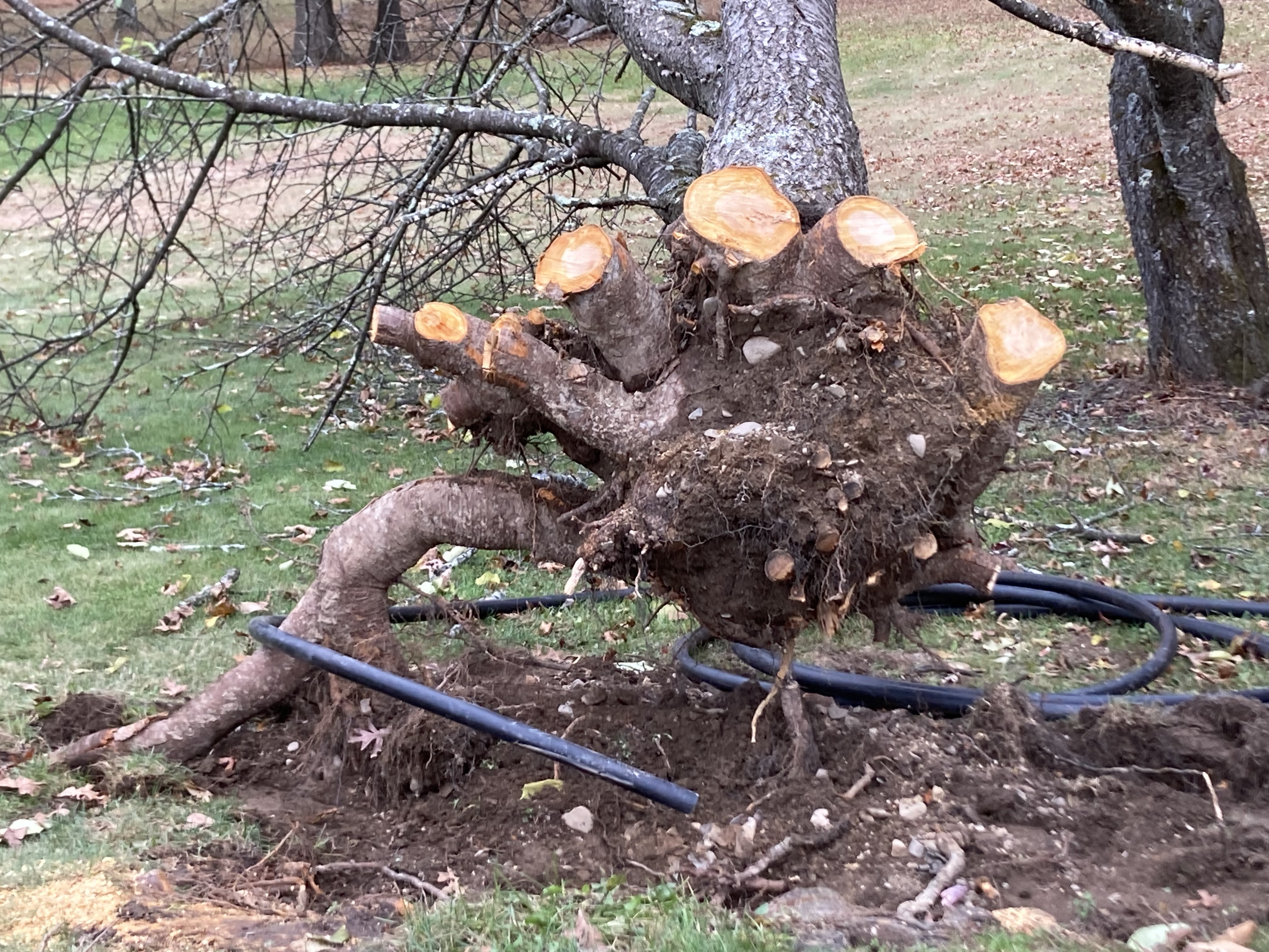

You'll need more undercut. As much as possible. It's amazing how much hold even a few large roots have. Here's one of the biggest and most challenging I've done.

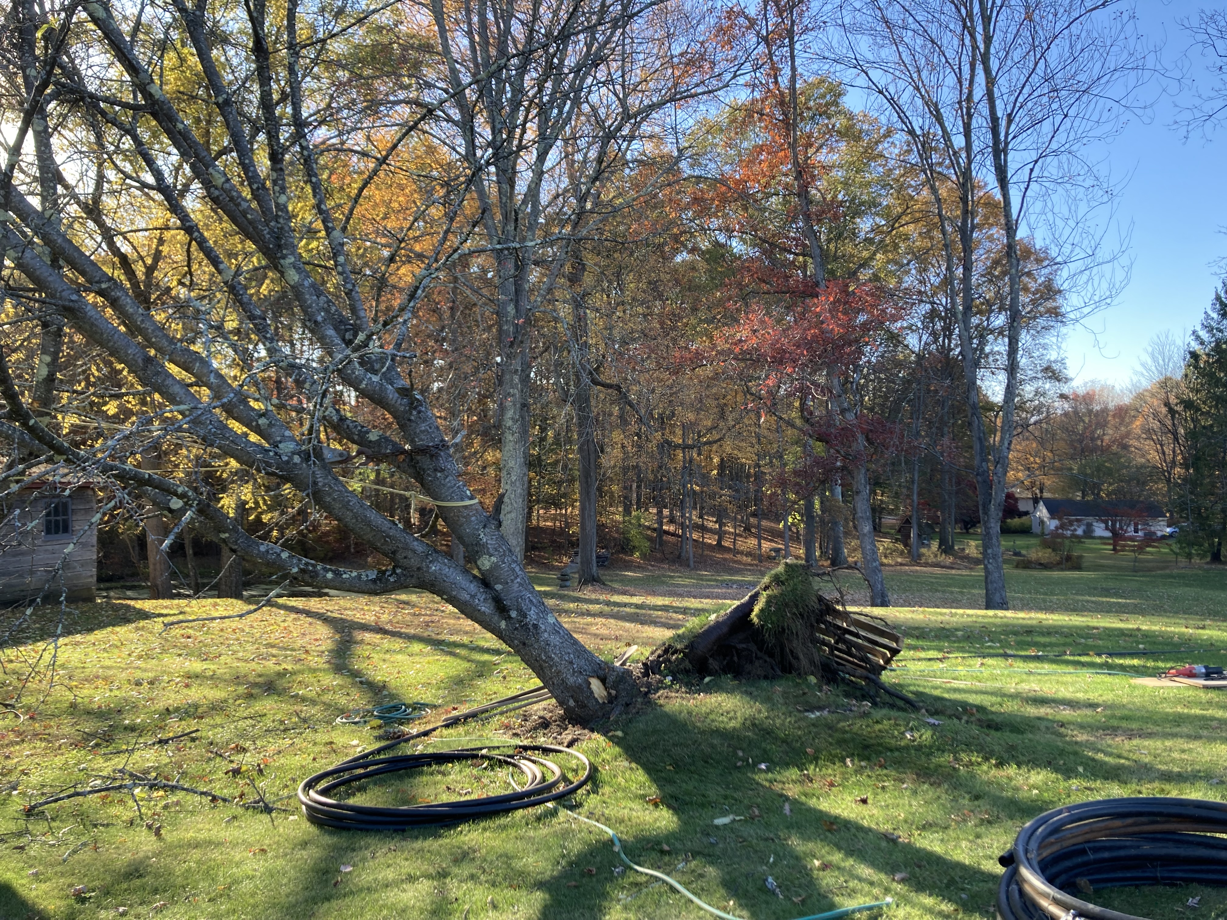

I've got a Komastsu PC78MR-6 that is just a bit bigger than the 306 (it's 308 size) and it digs out some pretty big cotton wood root balls pretty easily. The bucket curl provides the most prying force. As someone said, leave more of the tree sticking up to act as a lever. You can always try to soak the ground around the tree to soften the dirt as well.

Leaving the rest of the tree attached and pushing it over from above, as high as you can reach, is easier.
Exactly, nice thing about an excavator, you can set the angle of the bucket by raising one track on a dirt pile or digging one track down. With a TLB, you just offset the outriggers.
