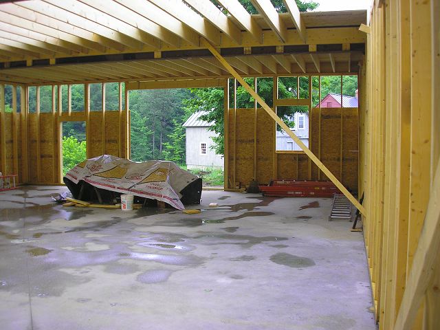

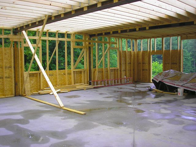

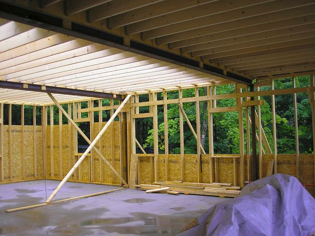

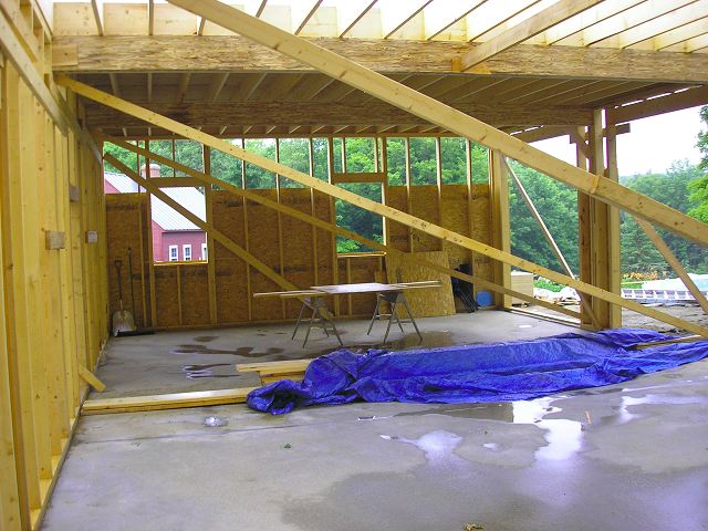

OK, here's where things are at the end of the week.
First, the short beams. It was all much ado about nothing. They need 1 3/4" of post on each end to meet the structural objective. We're got 2 3/4 on each end, so they are fine the way they are, no need to the fatten posts or anything. Dodged that bullet!
The rest of the week the crew got all the floor joists hung and about 1/3 of the deck installed. We used the tractor and forks to lift the deck material up to the second floor. The loader can only lift to about 10' and the deck is 12', but the gang was able to lean over a pull up the sheets. It beat the heck out of humping them up a ladder!
I don't have pictures of loading the deck material, but here are some shots of the inside. It's going to be a great work space.

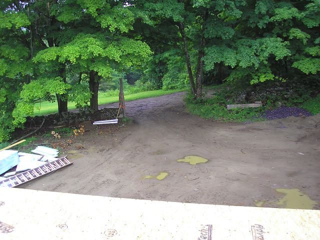

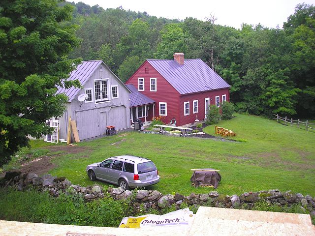

A little later I climbed up on the deck to check out the view. Not bad, and a whole new perspective from what I've been looking at for the past 48 years.
