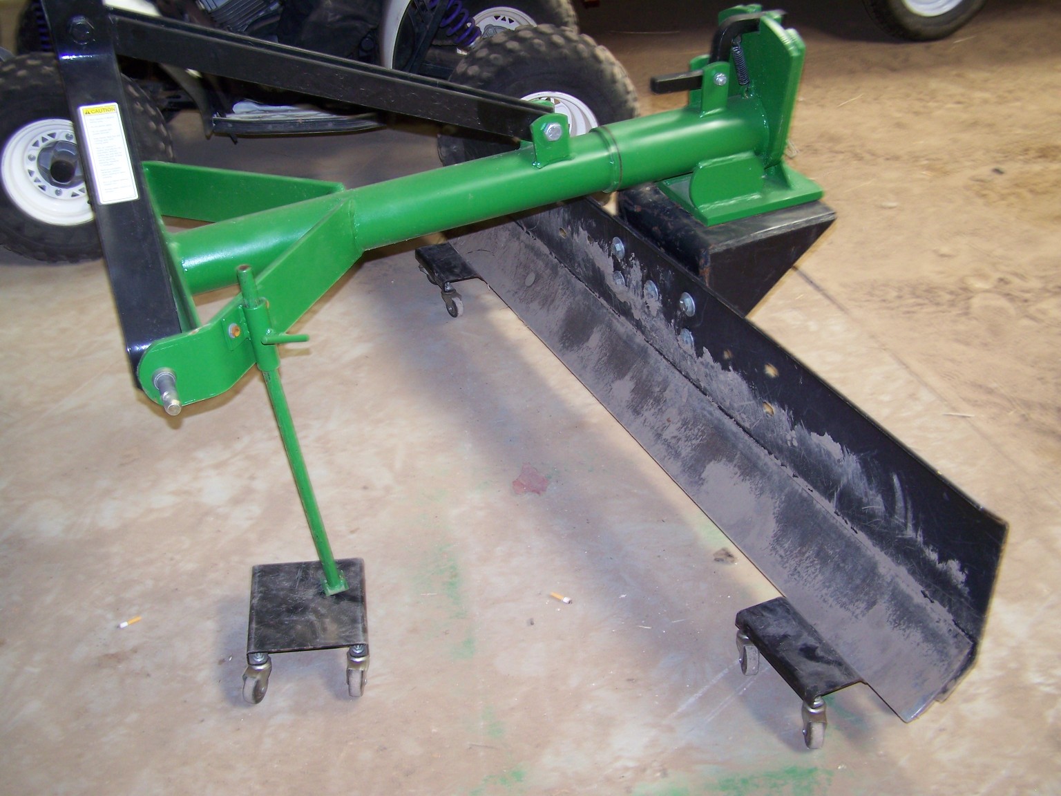

As far as moving implements around, I use snowmobile dollies for my blade and now for landscape rake when they are on the concrete. 1 person can move alot with these as all wheels swivel 360 degrees. I also use them for riding lawnmower, 4-wheelers, snowmobiles, posistioning work benches, etc. Maybe a bit pricey but I find many uses around the shop for them.
Parts Unlimited Sled Dolly Set - DennisKirk.com
do you find they get hung up on cigarette butts?
haha just razzing you man.. i'm just jealous, the only concrete floor i have here is in my garage which is stuffed full of "stuff"... no room for anything but a few chainsaws..
/ Tips for Outfitting a New Storage Building? #8
Those act as mini speedbumps to keep the blade from getting out of control:D:D lol.
But yes, with the dollies smaller wheels you do need to keep a cleaner floor;)
