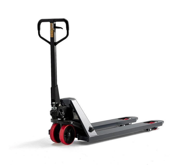

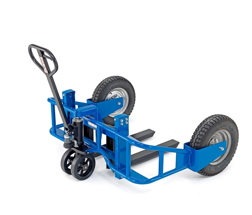

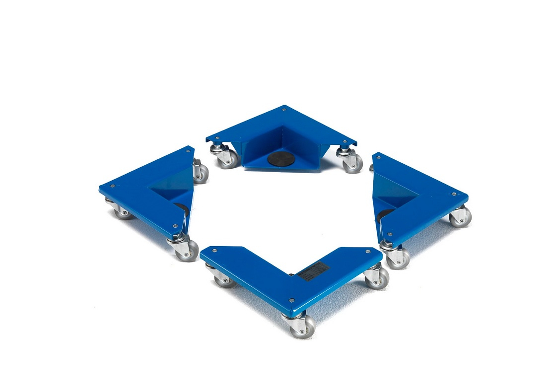

I doesn't see big sense to screw casters for all pallets you use. IMHO much better is to use pallet trolley
There is "offroad" PT version
In case you don't want to invest in such thing, you can make wheels set

I doesn't see big sense to screw casters for all pallets you use. IMHO much better is to use pallet trolley ["pallet jack" in US]

I used to think, that "jack" is something to lift with. With "trolley" you ride around 😁 This one is more for moving rather than lifting. 😉
I am not a farmer, i am coming from industry. In factories that is primary means of transport for all kinds of junk. In efficient factory it is considered as "deadly sin" to leave any kind of goods directly on floor. Everything MUST be on pallet, so if needed man can take that jack and haul those goodies forward in max 10 sec.
That jack is pretty handy, normally it can lift 2000 ... 2500 kg. so to put on forks some wooden blocks and lift compact tractor is easy-peasy
Here most basic, with manual pump it will cost 200....250 €, if good brand - 300...350 €
If they are with electric lift AND drive - 1500 €. If they lift up to 5 ... 6 meters - even 10k €
