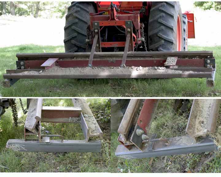

Here is picture a tail-wheel like I was speaking about.
/ Tips for grading driveway? #30
Thanks for the pic because when you said tail wheel, I pictured 2 small 4" casters. I like that setup & think with that system you could finetune how agressive the blade is. Hmmmm, you've got me thinking.....
