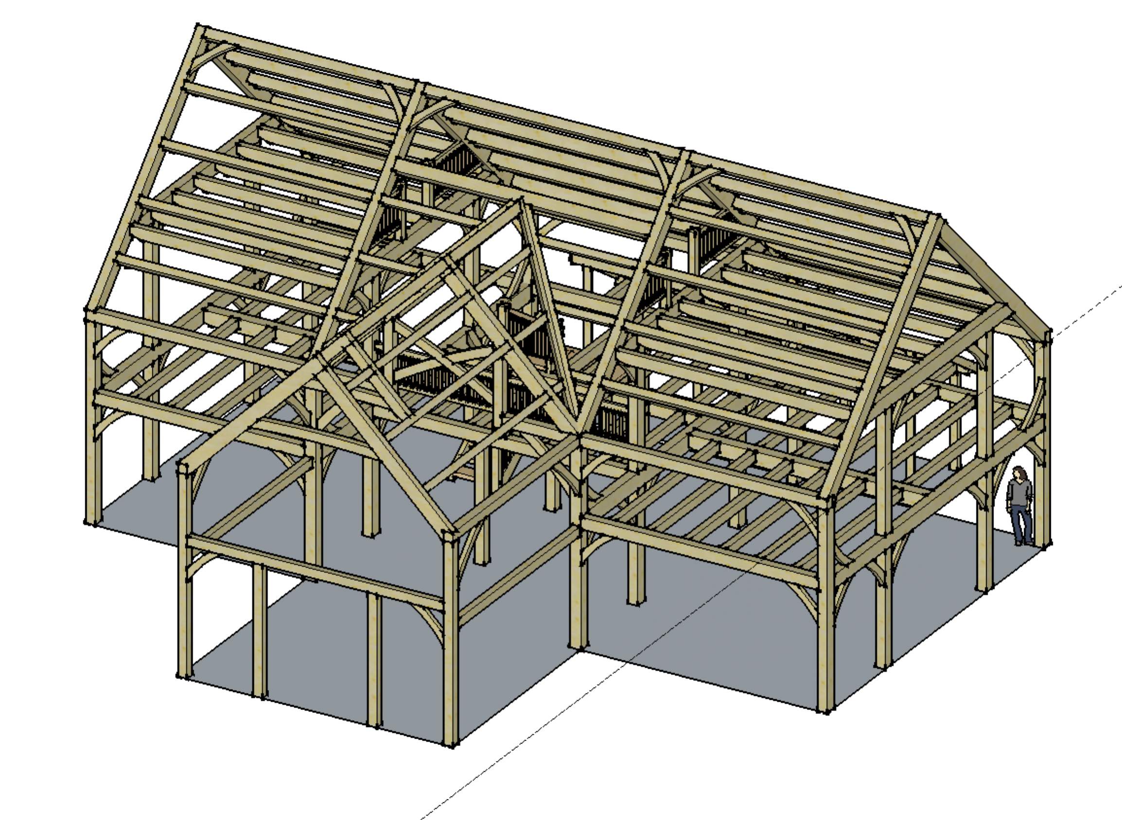

#59
Oh yes, it has continued. WE are currently waiting for permits from our town. NJ can be particularly difficult to get permits for things like this. We had to get the frame drawings stamped by an engineer before we could submit them for building permits. I expect we will have building permits feb/march and then this thread should be more lively.
Cool - I like the 3rd level loft area - wife keeps asking me "if we could add these":laughing:
What is your frame material (White Pine, Oak, Doug Fir?)
Have you determined how you will enclose the structure? SIPs, wrap n strap etc?
HVAC plans?
I noticed early in the thread you had some questions about layout - assume these are resolved, but as you get going and run into additional questions feel free to ask (or PM) we have now lived in our TF home for 1yr - fun project but certainly a bit stressful at times
Look forward to watching your project go up:drink:
