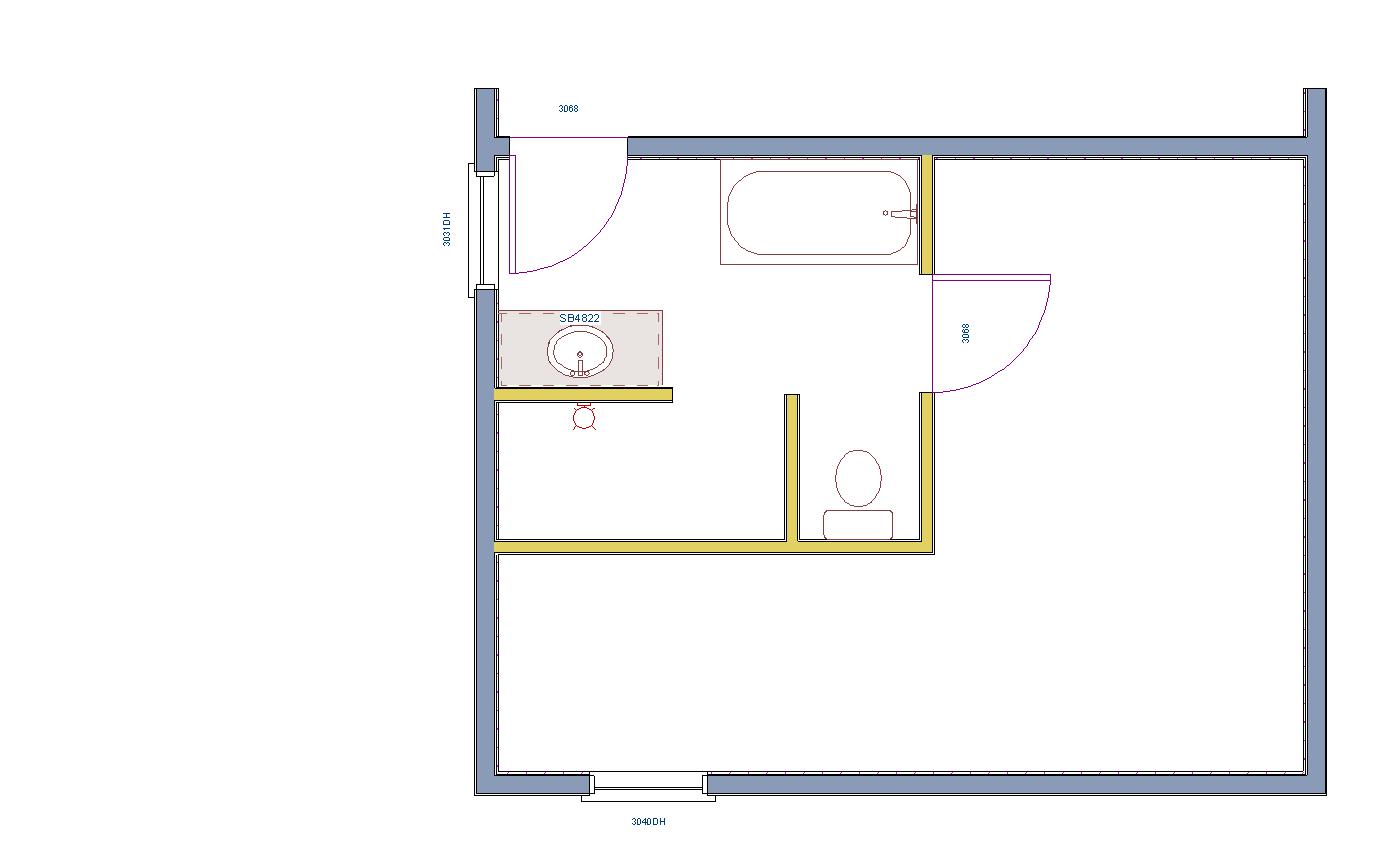

I talked to her about the double sinks and I think we may do a single sink with counter on the other side with a mirror above. A space to put her stuff while getting ready. I think its a good idea. The double sinks look good in a magazine, but really, who uses them. Also, I am looking at puttign the door into the closet from the bedroom. It does free up a lot of space in the bath, but now, what to do with it?

What are the inside measurement of the bathroom? I'll draw up an idea and post it.

As it is right now, the bathroom is 10' 8" x 15' 7"
The door from the bedroom to the bathroom will have to stay where it is, but I may move the closet door if it can make a real improvement to the bathroom. I don;t care for the toilet in its own room. I know that is very popular right now, I just don't really like it. My mom and step dad have that in their house so I'm not just saying "I think I don't like it". I could definitely see doing a zero entry shower, I think they look real cool, but I don't know how that effects the floor system or anything... Also, my wife and I are 30 years old, I am sure there will be at least one bathroom remodel before we are in mobility scooters ;-)

Are those the inside measurements after sheetrock is installed? Are you positive those are the right dimensions? That's huge. I've been playing around with some design ideas and in every case I have room left over for a bigger closet. Can the wall between the bathroom and master closet move to make the closet larger?

Eddie, yes. It's huge. If you look back at the original plan, there is a lot of extra space. A very big aisle between tub and vanity and that extra 2 feet or so by the door. I can move any of those interior walls, so the master suite is about 18' x 28'. Have at it.

Here is what I would call the basics, leaving your door and window placement the same. With bathrooms, I always try to put the vanity as the first thing you see when you walk in the door. The cabinet, counter, faucet, mirror and light should be beautiful. The shower is designed that the spray of the shower goes away from the opening so you don't need a door. It's 3' 6" deep and about 7 feet long. With a 4ft vanity, that should leave about 30 to 32 inches for the entry into the shower. Inside dimensions for the toilet is 3ft. For the tub, I'd go with something free standing.

Eddie, wow, that's not bad at all. I may tweak it a little. We want a big soaker tub and she wants it platform drop in. But with all that extra closet space, I could tweak that wall over some. Definitely gives me a different path to think about! And it gets rid of the vent I needed in the exterior wall!

Eddie, thanks again. I took it and put It in my software and moved some things around. I'll try to post it in a bit. I had to get a bigger tub in and my wife really wants a tub with a platform. Not a free standing tube. So that means we needed a little extra room. I think I made some good compromises to make it work.

I understand about the tub. It's all the little details that make it yours. I had several ideas, including two vanities and a room for the toilet. It's easy to use up a lot of space, but more fun for me to fit it into a smaller footprint. I also feel that you can never have too big of a closet. Even if it's not all used, it' always nice to have to empty space on a shelf.
Something to consider in the cost of a bathroom is the vanity. You cannot beat the price of a box store vanity and counter. But if you want to go with an odd size, or something long, then you have to go custom, which can easily double or triple the cost. I always suggest to clients to consider every option available with box store vanities and special order ones that they can get for you. Then get granite for the counter. As mentioned earlier, two bowls in a four or five foot vanity is too tight and you end up without any counter space. If you want two bowls, you need to go custom. I drew a plan that had an 8 foot vanity, but I didn't like how the room became a hallway, so I discarded it.
For me, I have to have every detail worked out in a plan before I'm comfortable moving forward. What you see when you open the door is very important, but so is flow and the placement of furniture. If you've ever been in a house that doesn't have a good flow to it, or the furniture is awkward, you know that it doesn't matter how nice the house is, it's still a mess.
