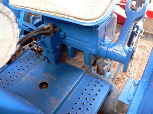

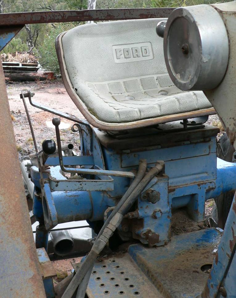

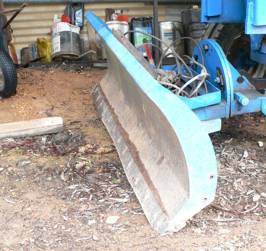

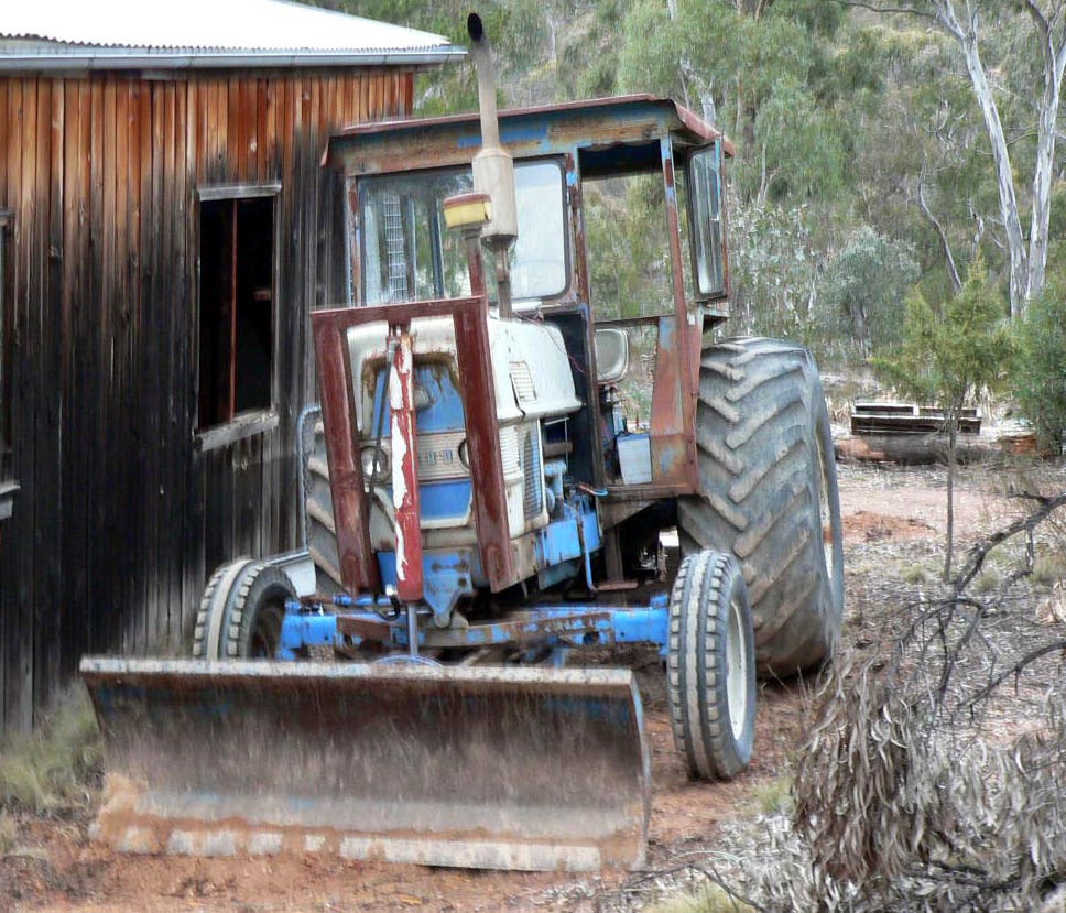

Has anyone made a hydraulic tilt unit to swing a front blade hydraulically? It would sure help on the bush tracks to be able to tilt the blade through about 15 degrees on either side of level.
I don't know a lot about how to add another hydraulic cylinder but presume there is some kind of junction/valve and control that would work.
Also, some sort of articulation will be needed so the blade can still raise and lower using the existing ram
Any advice most welcome

Your second picture shows that it already has tilt, so just add cylinder mounts and a diverter valve.

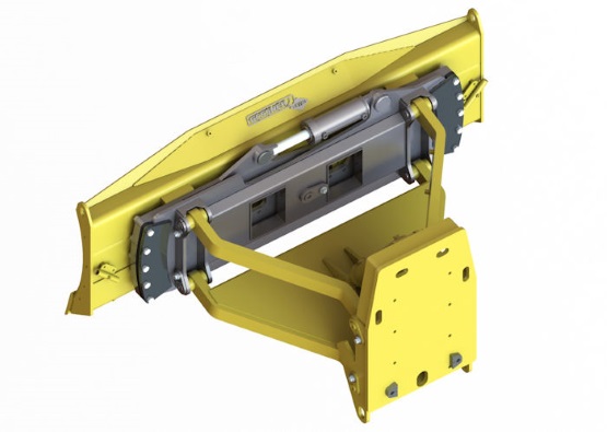

The tilt cylinder would mount on the frame of the blade and go up and down with the blade. The tilt angle doesn't change when the blade is raised or lowered.
The diverter would switch lift and lower, to tilt right or left.

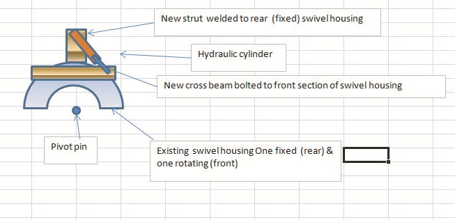

Before I saw this, it had occurred to me there was a "home-built way to achieve what I needed and your comments would be appreciated - especially about how to install the hydraulics. Please refer to my attached sketch-drawing. The mechanical aspects are simple enough - what is NOT shown in the sketch is a channel that will be added at the top of the swivel housing to hold the front and rear sections in alignment

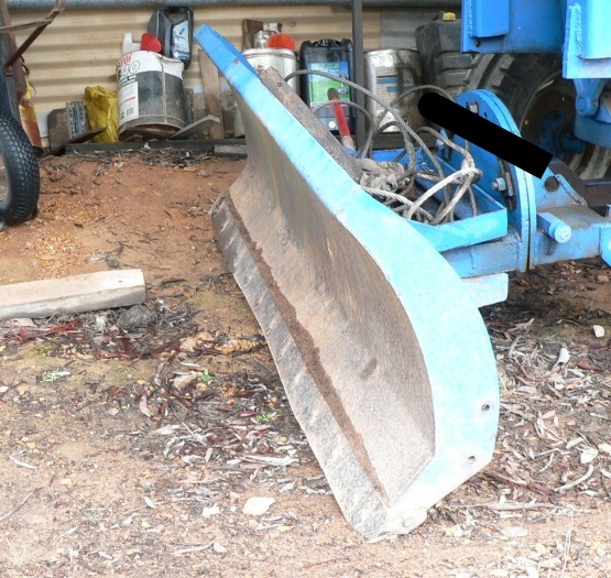

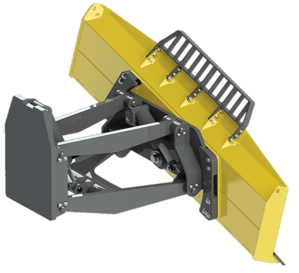

The pictures were to give you an idea of how to add one cylinder to your blade.
Adding one horizontal cylinder to tilt your blade is still a "
home-built" way to achieve what you need to tilt your blade.
Remove the bolt that locks the front and rear plates together, add cylinder mounting brackets, one to the rear plate, one to the front plate and put the cylinder where I added the black line to your picture:

Post some pictures and details of the valve you are using now to raise and lower the blade.
If it has a power beyond port, you can buy a new valve to control the tilt cylinder.
If it doesn't have power beyond, you can buy the new valve with power beyond and put it inline ahead of the existing valve.

Mechanical elements could be like the attached drawing - the same principle as your suggestion

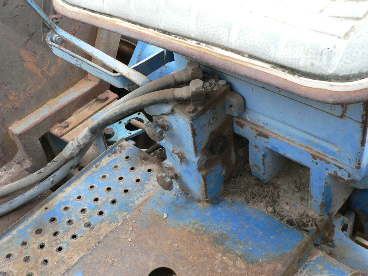

Pictures of controls are also attached

Yep, that will work for the pivot.
I hope someone that knows about your valve can chime in with more information.
You could start a thread in the Ford Vintage Tractors Forum ( http://www.tractorbynet.com/forums/ford-vintage-tractors/ ), with a link to this thread.

You already have the manual tilt adjustment. Just remove the bolt that the arrow points to, loosen the bolts in the slots, tilt the blade and line up the new hole, put the bolt back in and tighten all three nuts

Is this what you mean? Also shown is picture of the current front lift control. You have now exhausted my knowledge of hydraulics so how to fit the new arrangement is beyond my simple bush-brain. Any suggestions?

I do not know enough about the valve in the picture or your machine to give you a adatailed answer. However, if the only function of that valve is to raise and lower the blade, in theory, you should be able to replace the current valve with a 2 lever valve that will do what you want. I know you are not fond of your local shop, but they can tell you how to safely add a 2 lever valve. Once again, assuming the current valve's only job is to control the blade, you can insert a 2 lever valve its place. Then, all you would need is a tilt cylinder and the hydraulic lines. Of course , you still need to address any relief settings, flow rates, etc to keep the system safe. My knowledge is also limited so let's hope someone joins in that can give you additional direction. If it were me I would get all of the help I could from the local shops and from any engineering or trade schools in my area that teach hydraulics.
The basic design would take the input from the current valve and connect it to the new 2 lever valve. The output from the 2 lever valve would go the the same place that the output is going from the current valve. One lever would control the lift and the other would control the tilt. Finally, just mount the tilt cylinder, connect the hydraulic lines and start having fun.
BUT, ONLY AFTER YOU CONFIRM THE ROLE OF THE CURRENT VALVE AND TAKE THE REQUIRED SAFELY MEASURES BY INSTALLING ANY NEEDED RELIEF VALVES AND RETURNING THE FLUID BACK TO THE TANK.
1. How many hoses are connected to the current valve (4,5,6)?
2. Is the blade lift the only hydraulic component on your machine?
3. What is at the other end of the input and output hoses?
4. Is the input coming directly from a pump?
5. Is the output returning directly to the tank?
6. Is the relief valve part of the current valve and what is the relief setting?
Since the blade is already designed to tilt, you are ahead of the game.
I hope this helps...PS, if you are not sure take pictures.

Yes, that is the type of valve i meant. All you really need to know is the specs on the current valve. Once you know that you can substitute the 2 lever valve and mount the cylinder. The questions are:
1. Open or closed; most likely open.
2. Internal or external relief valve and the pressure setting.
The shop should be able to look at your manual or service guides and answer these questions.
Let us know what you learn.
