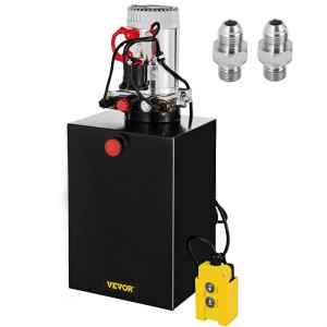

I have a Load Trail 32' tilt deck trailer. Wondering what you guys do if the pump fails and you can't raise it up to unload? IF it fails in the up position I can either use the gravity down feature on the wired remote or disconnect a hydraulic line. More worried about going somewhere and I can't raise it up? Thinking about buying a cheap Vevor double acting hyd pump and some extra hose and carry it with me. Thoughts?

If you tee’d quick coupler(s) it would make it easy to use the manual pump.
How often do these trailer hydraulic systems fail other than a dead battery?

I don't know how often they fail but I prefer to be ready in case I am hundreds of miles away from home. Some of these hydraulic units have a manual pump, this one a KTI hydraulics units doesn't so that's why I am thinking about getting a cheap unit for backup
