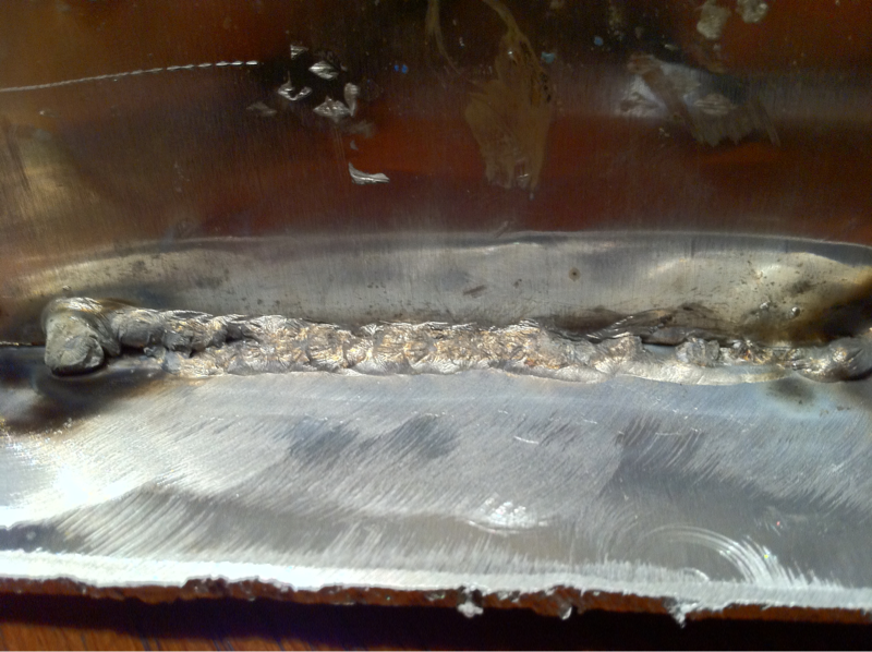

I am a pretty good tig welder on steel, and I am finding aluminum to be really difficult to weld. I have a miller Syncrowave 200 and I am trying to weld on 1/8" aluminum flat stock. I am looking for anyone who can give me some advice so that I stop flying through filler rod and gas and I am running out of scrap to practice on.

i am sure that you are welding using the AC instead of DC current. It also requires only argon gas, not the 25/75 mix. not meaning to step on toes.
/ TIG welding aluminum #3
Remember to ball the electrode and to use the correct ones.
The other thing to think about is that it takes a lot more heat to melt through the aluminum oxide layer then it does to melt pure aluminum. Therefore need a lot more heat to get it started and then back off on the pedal.

what type of tungsten are you using they are colored at the end we say red top green top and so on red isnt for alluminum green is if youre using green then by all means ball it if u get gold grey or orange u can use them for any metal and should sharpen them not ball them having said that I agree that you are probably just starting too cold and allowing the work to get too hot
/ TIG welding aluminum #5
The metal need to be CLEAN. Get a stainless steel wire brush and write "Aluminum ONLY" on the handle. Do not use this wire brush for anything else except aluminum or it can pick up contaminants that will be deposited on the aluminum you are trying to clean.

Do you have any pictures and can you tell us your settings? For 1/8" I'd start with 125 amps, AC of course. On my Dynsasty I'd run maybe 100 Hz depending on the type of weld. I use ceriated tungsten all the time (orange) and I use 3/32. On my Dynesty (Invertor) I do not ball the tips, sharpen it at a 20 degree angle or so.
Also, what type of aluminum? With aluminum you need to move WAY faster than with steel. Also, what cup are you using and what is your argon flow set at? If the aluminum if new, I don't wire brush it, the cleaning action of the AC removes the oxydation.

I am using the green tip electrode with a balled end. I have the amps set to 175 max and was at 60% on the peddle. I am using the same cup and flow that I use for steel and I running 100% argon. The photo was the best I could do. It's strong but ugly and I am not happy with it

In my opinion, you are not close enough to the corner, and you are lacking shielding gas. What cup are you using? Are you at 15 CFM or so?How far out is the electrode sticking?

You need to be in AC with high frequency turned on. The photo shows that you have some contamination. Are you using high frequency? The photo doesnt look like it, it should hear and feel the vibratory effect of the high freq. unit working, this aids in the fusion process.
THe black sooty stuff is contamination and will keep your metal from adhereing. If you strike an arc and get that black soot, it isnt clean enough. Use a stainless steel brush to clean the metal and then wipe it down with Acetone. Dont forget to clean your rods also. Then dont touch them with your bare hands, use a pair of clean cotton gloves so you dont get oil from your skin on the rod or plate. Use a large cup size 10 or more and tungsten stick out should be about 1/8". I think you said you had the balled end so I assume that you know how to do that by setting your machine like you are going to stick rod and striking an arc with your tig rig. The ball needs to be perfectly round on the end and not off centered or you will get some erratic arcing.

As a base use 190-200 and pedal the amperage to get the base material to puddle FIRST. This should be around 150-175 for non-anodized aluminum plate. THEN add rod to the front of the puddle and work it into the base metal by moving back to the previous "button" on the weld bead and then forward before adding rod once again. Repeat.
Your picture shows a lack of shielding gas coverage: Check you distance from the cup to the base metal AND the CFM of the ARGON gas. It should be 15 or so. IF you're welding outside of a sheltered area with a breeze blowing this WILL greatly affect the shielding gas' ability to cover your weld.
