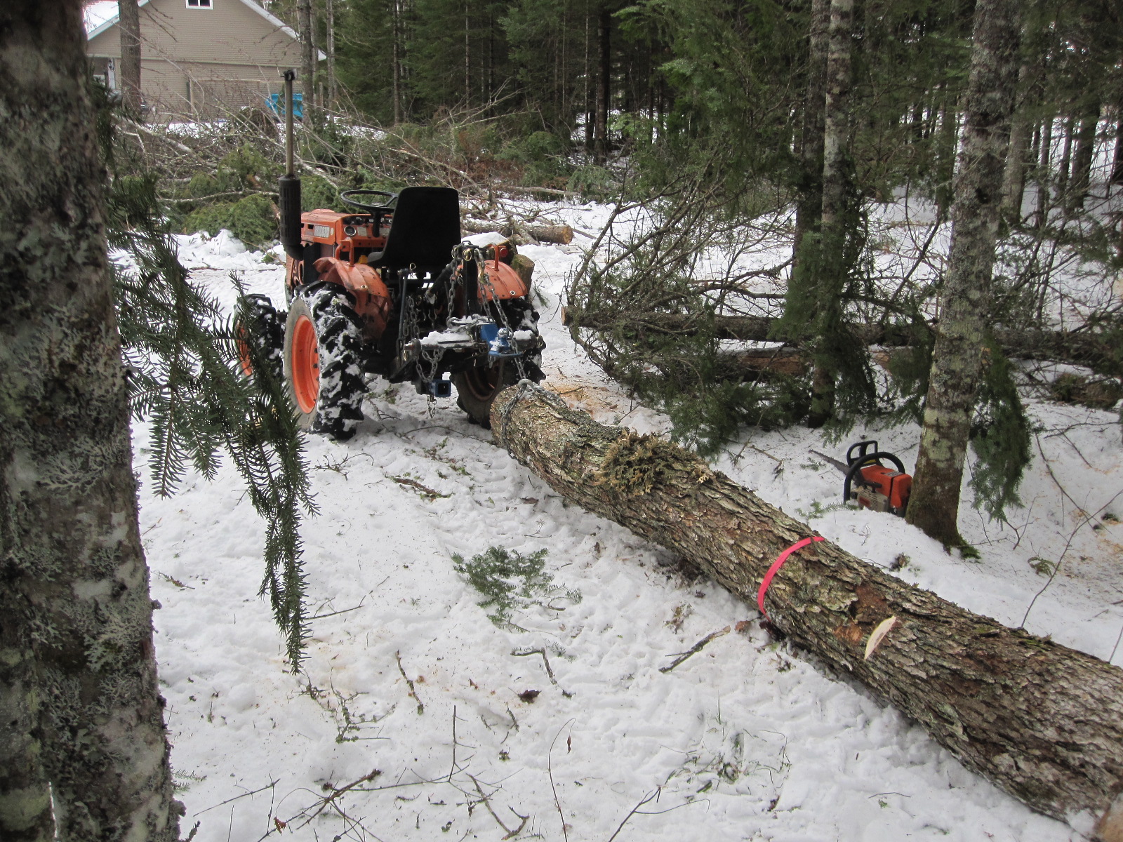

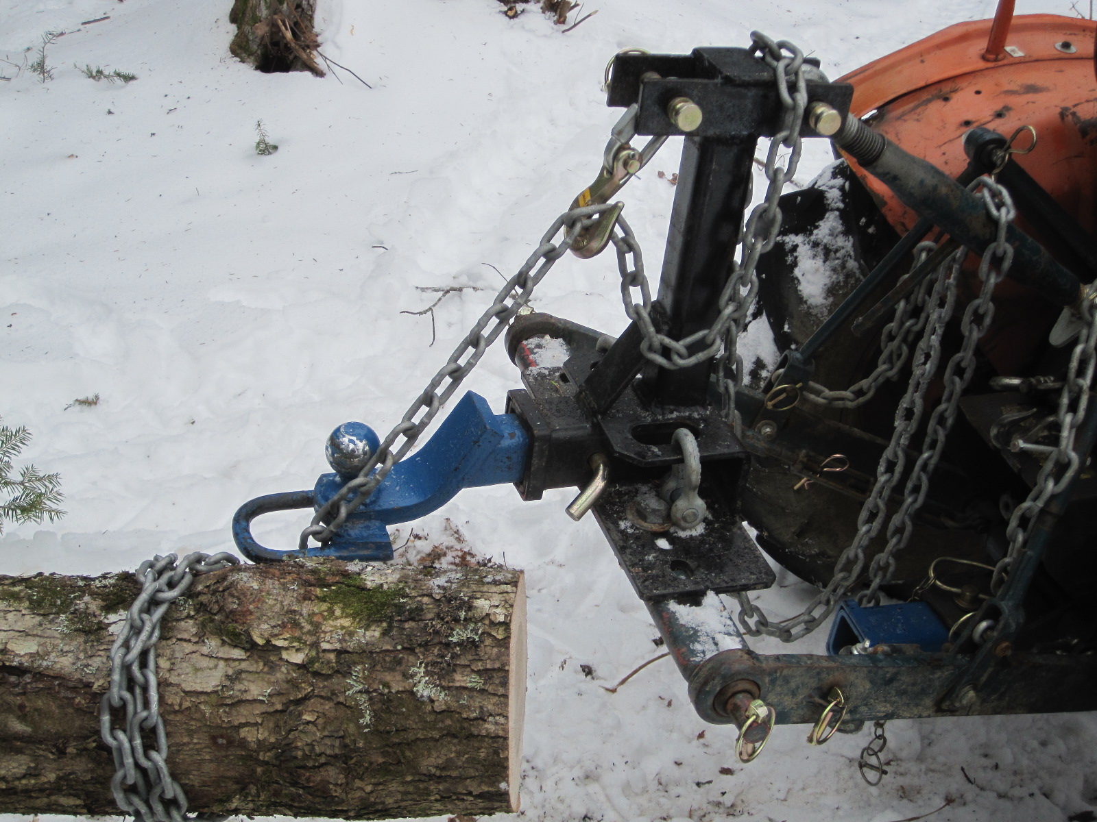

StanR, similar to mine that I made for my 1980 Kubota B7100. Used it to skid out 5 cord of Maple firewood this Feb. I run my chain through a loop on the lower hitch & up to the top link attach point. That way you are pulling from lower down & lifting from the upper attachment point. I didn't invent it, saw it on one of these tractor forums somewhere .....
