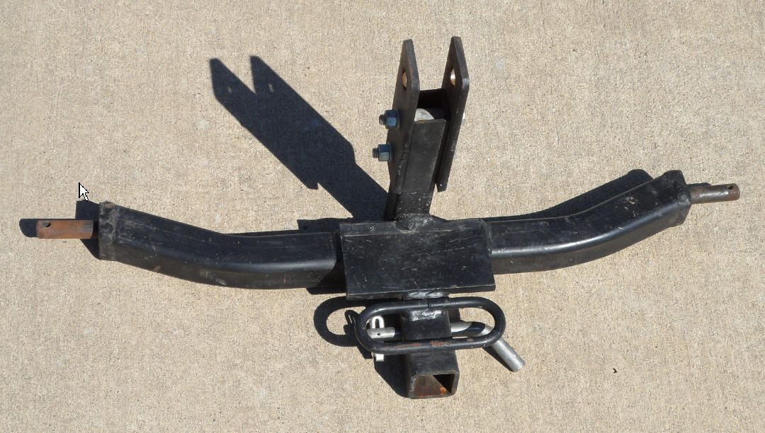

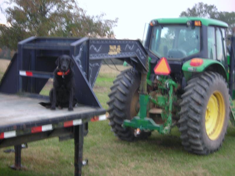

My mom bought my dad one that was made by tarter gate company from the local Co-Op with a 2 5/16" ball next to the top pin. It is light duty made from thin 3"x3" square and had a sticker on that said don't use to move a loaded trailer. You can especially tell it when moving a gooseneck. I kind of copied the design and beefed it up. The one I made is from 4"x4"x1/4" square and more bracing. It is one of the handiest attachments we have.

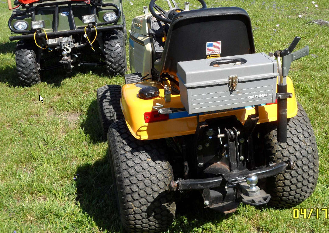

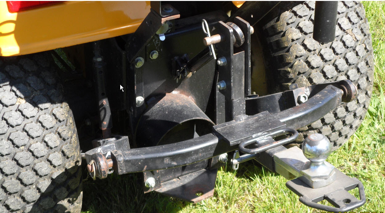

I always put ball-mounts and/or receiver hitches on all my equipment. My Cub Cadet super garden tractor only has a cat 0 3-point so I thought a 2 inch receiver would look a little oversized for it. I paid $10 for a 1.25 hitch made for a small car at a flea market, cut it to size and added pins and an upright, and it made a nice cat 0 receiver hitch.

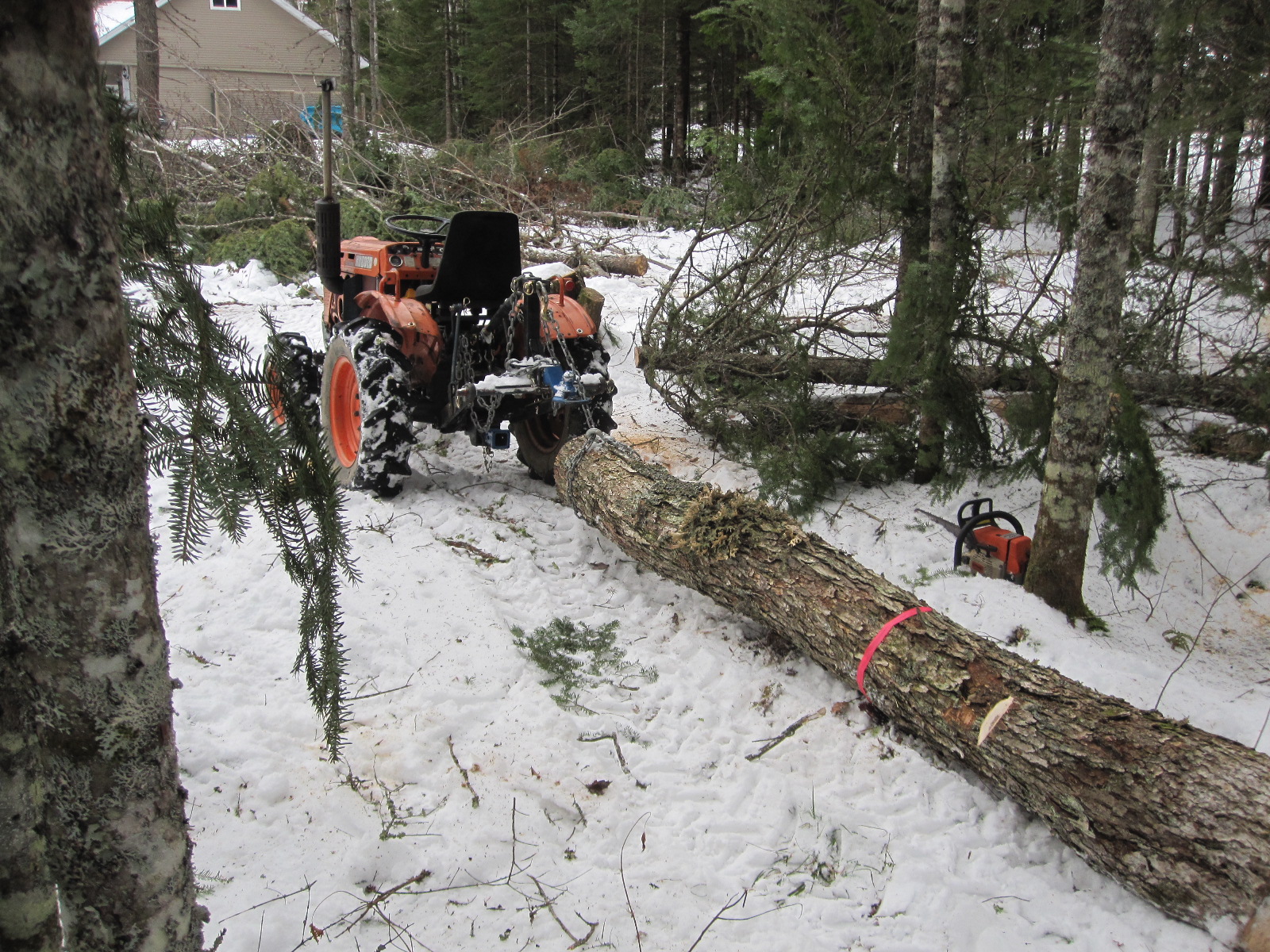

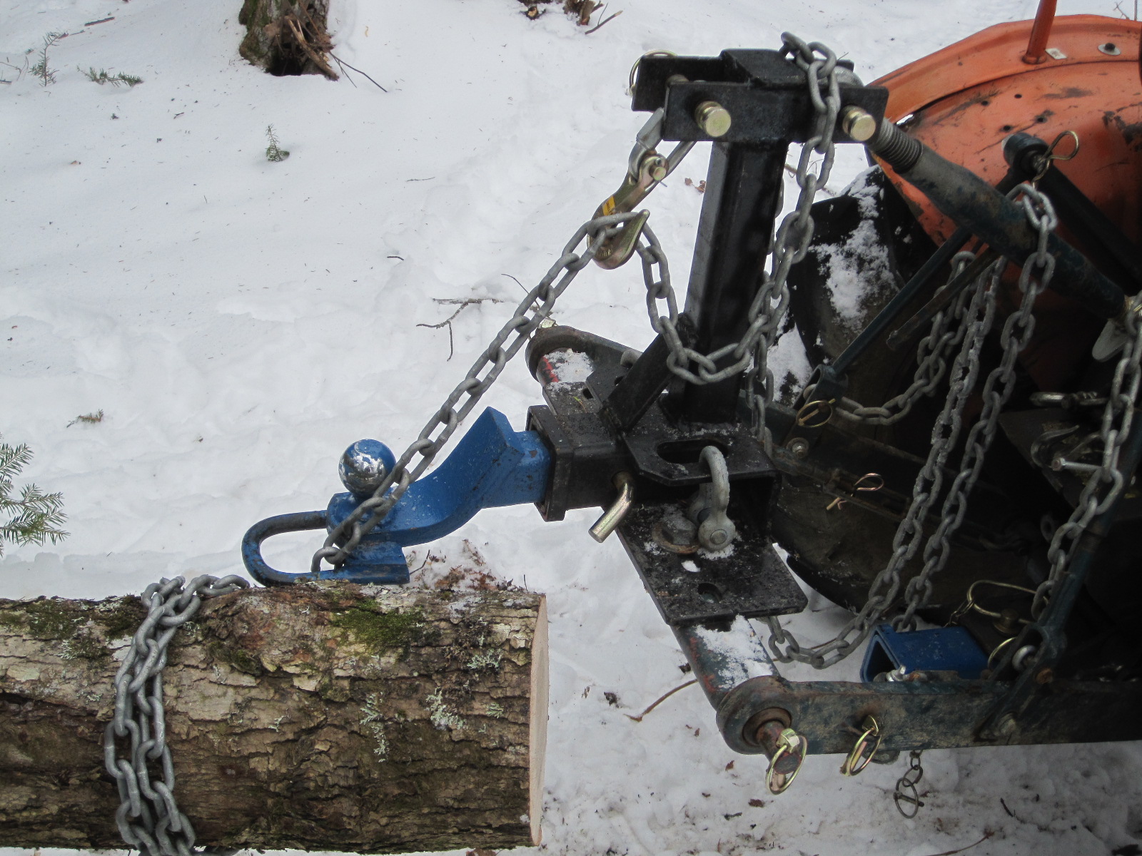

StanR, similar to mine that I made for my 1980 Kubota B7100. Used it to skid out 5 cord of Maple firewood this Feb. I run my chain through a loop on the lower hitch & up to the top link attach point. That way you are pulling from lower down & lifting from the upper attachment point. I didn't invent it, saw it on one of these tractor forums somewhere .....
