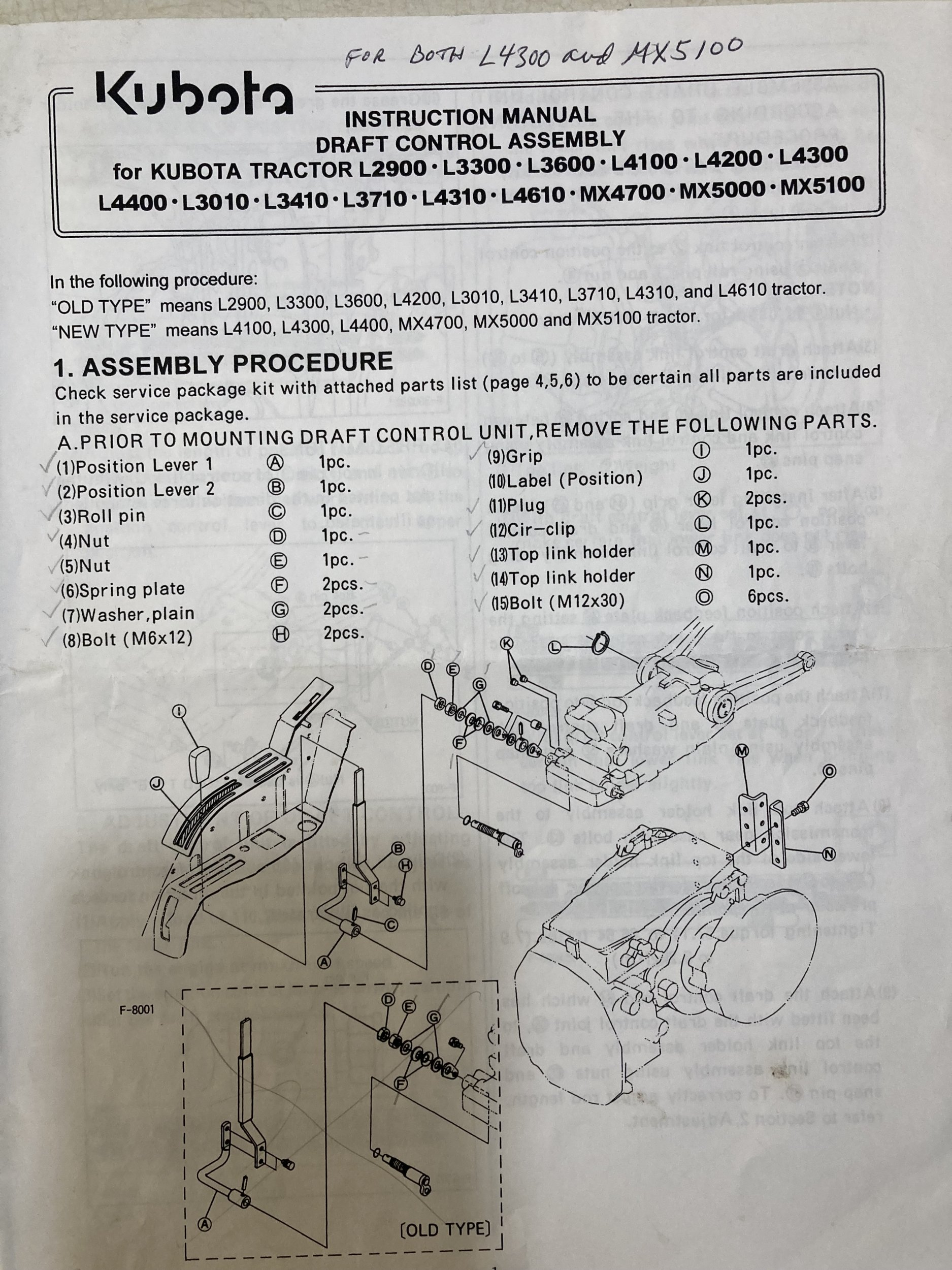

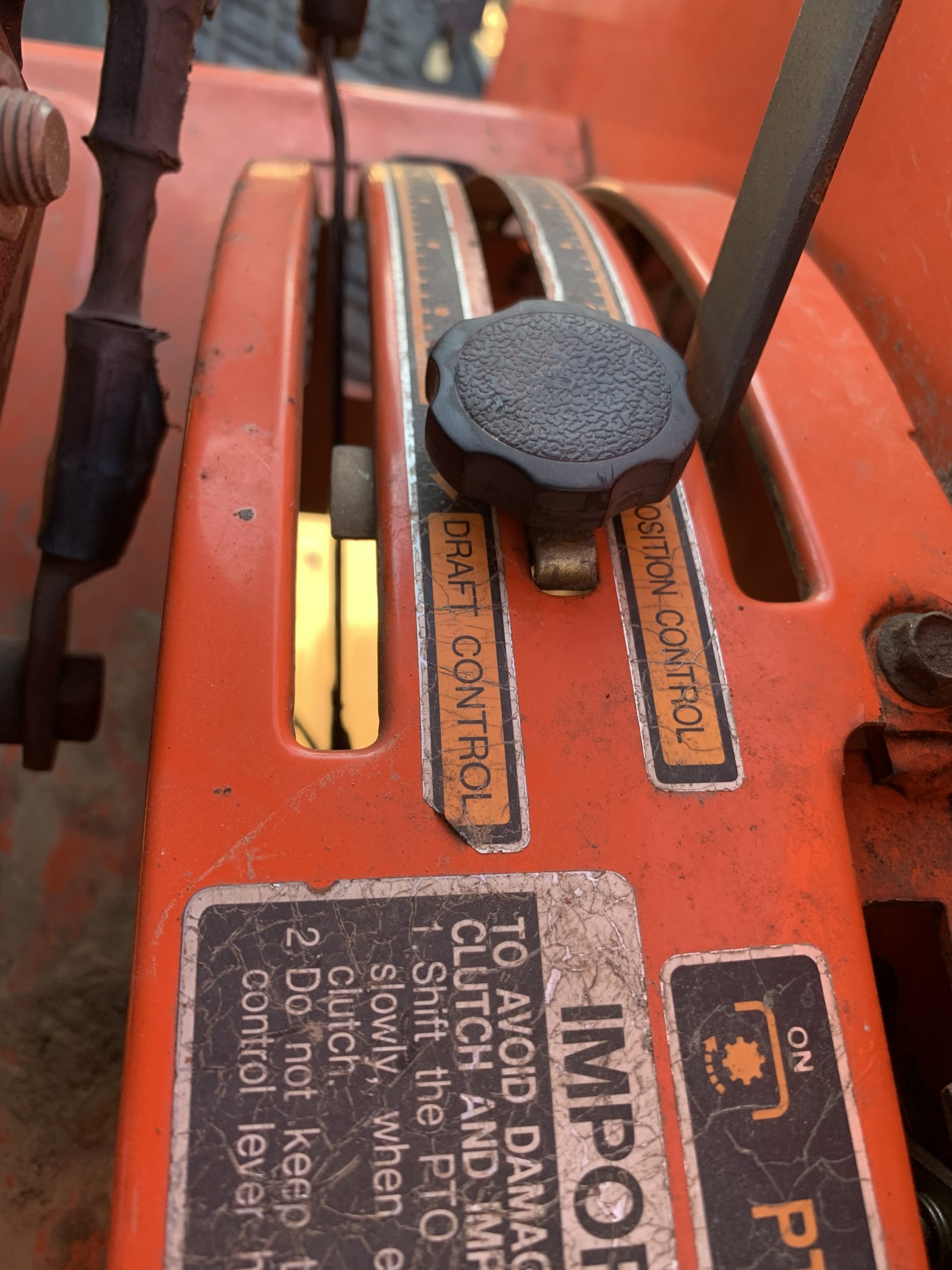

As I had said earlier once you get the "lowering speed knob" unstuck and that fixed I'm betting the Position Control and Draft Control situation will be much different.
Today, I was able to get the 'lowering speed knob' to turn freely. It wasn't really stuck tight, but it was open all the way.
Unfortunately, this did not resolve the issue. I tried adjusting the lowering knob into many different positions and still could not get the 'position' lever to affect the 3 point hitch in any way at all. Not even the slightest.
I did use this tractor for several hours on last week with a fairly heavy attachment, and it got the job done. I do have more work with this attachment for this week on this tractor, because my Grand L6060 is down with a DPF issue.

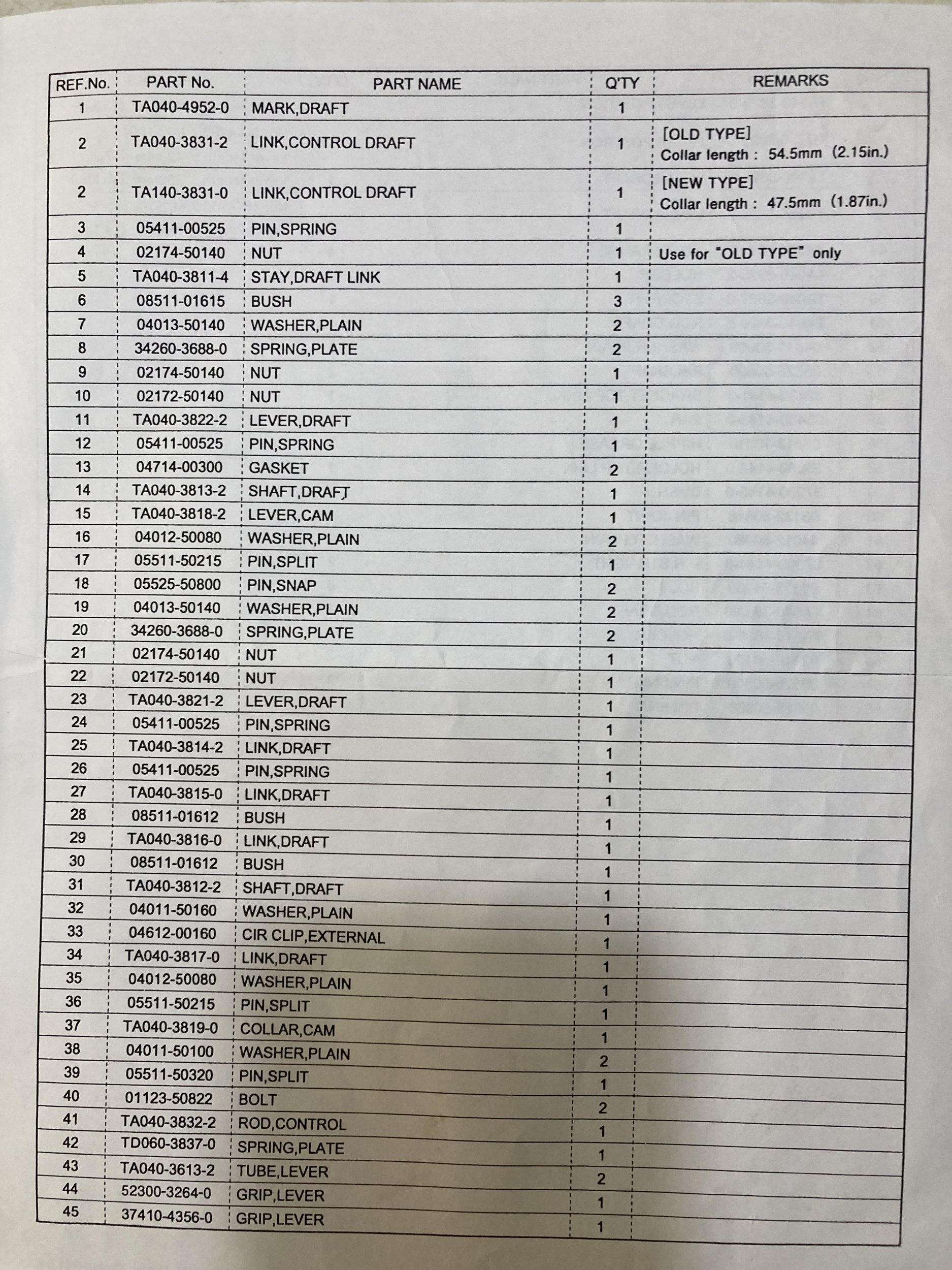

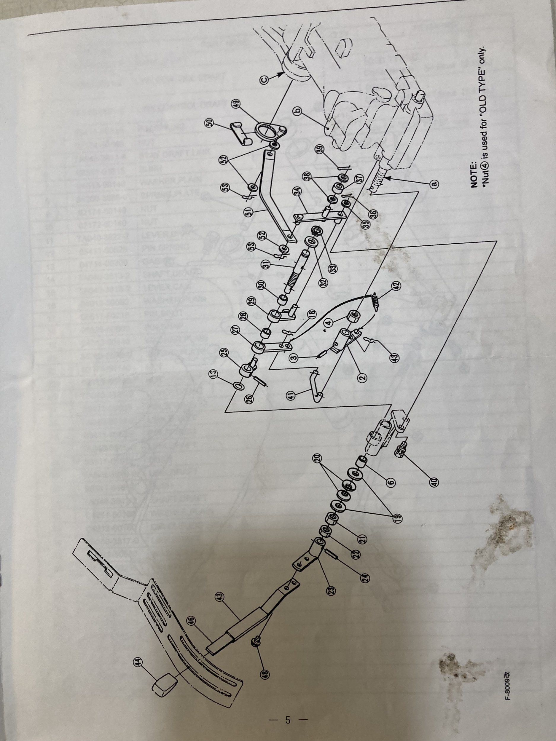

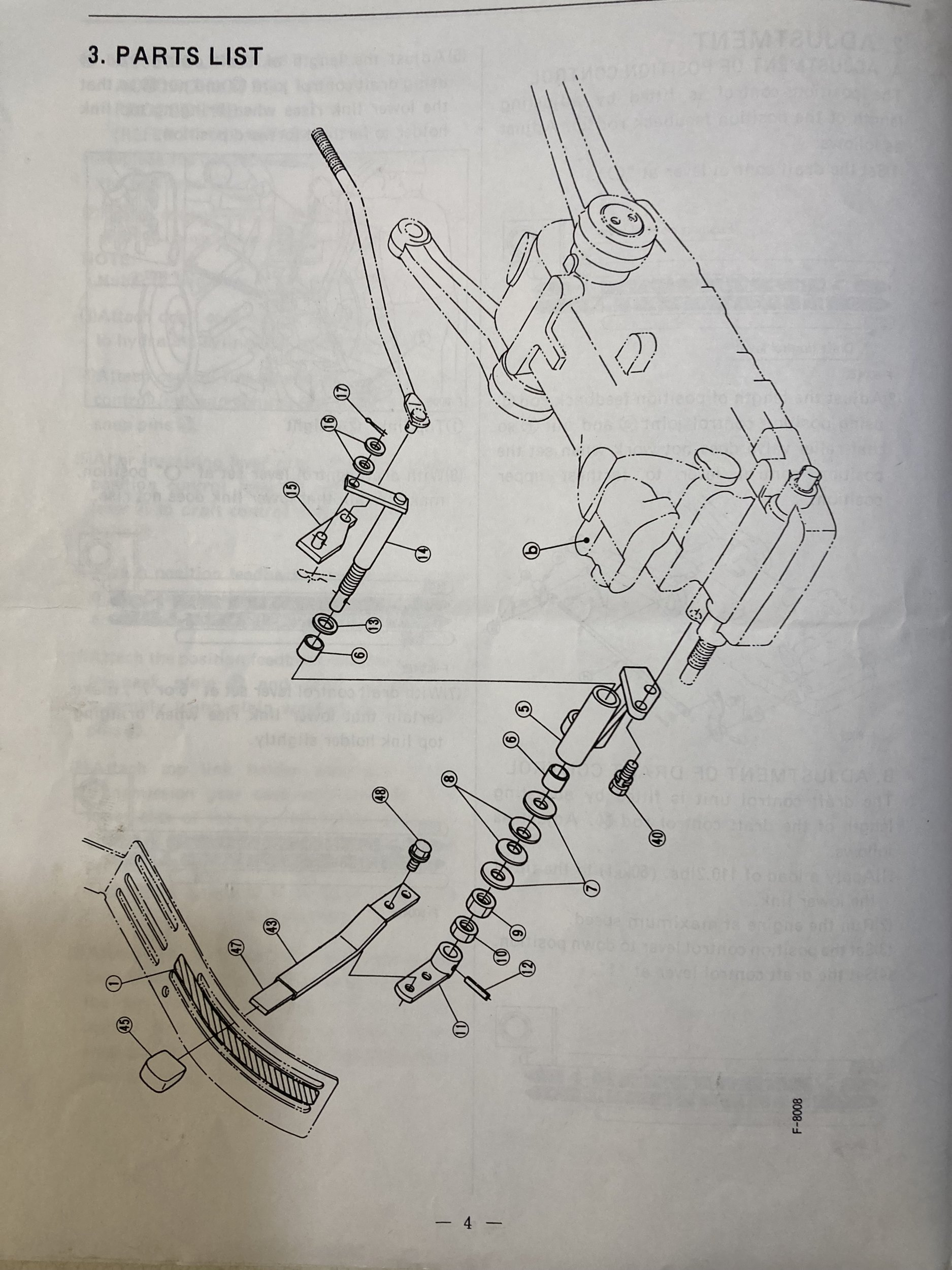

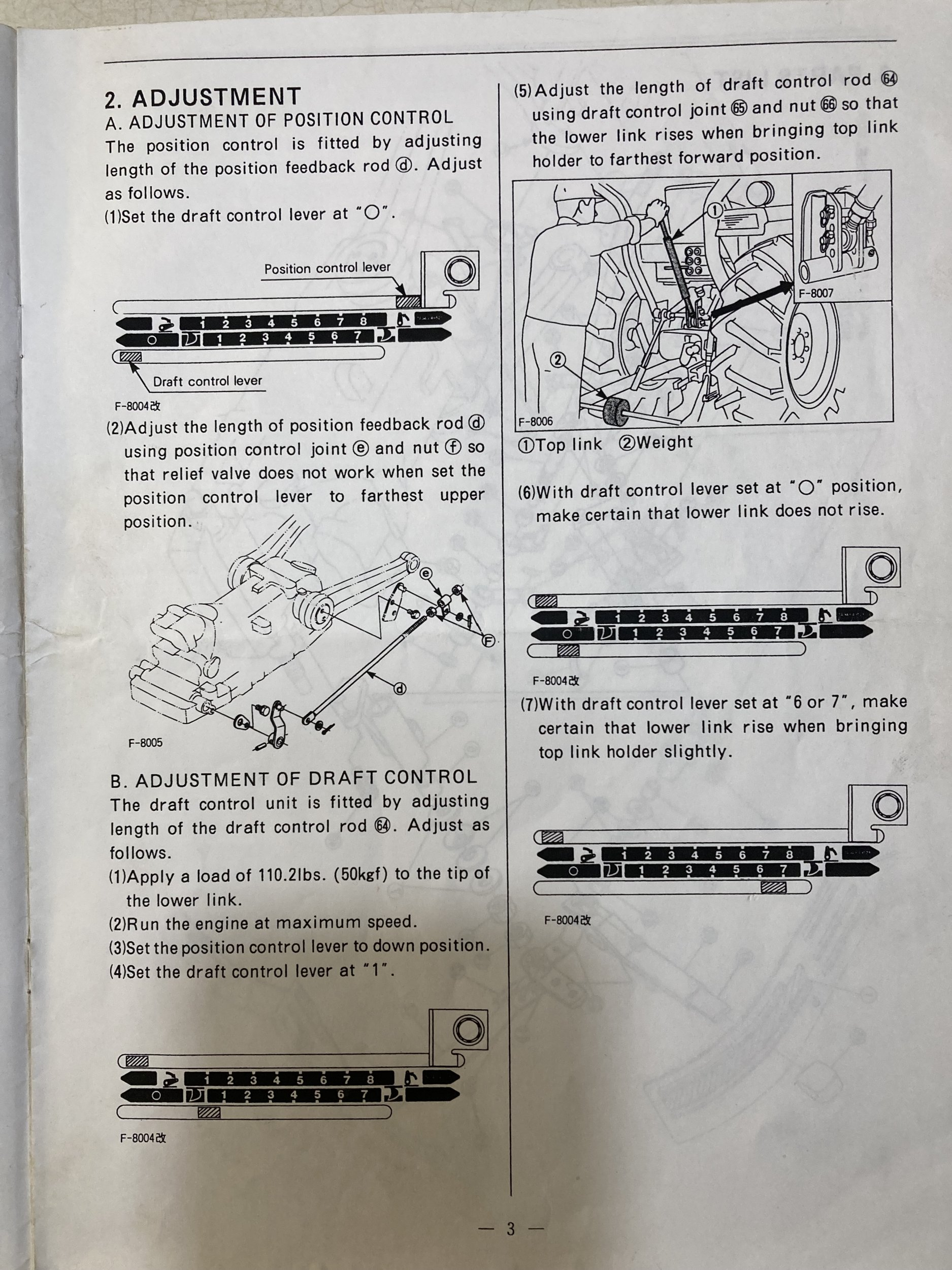

I'm surprised. The lowering speed knob is not so loose that it may be doing nothing is it? Does it feels like it is doing something? [Internally I think it is moving a slider against a lobe of a cam-like shaft.]
It's been long enough that I have forgotten -- did you get hold of an operators manual for that tractor ? Anything specific in it about disabling or bypassing draft control? Very puzzling.
If you look at post #41 where you show a picture of the threaded rod, I would think one could just take that threaded rod loose, take it out of the picture and eliminate draft control interference as the cause (OR show that it was the cause.) Easy to try.

The knob does seem to be working. It did change the speed that the attachment drops.
I will try disconnecting the threaded rod. But I think it needs to be connected for things to work at all. I did not try adjusting the threaded rod today, but I expected the position lever to do something today. It did not.

Since the drop speed knob seems work, how did you raise the load in the first place ? If not using the "dead" position control lever it must have been using the Draft control lever.

Yes. The only way that I have ever been able to raise or lower the attachment is by using the draft control lever.

This tractor is 25 years old and may simply have worn internal linkages. Can you bypass the draft control (3ph top-link input)linkage to test things?
On my MF135 the internal linkages wore and resulted in a no lift situation, until I bypassed the draft control input and then have full 3ph lift(carryall on ground(overrloaded) and front wheels in air).
/ Three point hitch draft control M4700 #78
I recently purchased a 1997 Kubota M4700
The 3 point hitch has 2 levers. One for position and one for draft control. View attachment 717534
It seems that the position control does nothing. The only way for me to move the 3ph is with the draft control. Is this normal? I'm not familiar with using draft control, but this doesn't seem right.
Also, today, when I went to attach an implement, the arms would not go down. I put both control levers all the way down and stood on the arms, and they would not go down. When I put downward pressure on the arms with my mini excavator, they went down.
Then I was able to attach my implement and lift and lower it with the draft control lever.
