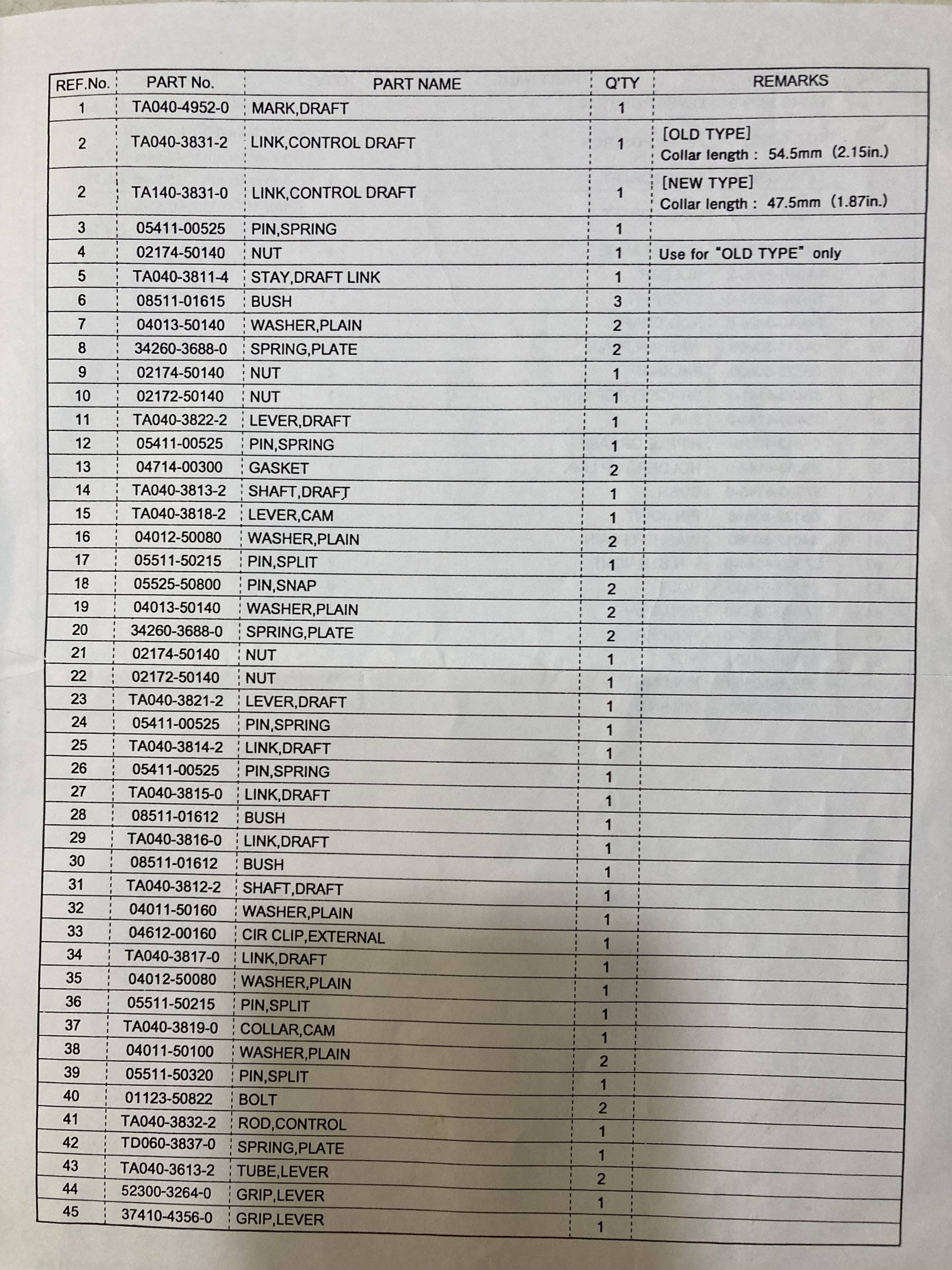

Here is a video of the linkage of the position and draft control levers connect to the tractor under the seat. Everything seems to be working and connected properly.

Your video is pretty clear. Your draft control lever and your position control lever are moving their respective shafts and each shaft is pinned with a split in thru the shaft. Nothing threaded. No locknuts. No, it is not related to some adjustment of draft and position control linkages.
It seems exytremely likely that the previous owner was stumped on this and passed the problem on to you. It was not something simple or he would have fixed it.
Just like I said from day one -- the fact that your lowering speed knob will not move is THE KEY to your problem. Something is stuck. Can you see the mechanism that the lowering speed knob/shaft go down into ? Probably not as that is almost impossible to get to in most tractors. That will have to be investigated.
/ Three point hitch draft control M4700 #40
OK, here are the pages of what I thought was a one page sheet. Oops. I can't do a PDF so took pictures of the book and if you can't read let me know. Your draft control is likely installed fine but it's the relationship between it and the three point linkage that is almost certainly the issue. After my installation I had to adjust it-- threaded rod--to get it to do what it should and not "strain" the hydraulics or cause the three-pt arms to behave weird. These are the exact instructions for the MX4700.
The adjustment you will try is on page 6 (#64) and is the threaded rod at the upper part by the top link. It's clear in the picture and clear at the very end of your video. To adjust correctly you would need to read the instructions and put the 100 (?) lb weight on the three point linkage and then turn the threaded rod until it does what the instructions say. The hardest part for me was finding the 100 lbs of weight. Adjusting the threaded rod was easy. As noted, I've done several installations and it was easy.
You don't need to adjust the draft control but rather the relationship between it and the three point linkage. I would take the easy path here and follow the directions to adjust. When I first installed mine it behaved like yours until I did the adjustment. Relax and good luck. Don't overthink this until you need to. Also, loosen up that underseat knob because it needs to be and you can also rule it out or in. It's still a possible cause.
