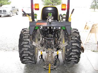

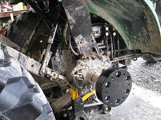

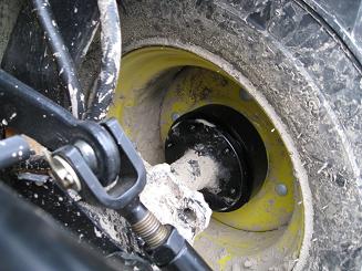

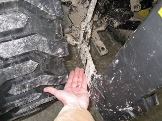

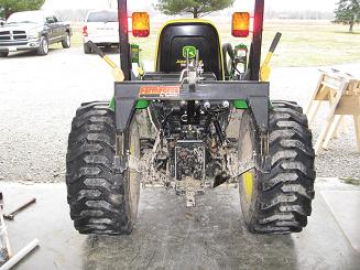

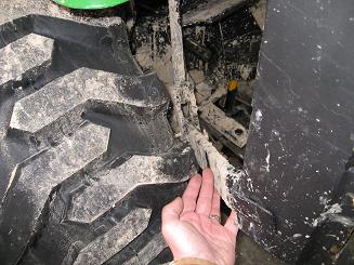

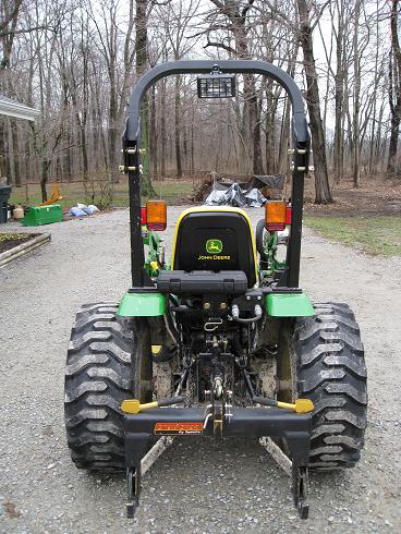

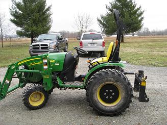

Well, I finaly got around to installing the spacers I mentioned before.
I have attached some pics of the project.
I think it will work well for my needs. There is appoximately 3 inches of clearance between the 3ph arms and the tire tread.

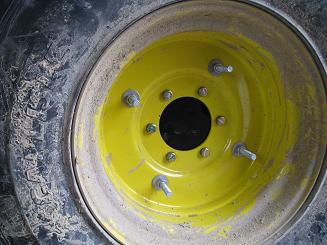

The only thing I would do different is make the recess about an 1/8" deeper that fits over the boss on the hub. I had to shim behind the spacer to make up the difference. I would also make a boss on the spacer like Hillstone advised. This would help in getting the wheel back on.
I also had some additional weights made. 14" OD x 2" thick. I put two of these on each wheel. The weight of those plus the spacers should be just over 500 lbs.
Not sure if I like the look of the black wheel weights in the rims. I may paint them JD Yellow...

I agree 110%, paint the weights yellow!! Tractor looks funny from the rear, but if it works for your needs, good job!!
   / Three point hitch clearance on a 2520 #39
I definately looks silly being so wide in the rear, but I bet its stable as heck.
