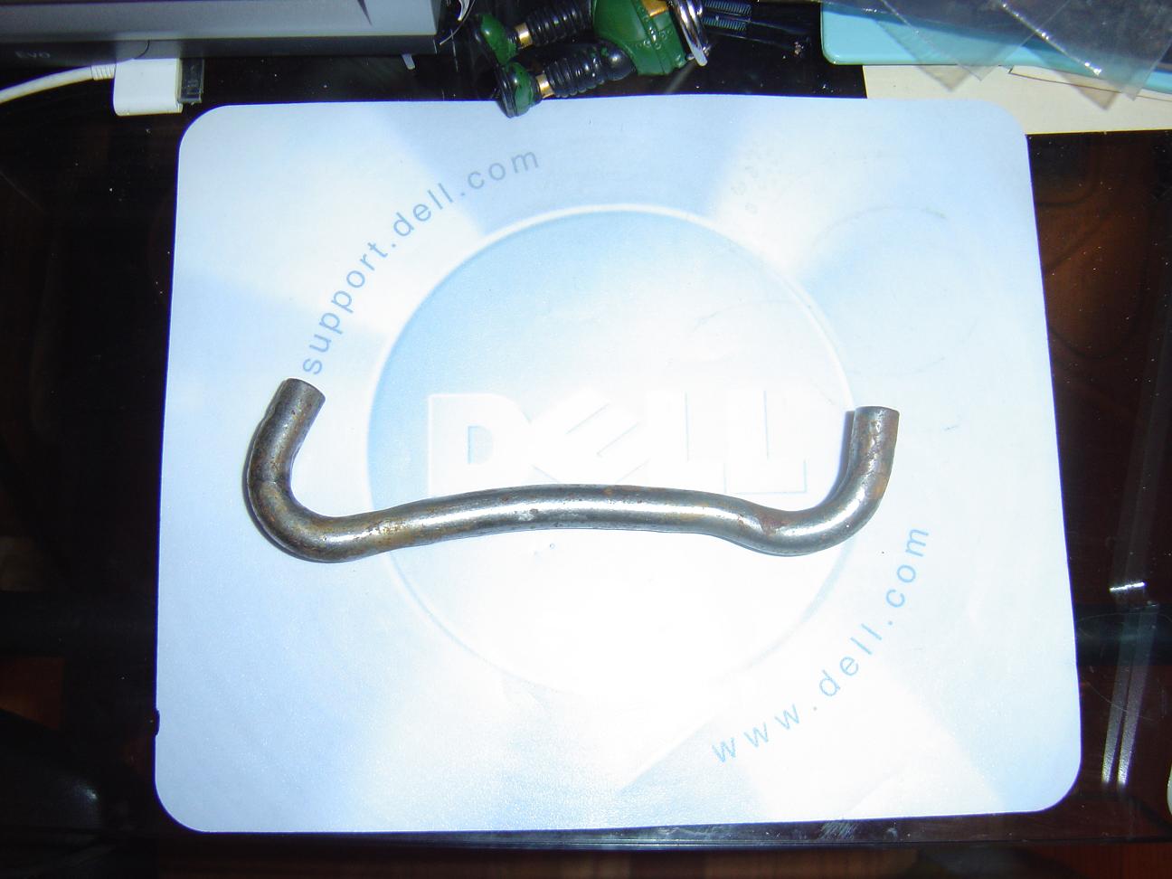

Hiya,
I have my buddy stopping by tomorrow so we can measure up the hubs to make a set of spacers. I have the wheels set wide and an I-Match. Without chains, no issues. However, I purchased a set of 4 link ladder chains and now they hit. (Well, they didn't hit, then they hit once. Now the chains are off and I have to repair one. lol)
We are going to make a set of 1" spacers and see how they work. After we measure them up, and finish them I'll post the drawings and pics. I'm a bit concerned that if we go to a 2" spacer the wheel may have too much leverage over the lugs and or the axle support bearing.
The pic with this post is what happens to the attaching hook when it hits the 3pt arm when plowing in high. I heard a "pop" and the tractor didn't slow a bit as it ripped the chain off.
Tom
