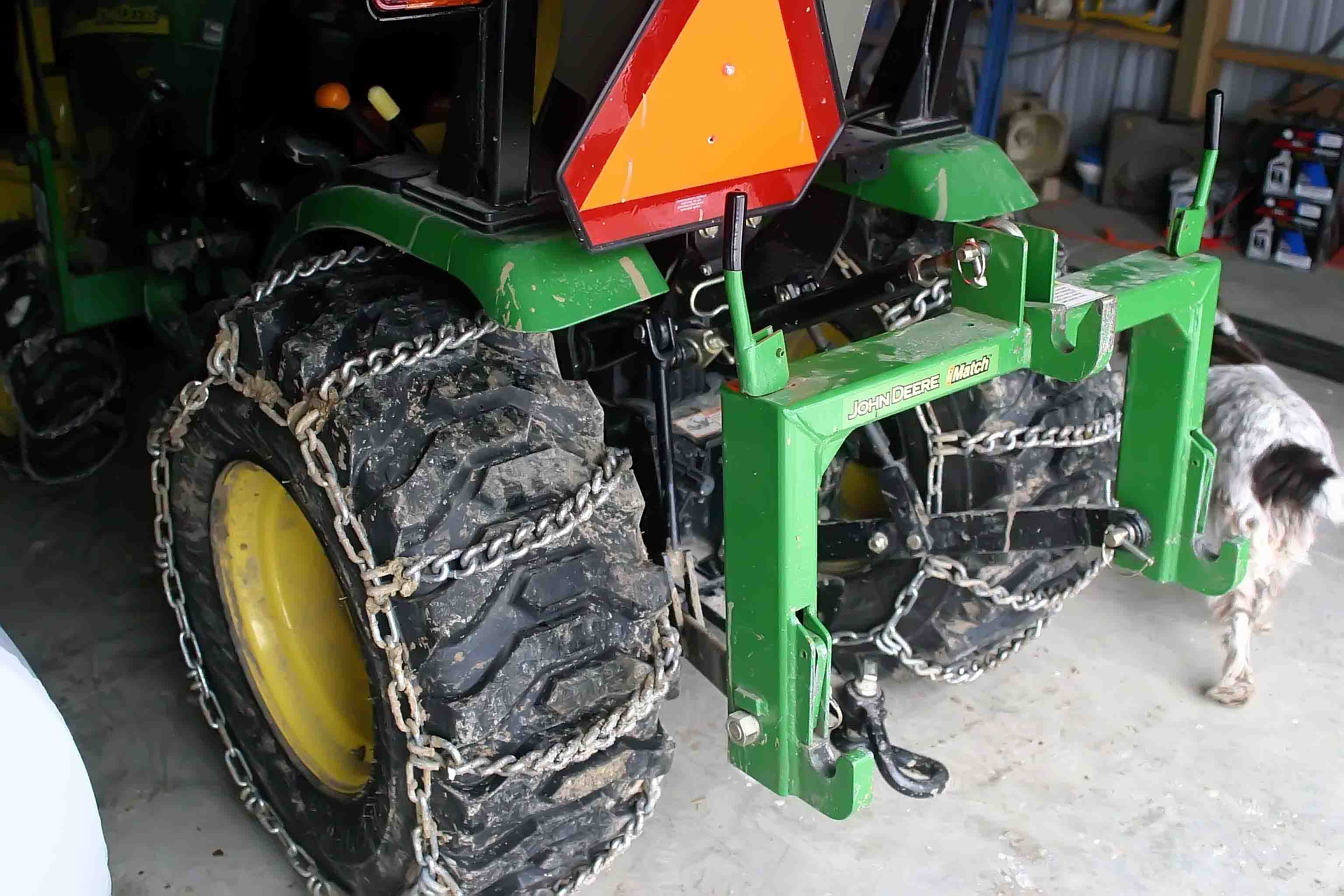

I just mounted the iMatch with arms on the inside, chains and everything else has no major clearance problems. The tires are still on "forward", chains dont hit the fenders, nor the arms. I guess until I read this post, I did not know anyone was having any problems with this. I had to get the JD tire spacers for the front tires, to put those chains on, but it was obvious that it was necessary, and JD already had all the parts to do it. Everything works great.

Hmmm, never looked at mounting the arms on the inside. I'll have to look into that. I really don't want the rear stance to be 6 inches wider, because there are already areas that I can't get into with the stock width. :eek:
   / Three point hitch clearance on a 2520 #24
Just curious if the chains need to be super tight so they don't hit the fenders if you go fast, or is there ample clearance if the chains swing twords the fenders?
Works good, eh? I see you used a pin instead of a bolt.. I couldn't get a 7/8" pin from my local tractor supply shop, but the 7/8" bolt seems to work excellent too, especially with the nylong lock nut. Plenty of clearance now for chains.

I just did like Mastertape did. Its amazing how easy it was.
Just go to your local parts store and get 2 of the longer cat 1 pins and bolt it right onto the I match where your current pin goes thru. Its so easy, I can't believe I never thought of it. It made at least 2 full inches clearance on eash side with the arms up!
