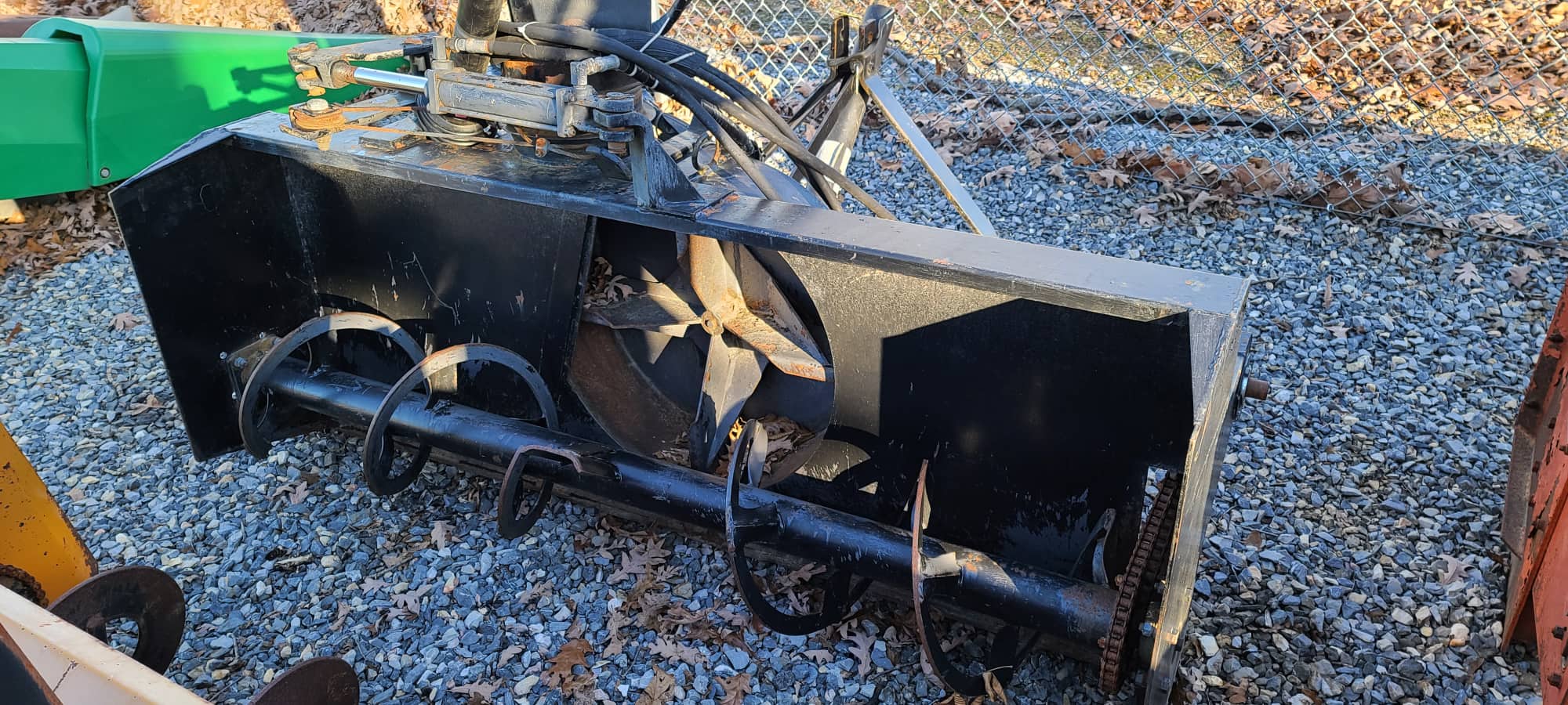

I'm looking to get a blower for my L45. I found this one a few hours from home. Anything stick out to anyone before I make the trek?

The pics show a little oil seepage at the shaft. Check that level is decent. If the shaft is wet it's possible its been run too low (unusual). Overall the machine looks like it's had an easy life. Little wear showing on impeller and auger. The chain is rusty but they are cheap and easy to replace. Hyd chute turner and deflector are nice to have - deflector is great when the snow needs to go somewhere specific.

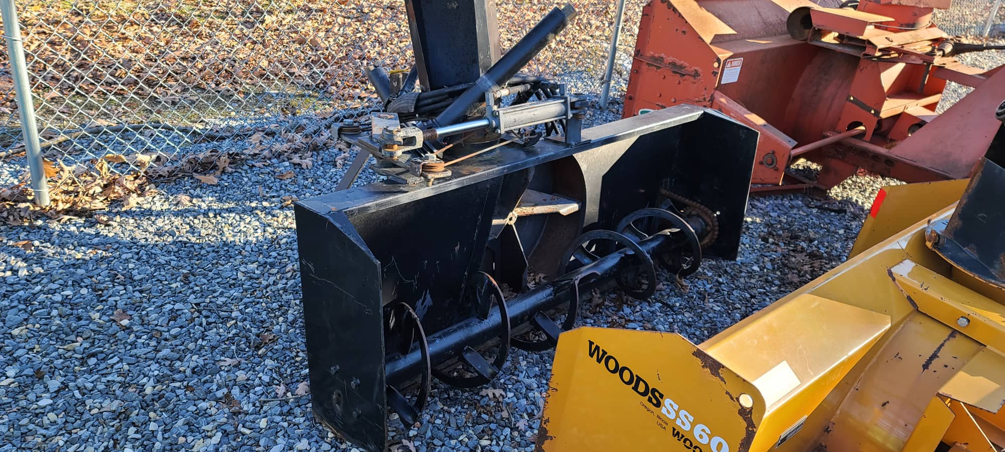

I used to have an AgroTrend a lot like that one (without the nice hydraulic chute). It was a great blower. The only thing that concerns me is the shaft for the auger drive is sticking out past the bearing quite a bit, it may be nothing but a loose coupling, but I'd want to check that out before spending $$. Other than that it looks like its in great shape.

All in all that looks to be in decent condition.
Nothing that routine maintenance won't bring up to snuff.
Chains, bearings and hose are minimal compared to buying a new blower.
That unit has 4 blade fan = good, wide fan = good and no fan damage.
Auger is in nice shape.
That blower had a nice life.

Can you tell me which picture you are referencing?
$1500
/ Thoughts/Opinions on a Used Blower #9
I'm referring to the shaft in picture 3 that is sticking out about an inch past the bearing that holds the end of the shaft that goes from the gearbox to the drive gear for the auger chain, normally they are flush with the end of the bearing. This is probably the coupling being improperly seated on the gearbox and the drive sprocket also being offset. Shouldn't be an issue for the dealer to fix before you pick it up.

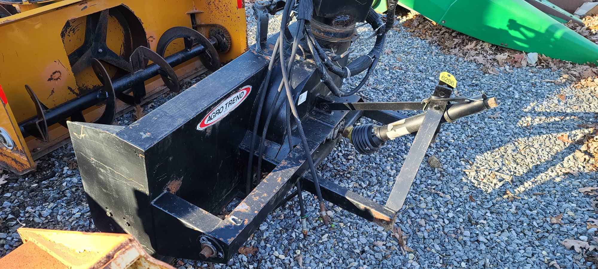

One question I do have is whether the chute rotator looks installed properly. I've never seen a setup like this with cables, but from the parts diagrams I can find it looks like the hydraulic cylinder maybe should have been along the back side instead of out front by the auger?

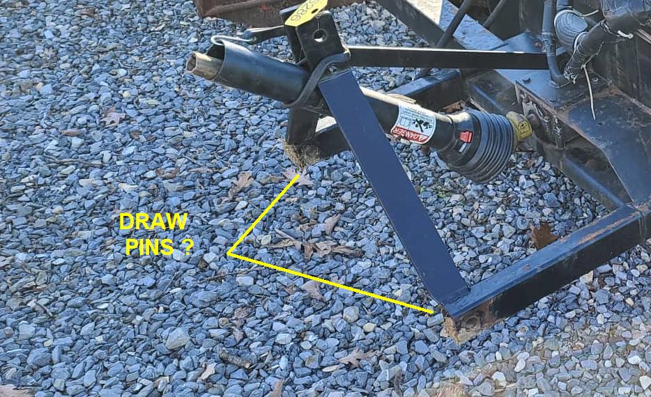

Geez maybe I can't see but where are the 3 point pins for picking up snow blower?
