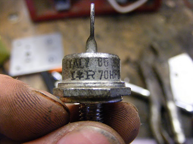

which part of the diode is the "stud"? Is it the threaded post or is it the little tab that the wire lead gets welded to?
Threaded post is stud.
If your diodes are all the same, you could replace them with the other kind. The pos. neg. output would be backwards, and you would have to reverse the capacitor(it should have a + or - on one end).
Look on the diode for the diode symbol. It looks like an arrow against a bar. I forget witch end is the cathode. You should be able too look it up.

I have found what appear to be replacement diodes for my welder. One question: when they refer to "stud cathode" or "stud anode," which part of the diode is the "stud"? Is it the threaded post or is it the little tab that the wire lead gets welded to?
I have read that you can find the anode and the cathode of a diode by seeing which way the meter shows open vs. short. Only problem is that, according to the site I read, not all meters put out their test current on the red lead, and you can't know for sure unless you have two multimeters and test one with the other (which, currently, I don't). So if I was to take a 12 volt battery and a light bulb and put it across the diode, would I be correct that, when the light bulb lit up, the positive lead is touching the anode?
Apply a positive voltage to the anode and hook one lead of the lamp to the cathode. Now hook the other lead of the lamp to the negative side of the battery. the lamp should light, you have conduction and current flow. IF you hook a positive voltage to the cathode and your lamp to the anode and the other lead of the lamp back to the negative voltage your lamp will not light, you will have no current flow. I believe the stud refers to the bolt portion of that type of diode. you would put it through a heatsink and screw a nut onto the bolt "stud"

Threaded post is stud. Look on the diode for the diode symbol.
Silly me. I thought that symbol was just indicating that this was a diode. Didn't occur to me that it would also indicate directionality, although I suppose that's obvious now that I think about it. If you had a mixed pile of diodes, you wouldn't want to have to pull your meter out every time to confirm their polarity.
In fact, here's a photo from that same thread showing the diode symbol in between the I and the R on the side of the diode. It seems to be indicating that the stud is the cathode.
It looks like replacing all the diodes is going to run me somewhere on the order of $40 plus shipping. If that fixes it, I will be in for under $200 on this welder, and still consider myself to have done all right, price-wise. And what price the knowledge all this troubleshooting has brought? Priceless!
I think you are agreeing with what I said earlier, with a whole lot of different words. When the positive lead of the battery goes to the anode, the bulb lights. When the positive lead of the battery goes to the cathode, no current flows. Right?
Correct.
