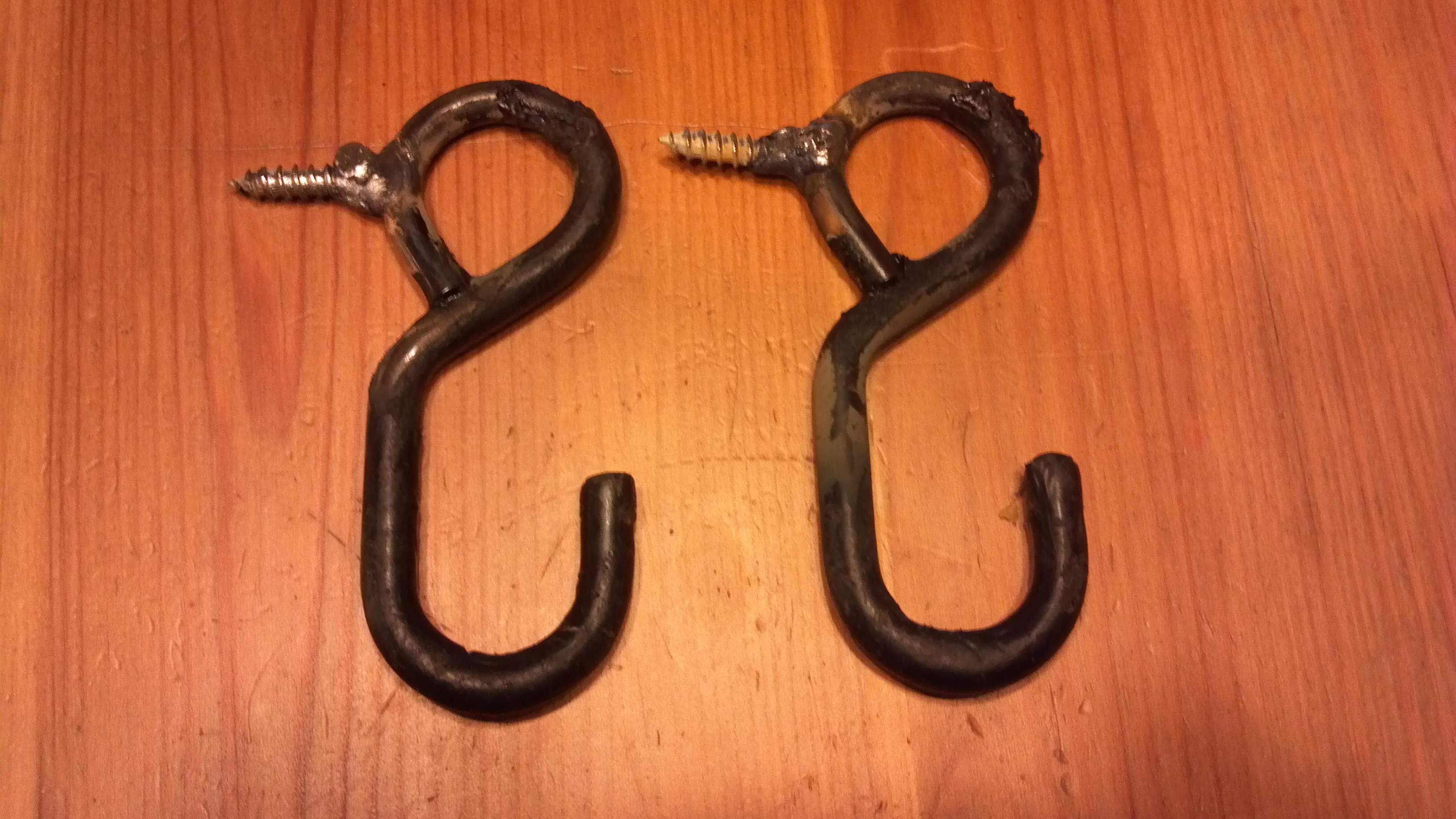

Well, I made something useful today!
I had some hooks from some ratchet straps that had to be retired, so I put some screw threads on them so they could screw into the wall and hang tools from and such.
Don't bother critiquing the welds. They are total crap and I know it. But I twisted and pulled on them and they didn't wiggle, so I think they'll do.
BTW: AC 1/8" E6011 at about 120-130 amps.
Hey it is a start, and you made something useful.. you should be proud... heck I am.:thumbsup:

I think I would have done better with a smaller-diameter rod and if I had removed all of the plastic from the hooks, instead of just the plastic where I was going to weld (for better grounding). I think with a smaller diameter rod, I could have kind of worked around the base of the screw a little. As it was, I just sort of globbed on from both sides.
