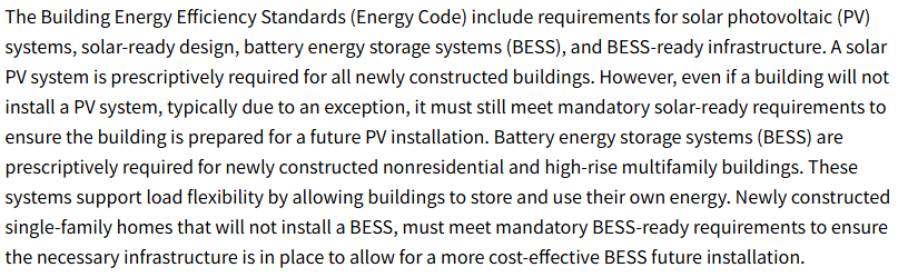

Are high capital investing by utilities serving the interests of customers across the state? No, it clearly isn't. Why do you think so many Californians have invested in solar and batteries at the household level? Econ 101. Now, one might make the argument that the utility lobbyists have the PUC in their pockets due to the actions of elected governors, but that is different from power generation and distribution
Or is it because since January 1, 2020 California required new construction to have a solar PV systems and now in some cases a battery energy storage system?
Solar PV, Solar Ready, Battery Energy Storage System (BESS) & BESS-Ready
The fine print on that was it was primarily for larger subdivisions, and not much of the roof top (250sqft, or about 5kW). So, yes, some solar, but not enough for those houses to be anywhere close to meeting their energy needs.

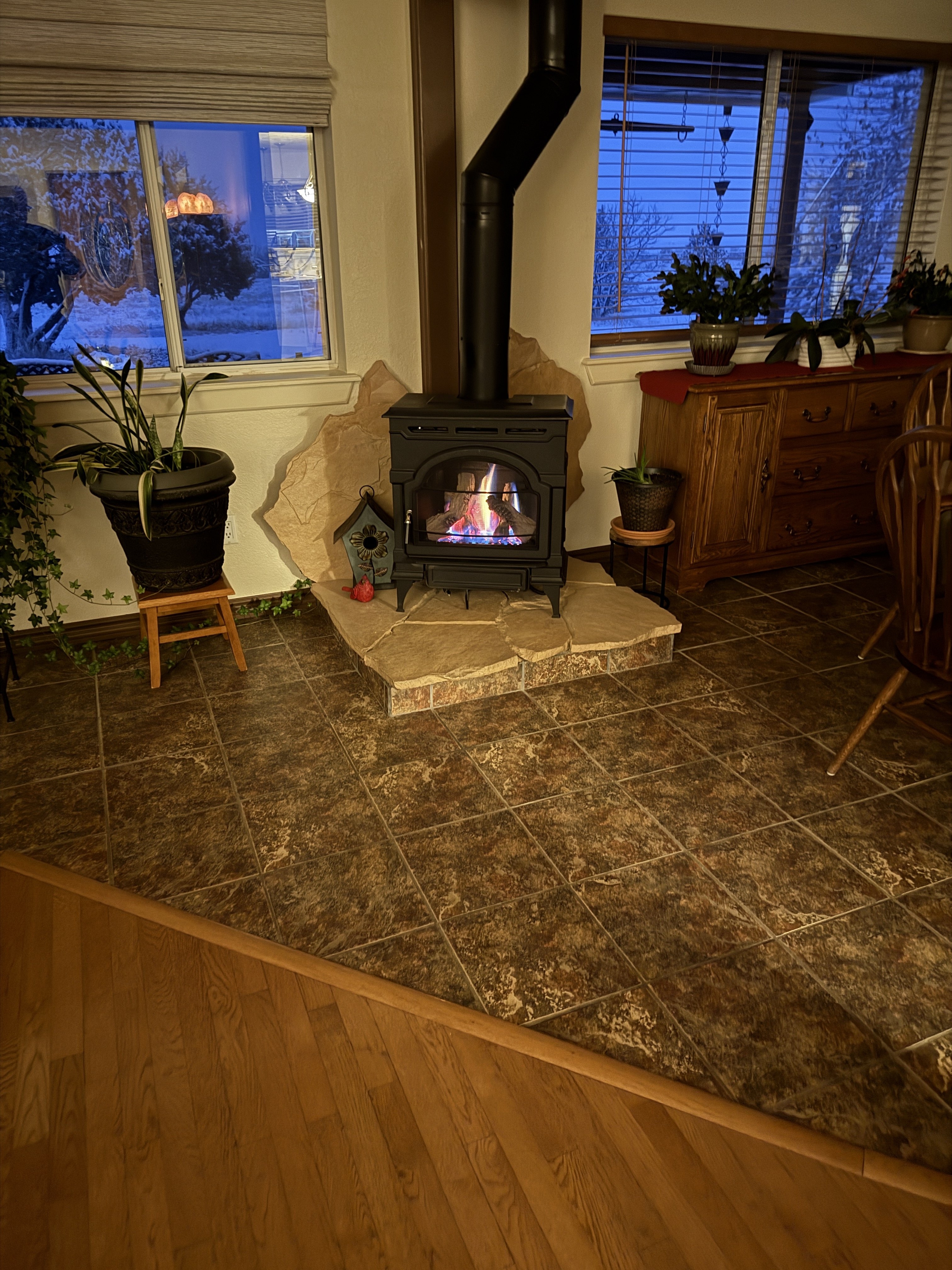

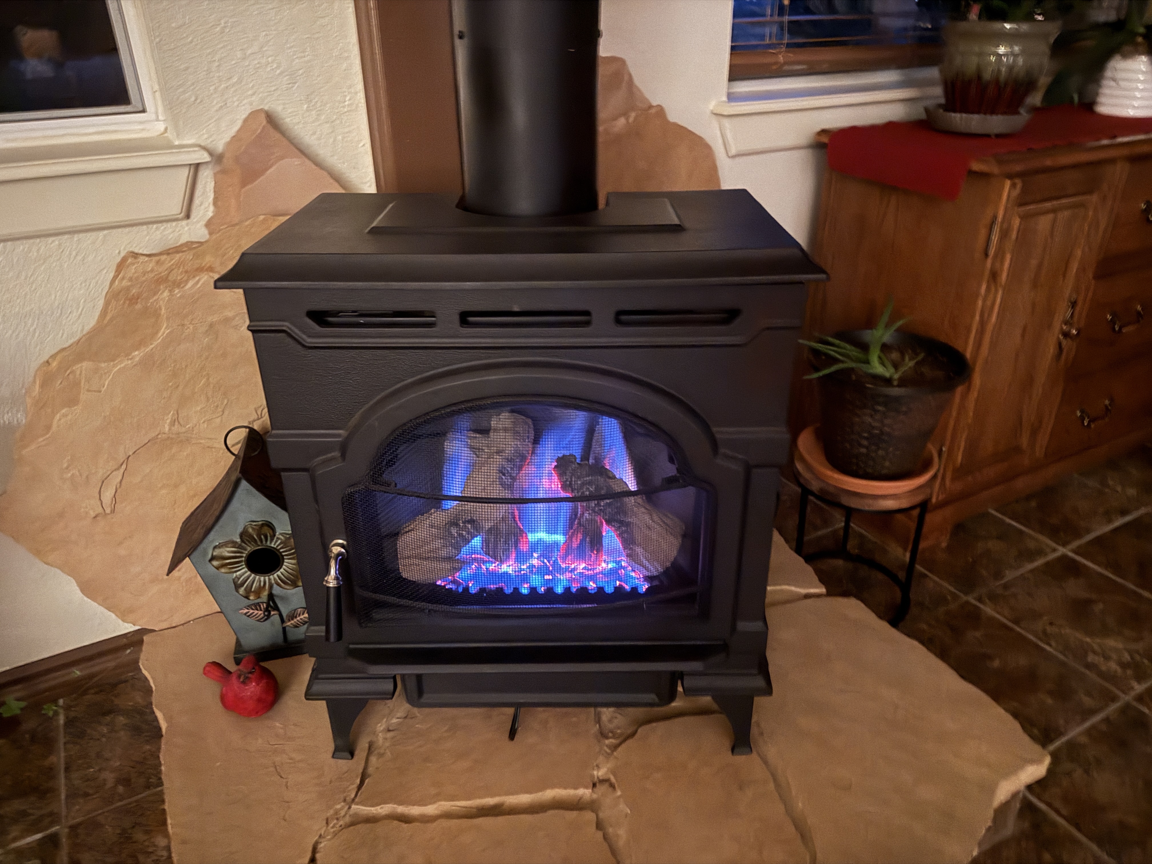

I'd consider solar at my new place and might look into it at some point. But I don't think I'd give up the LP gas stove, dryer and gas fireplaces. I like the diversity. The ventless gas fireplace has been my biggest surprise. I'm conventional and like burning wood, but I have to admit, the gas fireplace is super convenient and throws out a ton of heat with the simple click of a button and in really short order.
I agree. I burned wood for 30+ years, but when I converted from propane to natural gas, the wood stove was replaced by a gas stove. It heats well and is super convenient. My girlfriend kids me and calls it a lazy man’s stove. Guilty. I don’t miss cutting and splitting 4 cords every year.
View attachment 5016935View attachment 5016936
