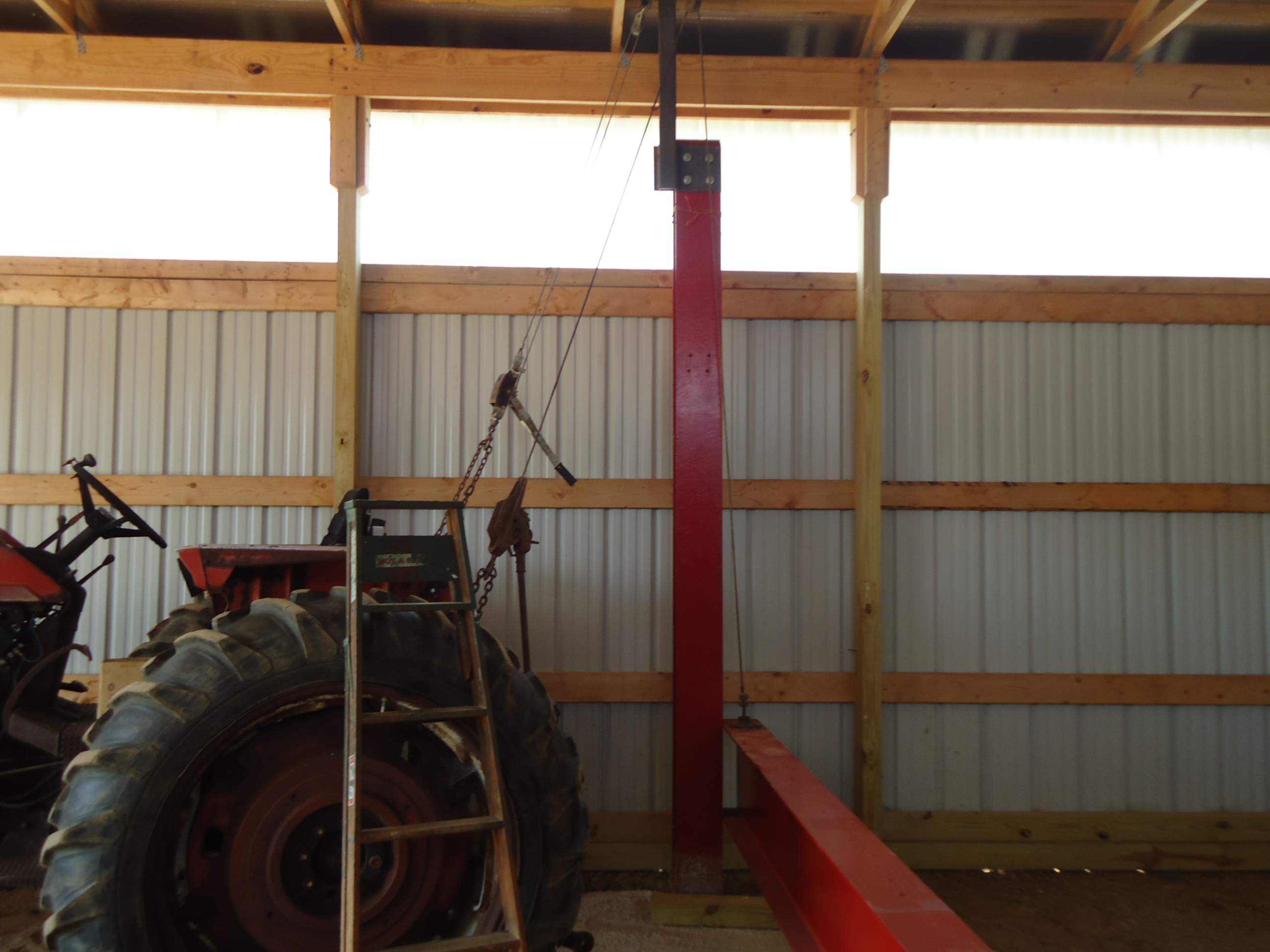

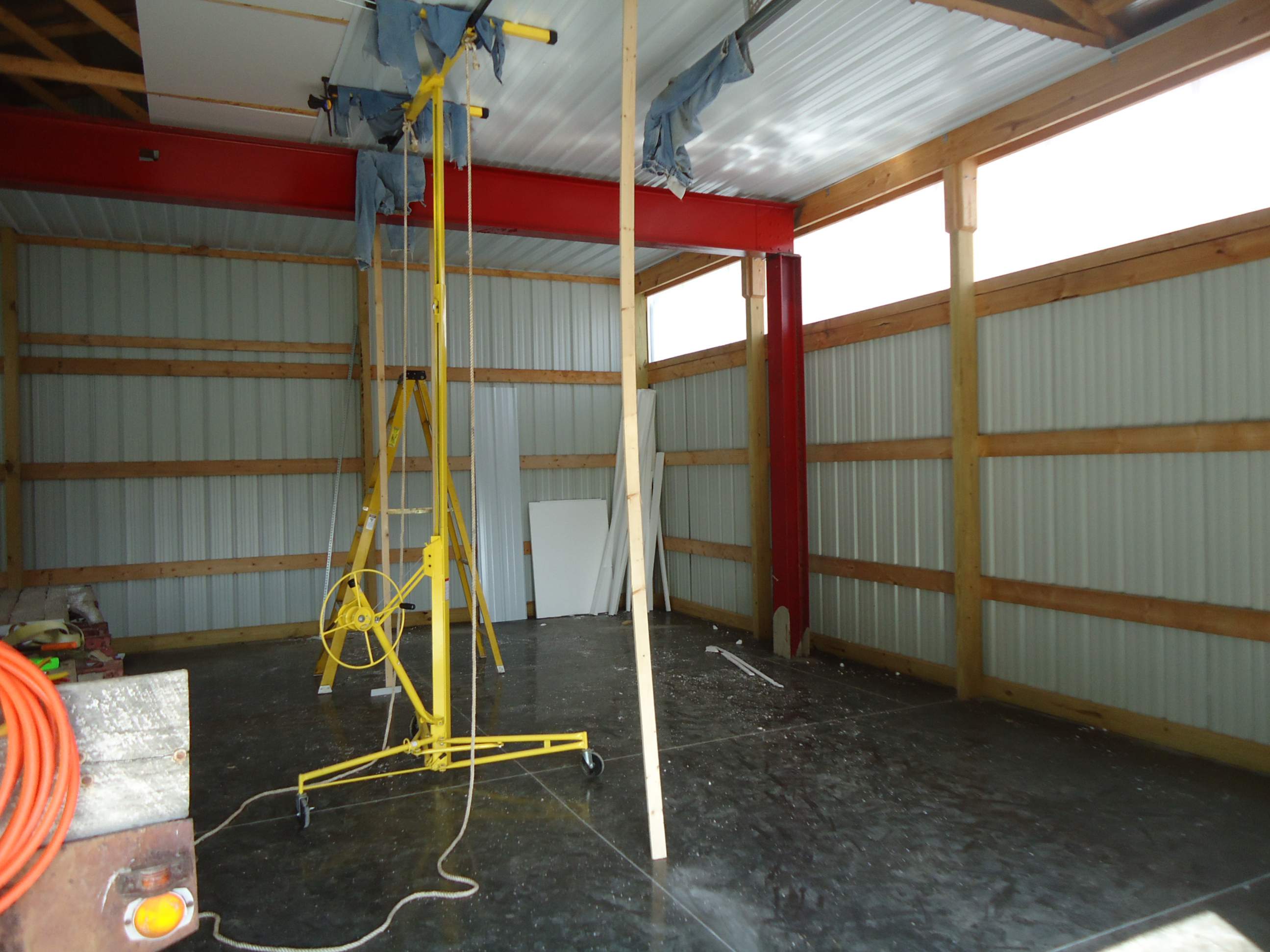

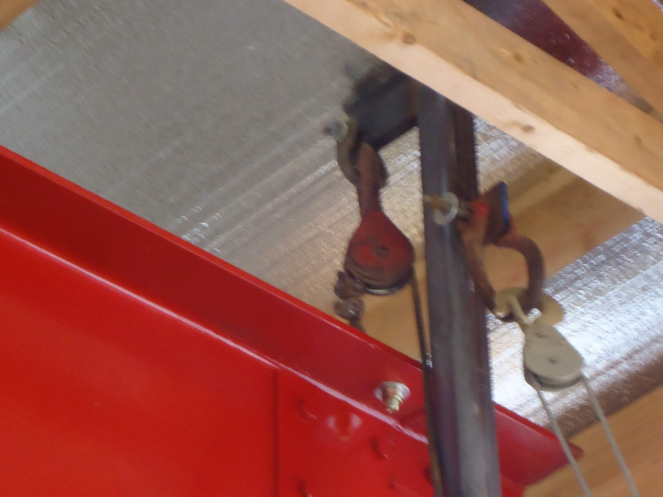

I put this 15" beam, with 8" H-Beam supports in my shop 4 years ago, but I anchored the uprights before pouring the floor. I had pins sticking up out of the anchor pour, to pin into the floor to make it even more stable.
Got the beams from a local guy that owns a demolition company. Got everything for under $300, basically scrap price. With steel prices down, it may pay to shop around.
Just made some short jibs, and used a couple of 2 ton come-a-longs w/snatch blocks to pull it up, anchored to a couple tractors. I put this up by myself. Once I got everything situated, and hooked up, it took 45 minutes from the ground, to on top of the uprights. Just a few notches at a time, back and forth.

Nice looking setup. You ever assign a safe WLL to that setup? How far are you spanning?

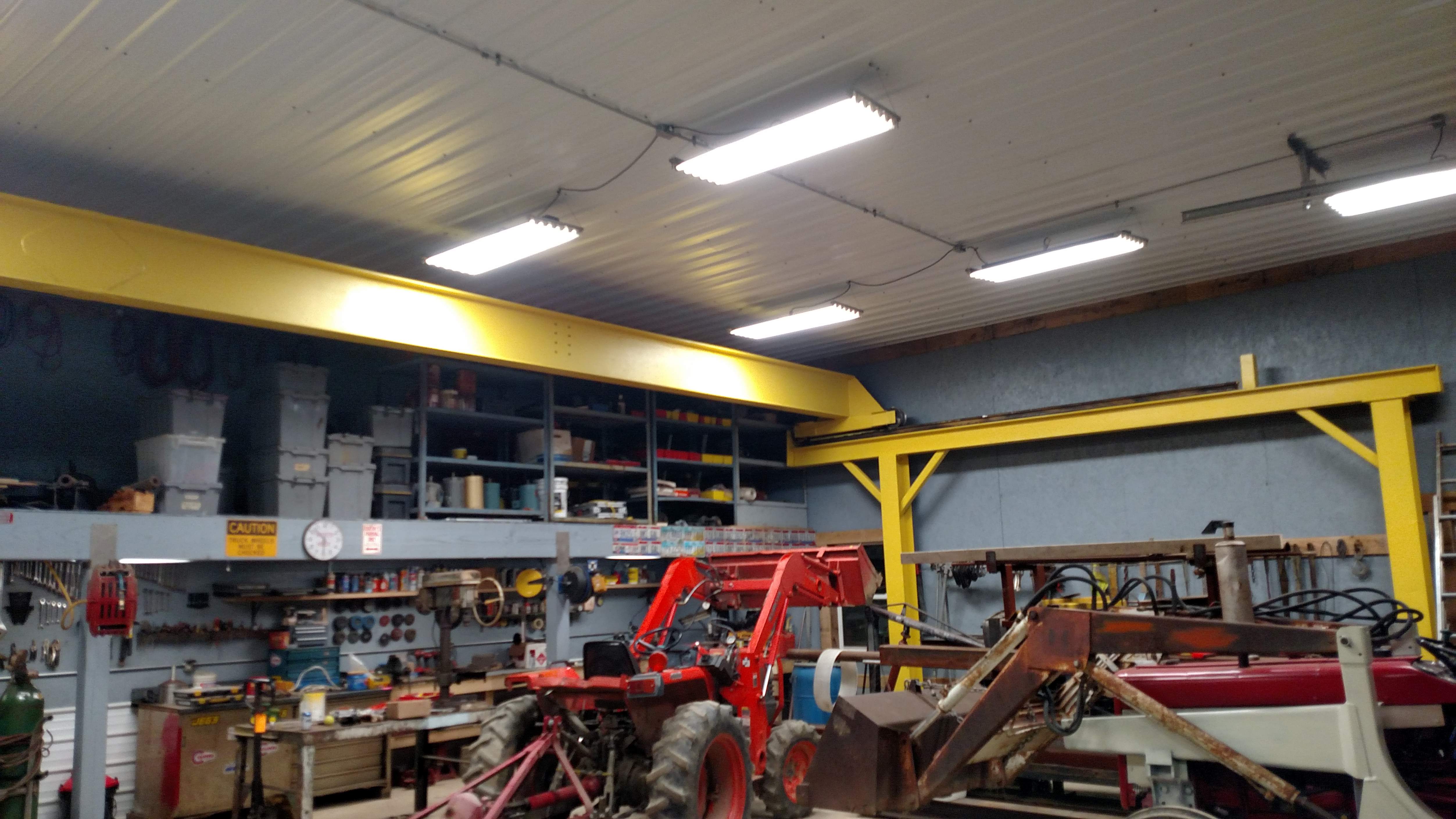

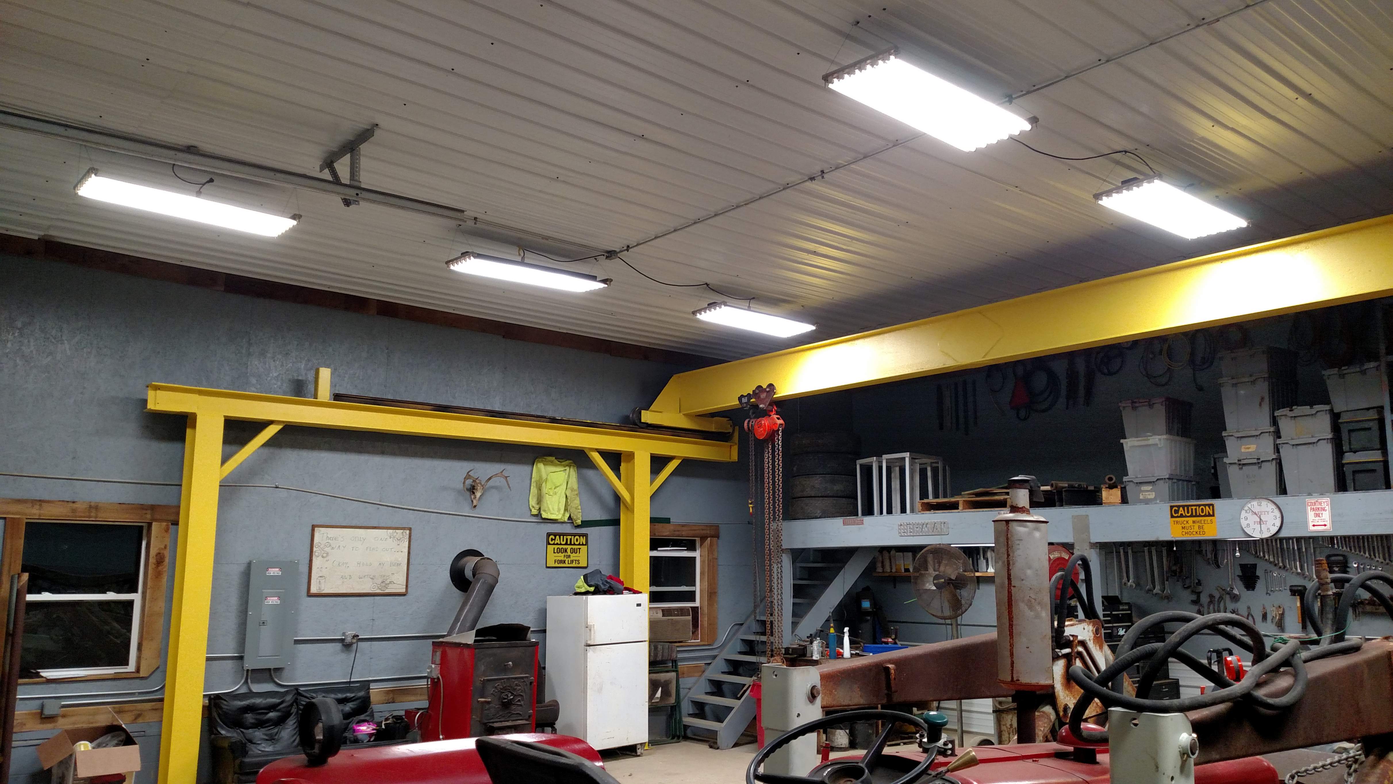

Gotta love cheap used steel. I bought:
(2) 25' sections of W18x60
(4) ~ 15' sections of W10x33
(1) ~18' length of W8x24
(1) ~25' length of W8x31
All that for ~$500-$600. Cant remember exactly.
It turned into this:

Now that is a great shop!!

No, I didn't. A couple of guys calculated it, but, can't remember the numbers at the moment. But, it is way more than I'll ever have hanging from it. Span is just short of 30'. Can't remember the pounds per foot, but it's 1/2" web & flange.
A buddy ranted on, for putting up such a big beam.. He asked what I was going to pick on it. I told him, what ever I want... Then proceeds to tell me the loads a buddy of his picks on hay trolley track, attached to wooden beams in an old bank barn, fastened up with drywall screws. Scares me, just to think about that..!!
At the other place, I had 3 hoists on trolleys, mainly for when tearing a tractor down. Just pull it longways with the beam. My smaller tractors can be in 4 pieces, with 3 of those pieces hanging if need be. I left two hoists & trolleys there. Thought I'd splurge, and get new trolleys for here. I've got several nice, older hoists I picked up at auctions, etc.

THe 15" beam is throwing me for a loop. IT looks in the pics like a wide flange beam, but those skip 15". Can be had in either 14" or 16".
S-type beams (typically slightly weaker per pound due to smaller flanges) do come in a 15" variety. S-type have tapered flanges on the inside, similar to channel iron. So the flange thickness is thinnest at the edges and gets thicker towards the middle.
S-type could be a S15 x 42.9......5.5" wide, .622 flange thickness on average, and .411 web thickness. Or could be a S15x50, 5.640" wide, also .622 flange thickness, and .551 web.
Depending on which of those two beams, 4800-5200# would be the approximate capacity on a 30' span.
