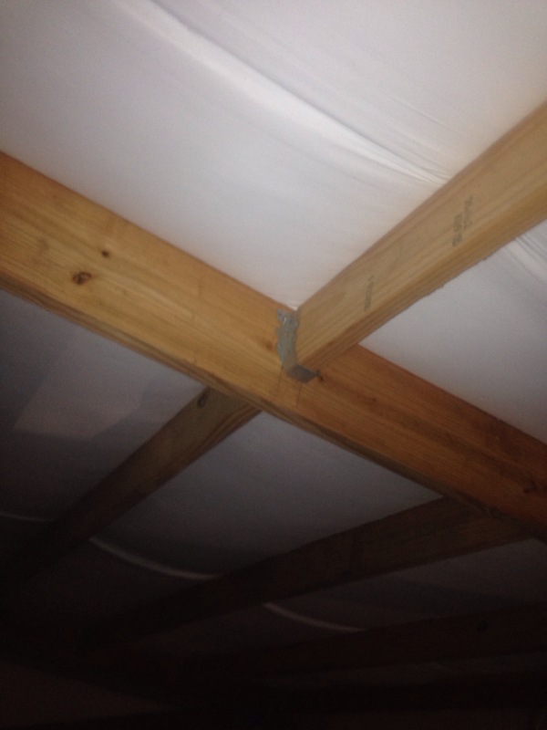

I purchased a northern tool hoist, thinking it would be pretty easy to install. I am not looking at lifting anything very heavy. This is primarily to lift my roof top tent from my trailer to the top of my jeep and back when needed.
The problem is I have only the ceiling joists. The rule of thumb (from researching) is NEVER drill a hole in any ceiling joist, it weakens the structure, Obviously, I don't want to do that. I picked up 3/4 inch plumbing pipe to have it cross the top of the joists, then attach the hoist to that? Thoughts. I am thinking to even out the load across joists. I can pick up some more pipe to make it cross 4 joists for the load.
Some pics.....hoist, barn joist. I have had electrical outlets already installed in all 4 corners of the ceiling in the barn..........thanks for the help and suggestions.

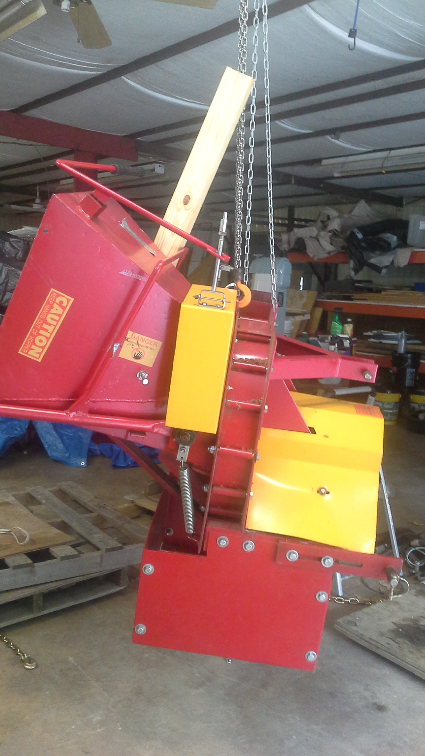

I've been planning on a similar hoist to lift things like my chipper

What I'll probably do is find a 15 foot I beam of sufficient strength and mount it on a pair of lally columns/jack posts I have. I'll attach the columns to uprights that are supporting the roof and beams in the roof to prevent movement.

Don't give up on hanging a load from the trusses.
Looks like a new shop and the company that sold you the trusses should be able to tell you what they can support and where.
I've built a shop with wood trusses that were engineered to support tracks for a crane rated at 2 tons. The tracks had to be lag bolted to each truss the length of the shop.
It was all engineered by the truss company in about 5 minutes time, specs printed out and came with the certifications stapled to the trusses when they were delivered. I was also given a point load diagram giving the connection points on the trusses.
Engineer told me that it didn't change the design at all for the 36' span and I could have quadrupled the capacity by simply going to a 2x6 bottom chord.
Point is, those trusses are very strong, and sometimes getting the design work done is free. Can't hurt to ask.
