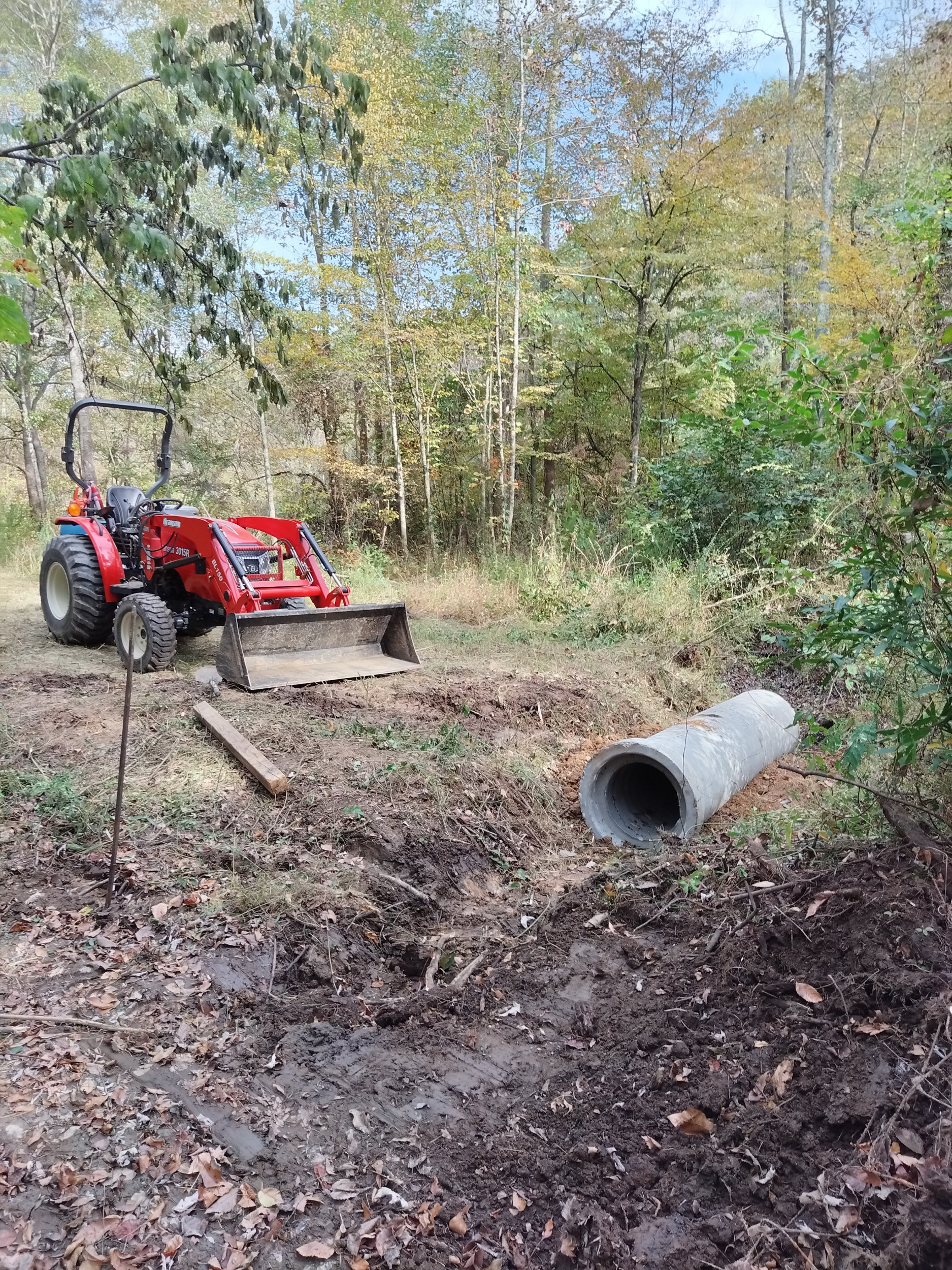

When I bought my property 5 years ago it became very obvious if I wanted to reach the other side of my pond I was going to need to make a bridge or culvert over the ditch that feeds the pond. For 8 months out of the year (12 in wet years) navigating the swamp to cross this small ditch is difficult at best. I have been across it twice, both in rented machines and both times were almost a disaster. The ditch is not deep, but deep enough and often times full of water. It was time to do it right!

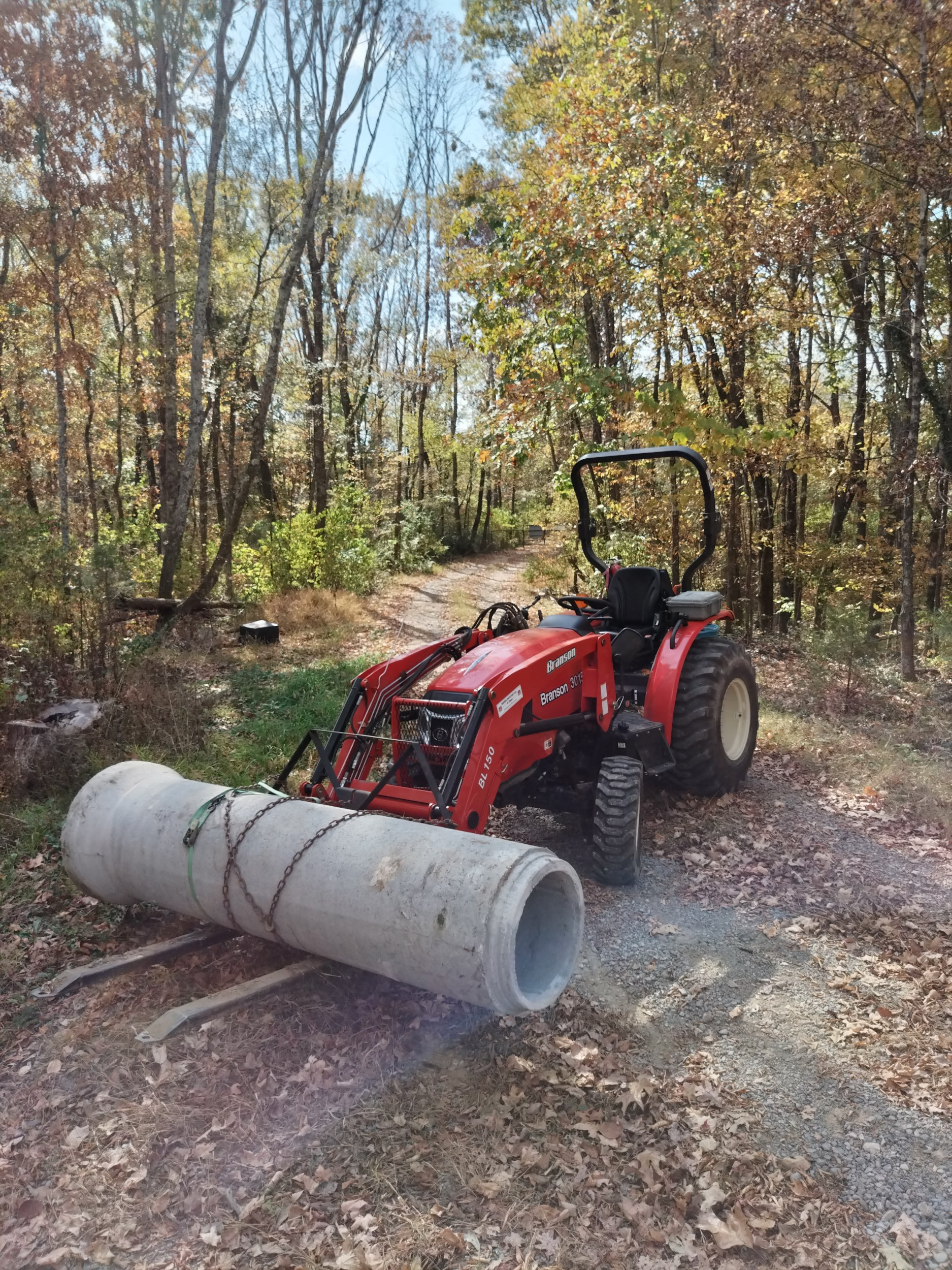

I had originally thought about making a bridge out of free I-beams I got from a friend, but then got my hands on a cheap 18" reinforced concrete pipe ($100). It seemed to me that dropping a pipe in a hole and coving it with dirt would be easier. The culvert location is 1/3 of a mile from the barn down a steep hill and along a trail. Bobby Branson handled the pipe shuttle no problemo. I am estimating this pipe to be in the 1800 lb range (I could be wrong though).
My dirt pile was also up near the barn. So I had to shuttle the dirt from this location down to the culvert 1 bucket at a time. Took about 8 trips. The culvert is not completely finished yet. Plan on putting a concrete apron on the front of it which will allow me to backfill right to the edge of the front, and keep the dirt from washing out around the pipe. But honestly water coming through here is not moving with tons of energy so I am not worried about it getting washed out.
Sorry, having issues upload pictures of the final product, but I am sure you can imagine what it looks like. Excited to gain easy access to that side of the pond. Not much over there yet (due to limited access). I have plans on renting a mini ex and cleaning up that side and cutting a road into the hillside, eventually putting in another access up the draw to the top of the ridge.
Feels good to FINALLY get this project done.

Looks great, would love to see the finished pictures. A headwall is an important addition. You can pour it in concrete by placing a sheet of plywood flat against the pipe end and pouring behind it. Insert a piece or 2 of rebar to keep it in place when it cracks.

Finally sorted out my download issue. Here is the almost finished culvert. It works great. Need to get that headwall poured so I can add a bit more dirt and level things out. And finish is it off with a little gravel.

Add some rip rap to the uphill side and you can call it completed.
I am planning on making a concrete headwall along the front of that pipe. But I guess the rest of that opening would benefit from some rip rap too, wouldn't it? Thanks for the suggestion.
/ Culvert Install #14
I see no need for a headwall. The water is going to go over the roadway before it fills the culvert. If you had an elevated roadway that would pool water above the culvert during flood stage until the culvert can catch up then a headwall is beneficial.
In your case I prefer the roadway to be slightly lower than the roadway on top of the culvert. If the culvert can't keep up and overflows the roadway you don't want it going over at the culvert. You want it to disperse in a wide area to either side of the culvert, or both sides. That keeps a flood situation from washing out your culvert. Easier to repair a section of roadway than reset the culvert.

Thanks for that info. makes total sense.
I think I am still going to do a headwall, it will allow me to fill right up to the edge of the front which will give me more room to fill and grade it how I want it. Culvert is only about 7' wide, so I will take all I can get. I have the concrete already and it will not be difficult.

Installing a dip in the road adjacent to the culvert fill as you suggest is a common practice on forest roads and it works pretty well, especially if the dip is armored with rock.
