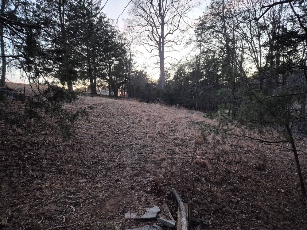

There are places on my land like a pasture that's not all that steep, but an area maybe 300ft long that drops 2ft then continues. So bush hogging I go straight downhill then if I don't lift deck it scalps. I'm thinking about tiller I could work that area then level with rear blade so pasture would all be even (15°-20° slope). Of course, seed area.
Picture is area I'd like level. I held camera level and I'd leave those large poplars but remove cedars beyond, now they're 6" at base.

I'm thinking with the 7ft backblade I wouldn't need a box blade. I know it doesn't have rippers but it's super heavy duty and adjustable every direction and hydraulic top link. For my purposes wouldn't a tiller be more useful? I could till high spots, then grade it smooth.
I tried bucket, then toothed bucket, etc. and it doesn't work well.

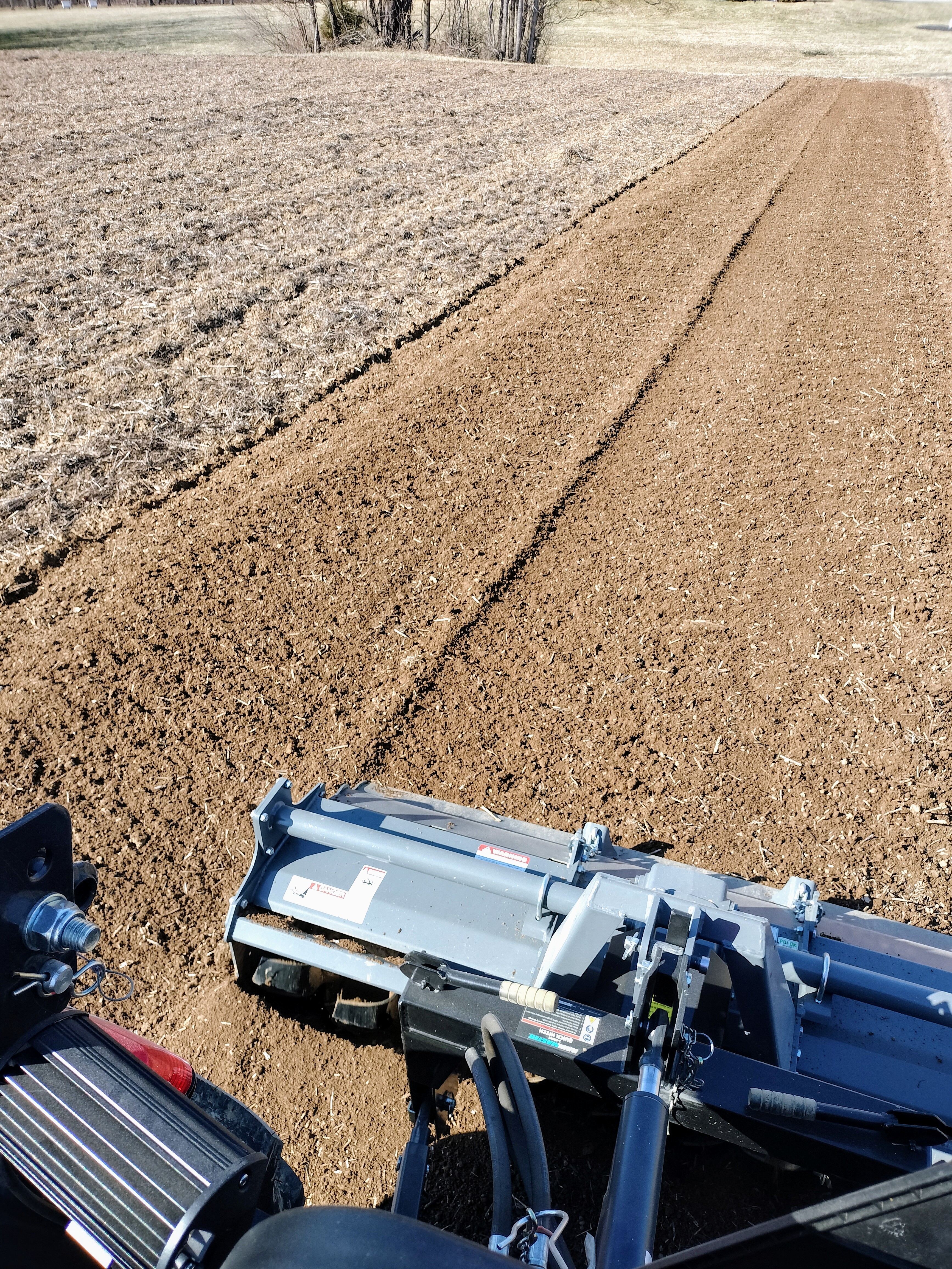

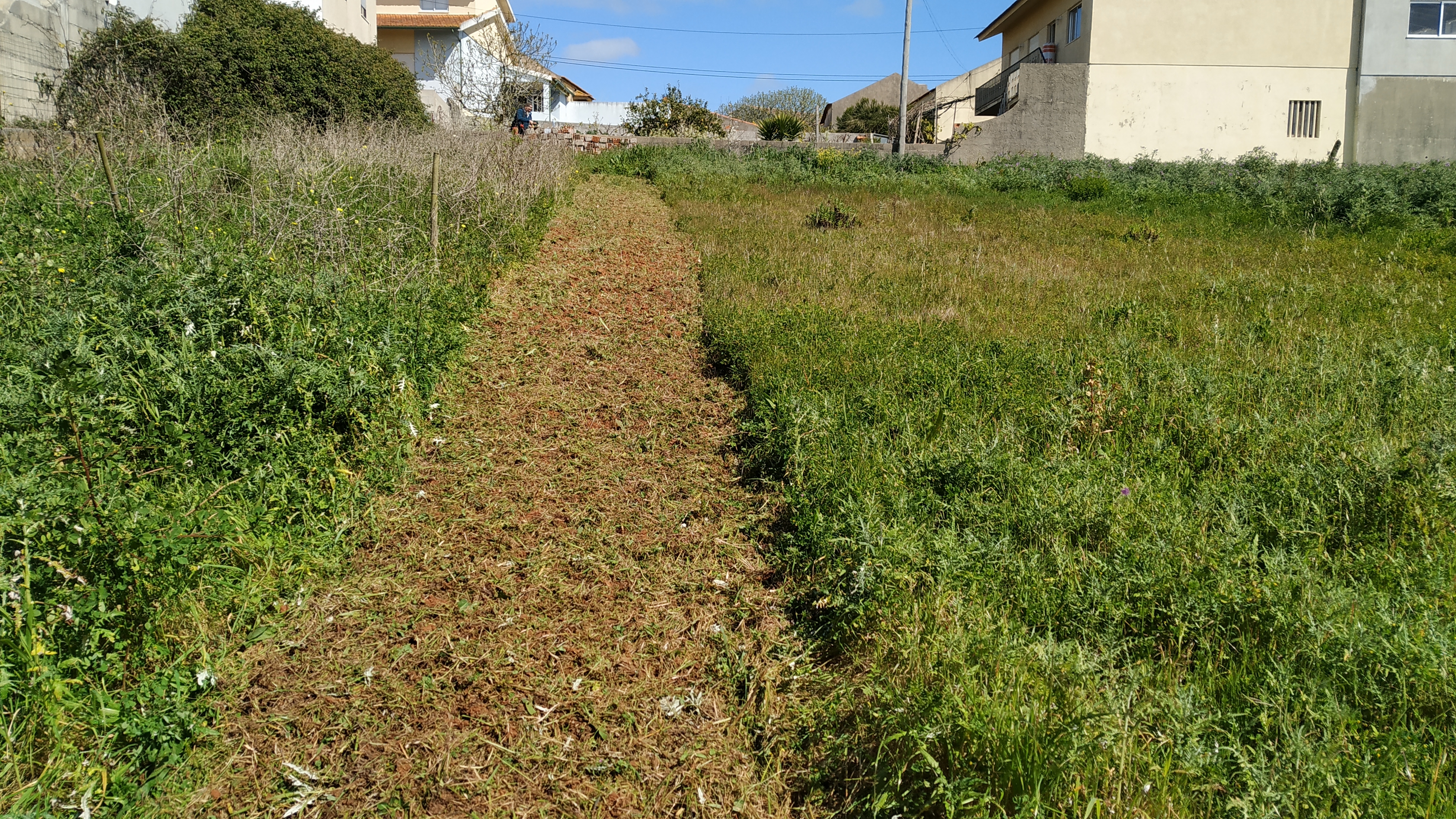

As long as there are no hidden stumps or anything like that, I would just run the tiller on it. Run it up and down so you don't risk flipping your tractor.
Here is a job I did some time ago. Didn't bother with mowing at all. Tallest brush and grass was about 2 ft high. This was the first pass, looking from the bottom of the land up:
And the end result, after 2 passes on the entire land looking from the top:
